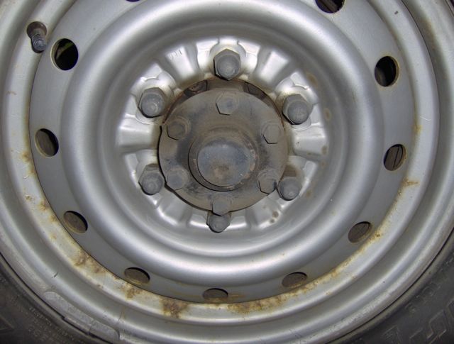

My bus doesn't have a wheel lock lamp either. I have manual hubs now, but it came with permanently locked flanges. Does yours look like this?

They look very similar!
So I could assume that my front hubs are always locked. If so, procedurally, i should be able to go in and out of 2 & 4h provided I'm going a reasonable speed? Is it still prudent to be stopped and in neutral to switch into (and out of) 4l?

Your hubs are always locked. You can switch from 2high to 4 high while driving as long as you are going in a straight line and on a slippy surface (gravel, snow, ice). To go in and out of 4 low you must stop and put the bus in neutral before shifting the transfer case into and out of 4 low. You could get some manual lockers./ You won;t save heaps in fuel, but you do have the option of using 4 low on a sticky surface - I use it for backing a trailer up my steep and curvy driveway.
