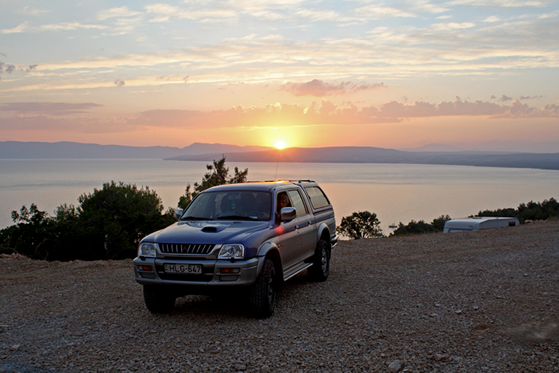

Do you have an intercooler yet?
I'm just planning it, but i have doubts.. because i drowe a Mitsu Strada for two weeks in my holiday and my '95 deli has far more torque on lower rpms. The only difference is the intercooler the pickup has got the same engine with 98hp.
i don't know.. maybe my engine is in better condition.
