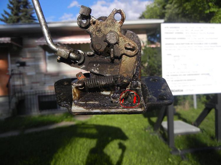

So last night I took the latching mechanism apart, the problem must have been that there was too much gunk and debris in the latching mechanism, which caused too much friction for the tooth that hooks into the latch loop to operate properly. It all works fine now.

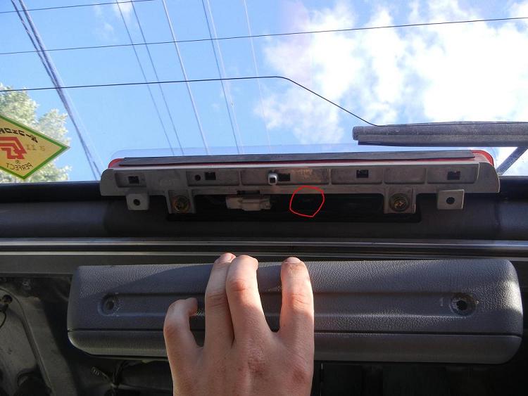

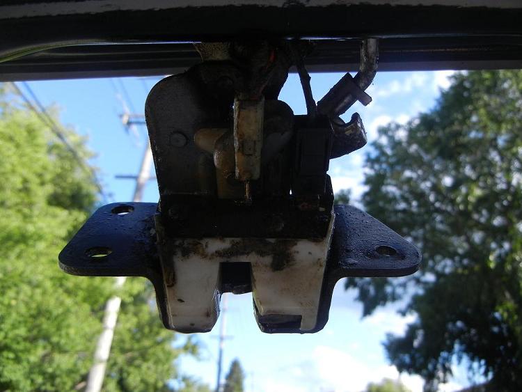

Alright, so I've been real busy at work and my home computer was having some problems, so I am finally posting my pictures and instructions for taking apart the door latch. The door latch is attached to the vehicle in several places, all of which will need removing.
1. Three machine screws on the bottom (obvious).
2. Plastic rod clips: There are two rods coming up from the latch. The longer one locks the door and the shorter one opens it. Mark the location of the plastic clips on the rod with tape or a marker and use a small screwdriver to unclip them.

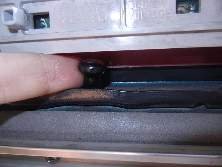

3. Knob at the top. Remove the cover for the brake light in the back window, inside is one of those 'door lock knobs' unscrew it with your fingers.
4. Wiring: two wires go down to the door latch, they should come off easily. It you wait to do this step until all else is off it will be much easier.
If you can get it all the way out, I'm assuming you'll be able to put it back. Good luck and let me know if you have any questions or I don't make sense.

- Machine screw locations and wires (circled) once latch was removed.
- DSCN0633b.JPG (65.32 KiB) Viewed 6598 times

- Door lock knob.
- DSCN0639.JPG (60.96 KiB) Viewed 6598 times
- Light cover removed with door lock knob circled. The plastic rivets holding will probably need to be broken but any parts store will sell ones that fit.
- DSCN0640.JPG (60.3 KiB) Viewed 6598 times
- Latch hanging from door. it comes out this far after the rod clips have been taken off.
- DSCN0636.JPG (64.4 KiB) Viewed 6598 times
- Latch removed. The part circled was causing the problem. I got my screw driver on either side and wiggled it around while spraying it with WD-40.
- DSCN0634.JPG (71.87 KiB) Viewed 6598 times
