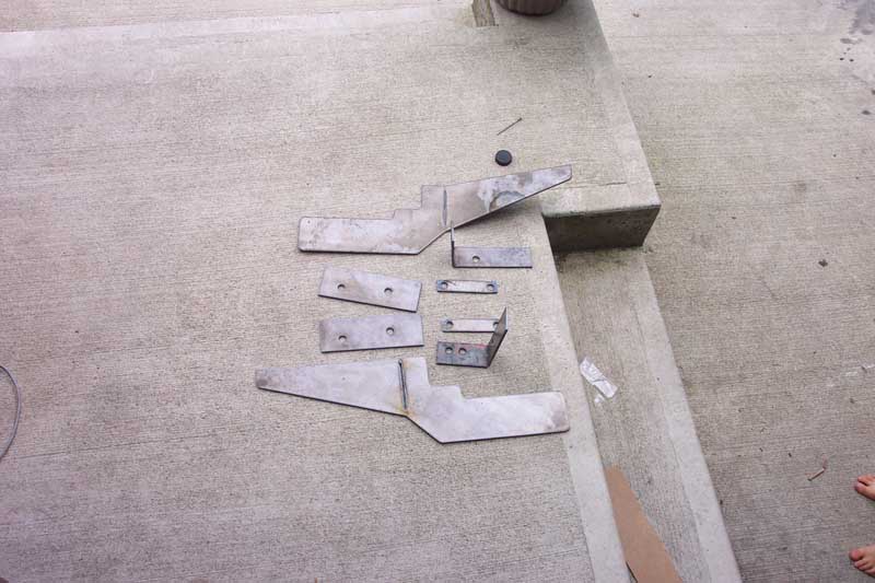

First project that I have completely finished on the truck.
Started from cardboard then drew the peices on the computer, I happen to have the luxury of a CNC plasma cutter in my garage so down there I go and make this.

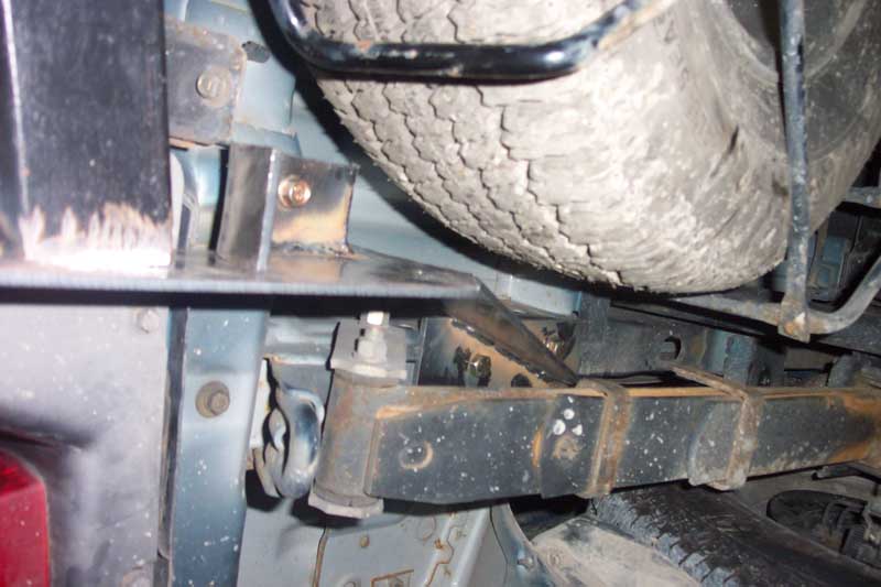

Bolt the bits into place and welded them up. The hitch part I stole from something else just for lack of effort. Brackets mount to the rear "bumper" mount holes plus I have a supporting plate inside the frame for the other 2 holes to mount.
install area.jpg (79.09 KiB) Viewed 11092 times

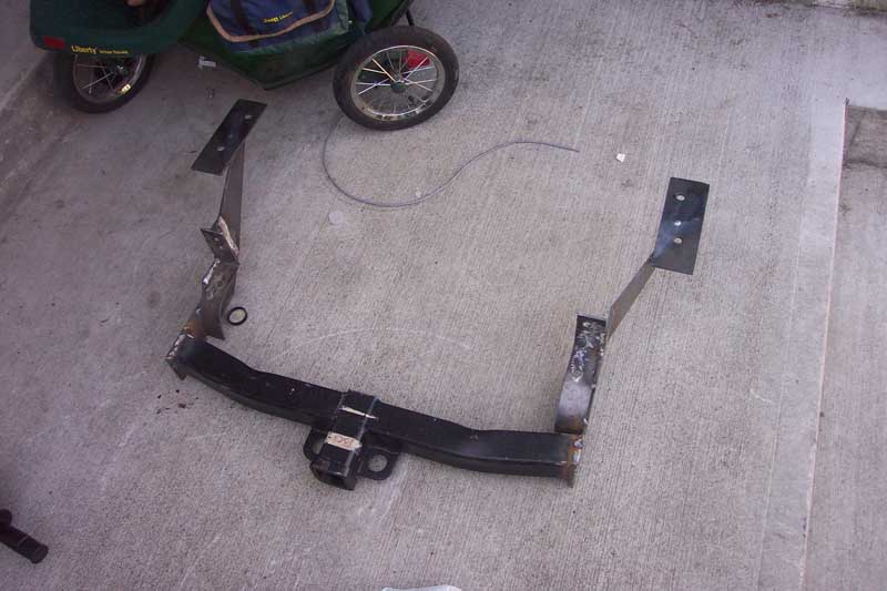

And here is the finished product "before triming the extra off the end and painting".

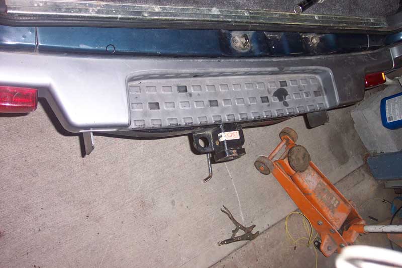

Installed
hitch installed.jpg (81.93 KiB) Viewed 11090 times

Nice work. Does the design allow you to keep your original bumper?

If by "bumper" you mean that little white tube, then I don't know, never looked. It could very easily be welded onto the hitch I suspect. Maybe I will look into that tomorrow. Kind of low on the priority list now that I have $500 in aluminum sheet waiting to be carved into fuel tanks.
Spare tire stays though.
