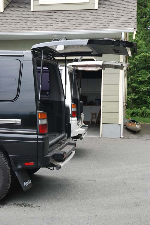

Some one has posted somewhere a tailgate mod of swapping the struts left/right. This raises the tailgate quite significantly. On mine it opened to 5'9" before, 6'3.5" after.
Although it can be done for free, when we did Green1's Delica a couple of weeks ago, he sheared off one bolt when re-installing, and almost sheared off another. Both were bottom bolts, so obviously there is a huge shear-strain on them.
Learning from someone else's mistake is always less painful, so I figured I'd get replacement bolts before doing mine. Took way too much work to get stainless steel bolts (6mm x 12 mm), lock washers and flat washers. But today we did the mod on mine, then swapped the bolts on Green1's. The geometry on the struts is amazing in that the swap from side to side raises the lower pivot point by about one inch, but that gives a 6.5 inch increase in how high the tailgate opens.
No more bashed heads! (until I get a ladder and the struts aren't strong enough)

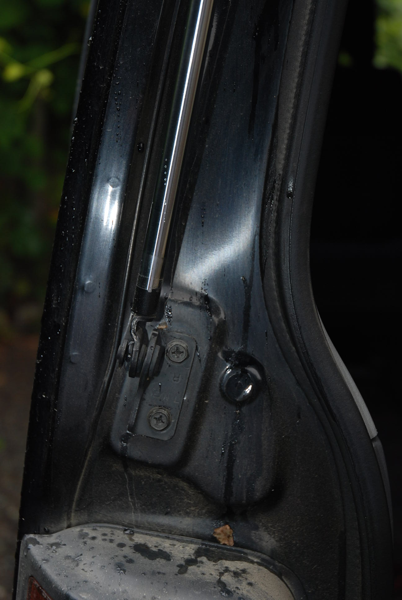

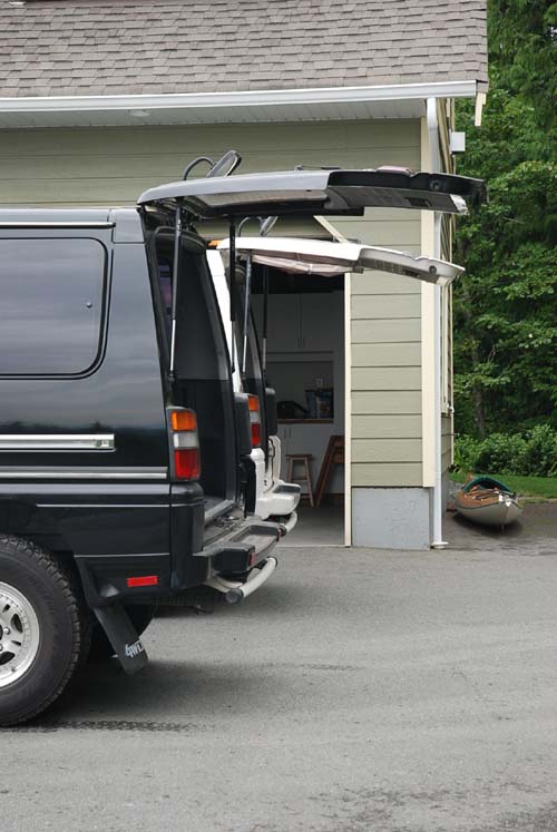

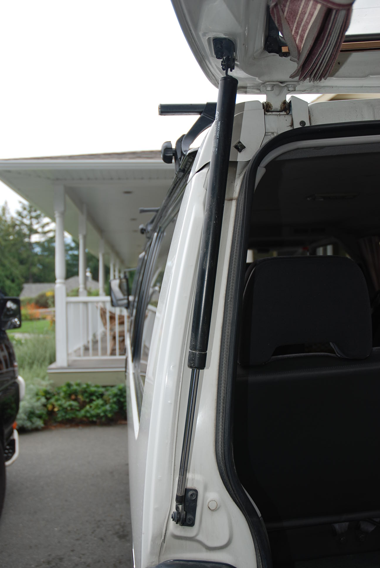

As it turns out I still didn't get it! I do now though thanks to warmland89. Here is the key that I had missed from previous posts. When you swap the left for the right you have to flip and swivel the bottom mount 180 degrees so that you get the pivot point at the top like was shown in other photos.
Here is the before on warmland89s
this is the strut and bracket before the change
Here is the after on mine.
Notice that the bracket is flipped and swivelled.
Here is the difference this mod makes...
Pretty nice! Thanks to whoever figured this out in the first place!
