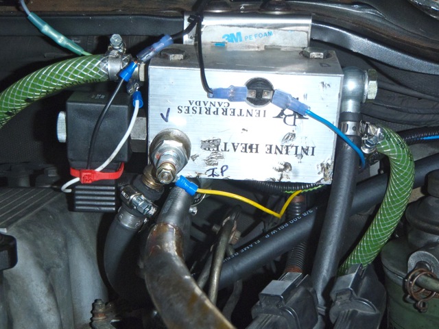

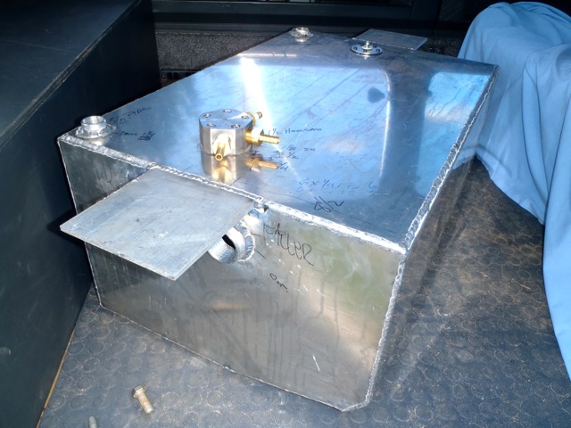

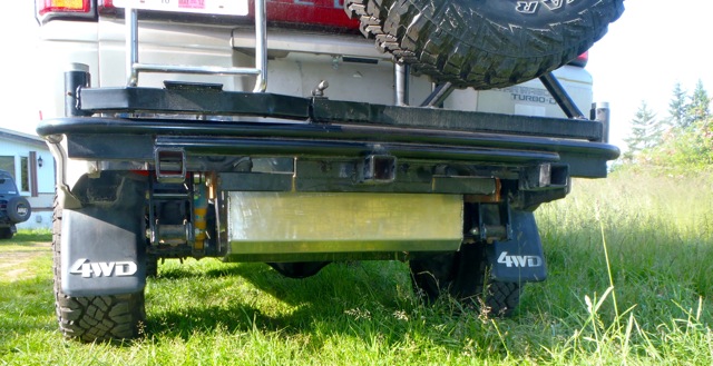

turtle is done! the pictures mostly say it all. a few deets though: the return valve is plumbed to another valve i can turn by hand to select return to tank, or loop back to IP, through an out port in the filter. i took off the hand primer and capped the filter again b/c i think the primer was leaking air (i suspect the filter assy still is still leaking air)
the tank is 120l aluminum w/ a baffle, bolted into the rear sway bar bolt holes.

- heat exchanger.. green lines are coolant. there is a glow plug preheater controlled by the thermocouple

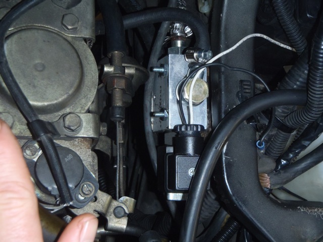

- the return valve

- tank w/ wvo designs hot stick. not plumbing the heated pickup yet
- P6130750.jpg (96.43 KiB) Viewed 16680 times

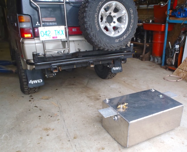

- will it fit?
- P6140749.jpg (104.86 KiB) Viewed 16680 times
- yep!
- P6160760.jpg (97.62 KiB) Viewed 16680 times

Nice custom install, I especially like how you mounted and attached your tank, great idea!

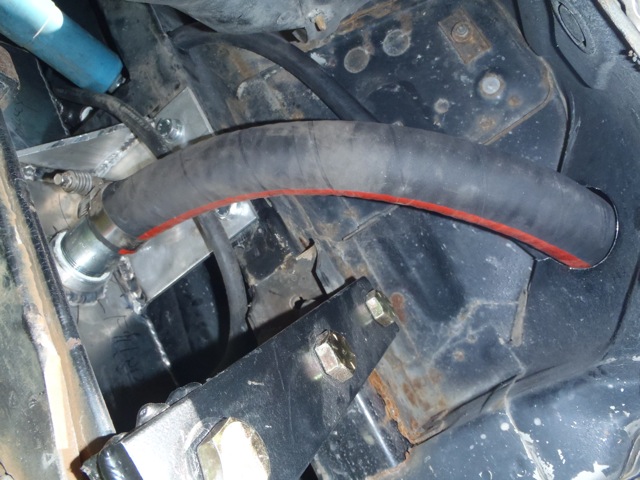

Are the clear coolant hoses rated for high temperatures?
- after oil
- Posts: 1436
- Location: on the road
Re: turtle WVO install pictorial
thanks...fexlboi wrote:Well done after-oil!
maybe they aint rated for high temps.. but theyll hold... i think...
ive used them on other installs with no problems, but before my drive through the Nevada desert this summer ill put real heating hoses on there..
how much pressure is a cooling system anyhow?

Just read a few times on other forums that people running into problems with the clear hoses as they are rate for around +65°C max. If the temperatures rises the rubber gets pretty soft and they might slip off the barbs even with hose clamps.

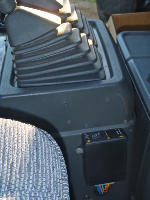

What kind of switch is this?
- after oil
- Posts: 1436
its the brains of the system. its a 3 way toggle, 1 diesel, 0 veg - glow plug, 2 veg + glow plugJordan wrote:Great install, every aspect of that vehicle is so beautiful.
theres relays and a micro chip in there that delays the switching of the return valve to allow for a good purge.
