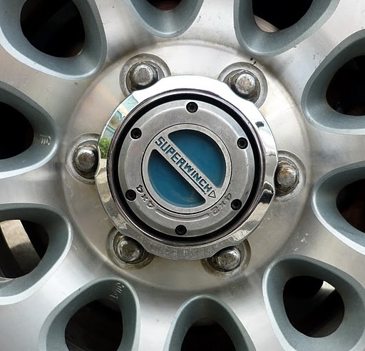

What are you referring to as 'Mitsubishi 5'?
- P1000458.jpg (62.1 KiB) Viewed 5068 times

The 4WD Mitsubishis here have 6 lugs, but I guess he is referring to the 2WD vehicles with 5 lugs.

I edited and made it clear. Yes, as was mentioned, it is a 2WD 5 lug model.Profister wrote:What are you referring to as 'Mitsubishi 5'?
