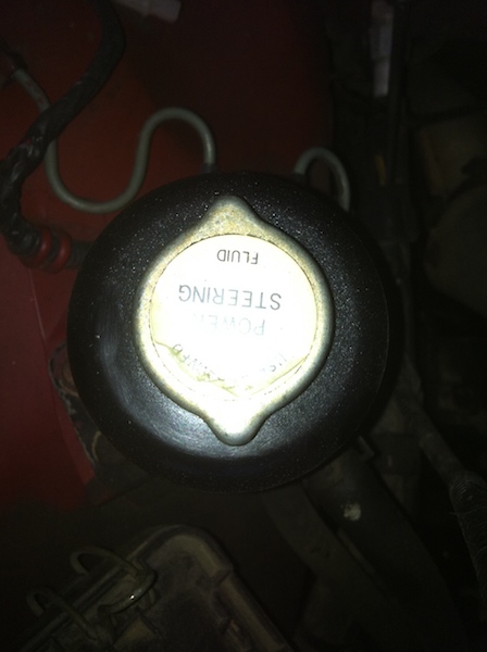

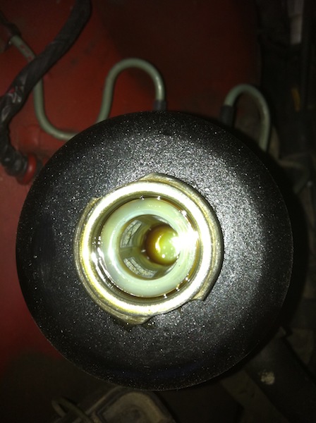

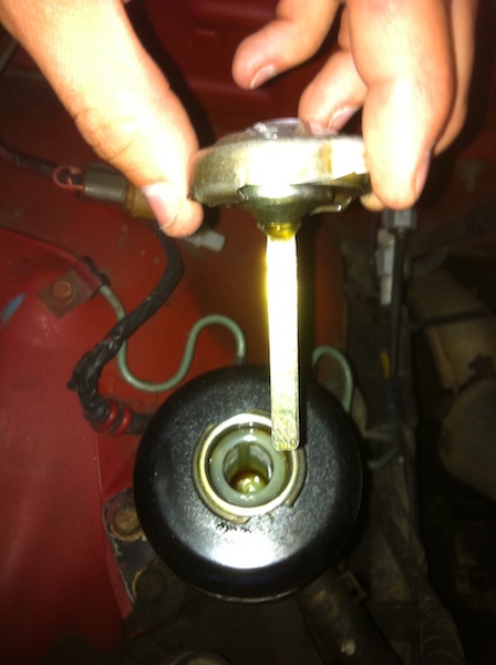

I'm trying to figure out if I have enough power steering fluid in my mightymax. There is a dipstick of sorts but it has no markings on it. Anyone know how I could figure this out?
Re: Power steering fluid
Let's see a picture.

Here they are...
- power steering 1.jpg (67.28 KiB) Viewed 4008 times
- power steering 2.jpg (73.03 KiB) Viewed 4008 times
- power steering 3.jpg (74.16 KiB) Viewed 4008 times
That looks just like the Delica reservoir. Mine has a notch and min/max info. If this one doesn't take the one from your van and compare.
Turns out it has some very faint lines on it, and the power steering fluid was so low it didn't even register on the stick. I filled it up and the problem seems to have been solved but I'll find our for sure when I do my next cold start.
you have the small lines on the dipstick. will say which one is for hot and which one is for cold.
The hot and cold markings appear to have worn off, there are only 2lines so as the engine was hot I filled to the upper line and all seems to be good. It's in the shop getting a once o er for some other thongs too so hopefully they'll give the power steering a clean bill of health
