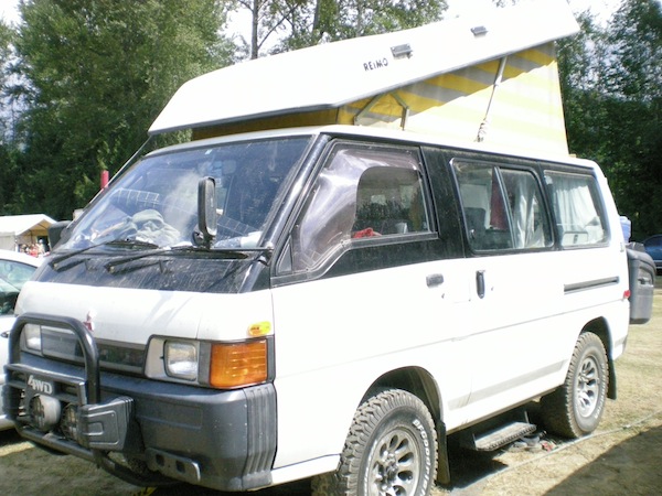

White Reimo Pop Top L300 @shambala 2 or 3 years ago
- after oil
- Posts: 1436
- Location: on the road
my friend snapped this at Shambhala Festival a while back. i think im gonna start a new forum for us elite pop top owners.
- 242897_10150270230925049_547255048_9190116_5518942_o.jpg (106.08 KiB) Viewed 4817 times
Re: White Reimo Pop Top L300 @shambala 2 or 3 years ago
That's the non-turbo one that was brought into Canada years ago.

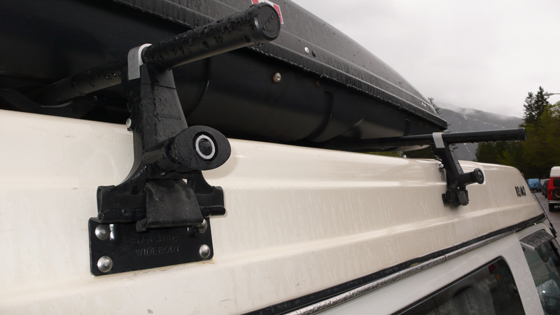

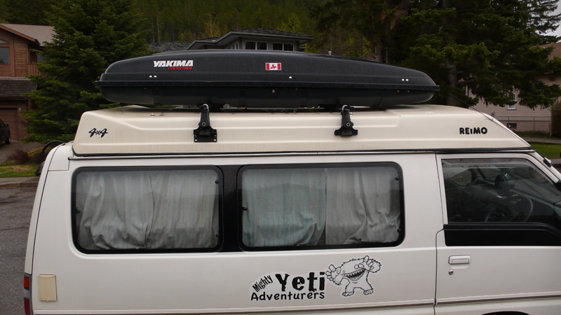

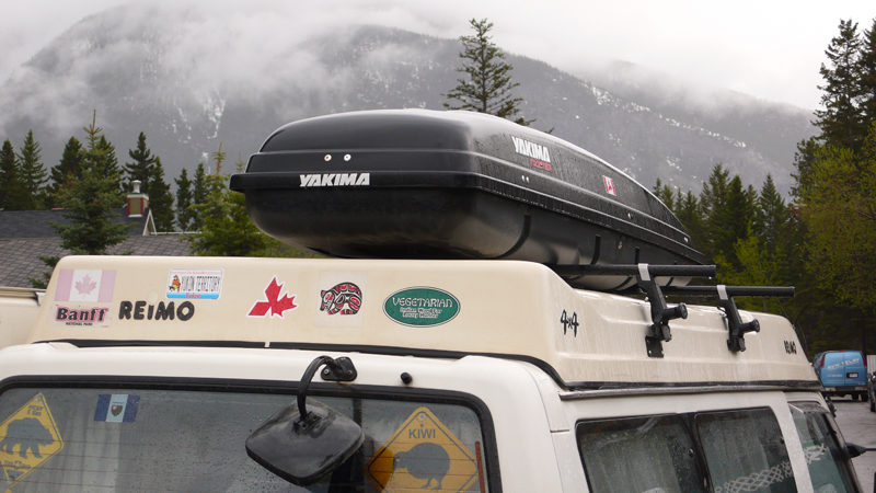

Hey friends,
There you go, some photos of our setup. I put in the cargo box our 1K Watts Honda generator, 2X 10L jerry cans, folding table, and other tarps, extra propane Coleman cans and odd miscellaneous.
I have the same 2 pistons that keeps the top up. So we have to get everything out of the box in order to open it. Even empty, the top is staying up, but you can see that it has a hard time, not fully open.
Anyway, if you have an idea for a mechanical system to lift it up, with 130lbs (more or less 30lbs) of stuff, throw it over here, I am at that point where I am willing to do the whole trial and error thing.
looks good! thats the roof rack setup more or less ill have. have you considered replacing or recharging the struts that hold the roof up? mine seem to go up okay. but i havent put on the roof rack yet

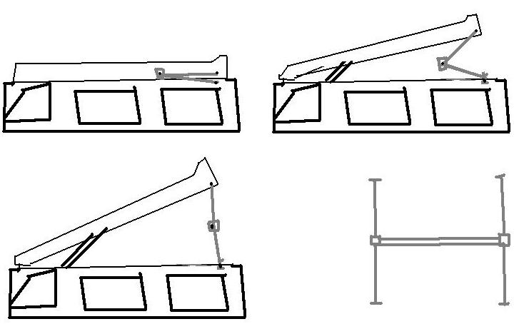

What I was planning to do and would recommend this to you guys (Ari and Fred) is to look at the VW westy's mechanical setup.
Ari, the struts are in great shape on Turtle so those are good. Putting a higher charge on those struts may not be a wise idea.
Basically, on the highside (rear), you would have a mechanical U-shape bar.
I've attached a complicated CAD 3D drawing to illustrate

Yeah good idea!
I have also found the Lift Assist Kit at Gowesty and here is a video with 150lbs on the roof with only one kit installed; http://youtu.be/PJiTCkFXXnA You can have a dual system as well for heavier load. But your idea of the bar on the back might be helpfull too... you know in winter... snowfall... covering the roof with snow, making it heavier and the suddenly you wake up with the roof on your back... not fun... So at least it would block it from going down in case the lift kit fail. Hummm... I will have to see with my friend the welder and if it would work... jfarsang (Don’t know your real name), You might have earned yourself a flat of beer my friend!!!
I will also have to put clamps on the back and front attached to the roof and clamping on the actual gutter. That way the roof will not move as much while 4wheel driving...
I think I night get myself a little project for the summer!!!
Fred
Fred
Fred, it's Jesse.
The thing with the mechanical setup is that it will lock in place preventing the top from closing.
You can get somethIng similar to what Jesse suggested at most hardware stores. Essentially it's the same but does not have the crosspeice in the centre. They are rigid enough as is. I was looking at some smaller ones and they could handle up to 300-500 lbs drpending on the model. I'd post pictures but I'm on my iPhone...
