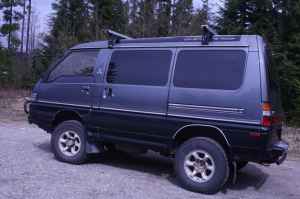

Re: Help the Newbie to buy
for visuals
- the beast in question
- 3m93p33le5V45Z05S0b54636dfa9dc1e213d5.jpg (7.14 KiB) Viewed 7668 times
I think what Thedjjack is saying is "2.8 do not have timing belts". I'm inclined to agree with Thedjjack ~ never seen it done, I have heard that due to the shape of the 2.8 litre 4M40 engine, modifications would have to be made to the frame of an L300. They are two completely different machines, accept for the oil cap. The 4D56T 2.5 litre is the typical diesel power plant found in an L300 Delica. As Christine said ~ take it for a test drive to CVI Automotive and get it checked out, WELL WORTH THE INVESTMENT.thedjjack wrote:Never seen a 2.8 swapped.....also 2.8 has a timing chain so hard to believe that the timing belt has been inspected (2.8 do not have timing chains).
Timing belts look great sometimes right up to the minute they fail. Plus it is really hard to see the balancer belt without taking the entire front cover off (labour for that would cover changing the belts).
The little balancer belt is known to break taking out a perfectly good looking timing belt.
Making sure fluids are full is good but again they will do nothing if the radiator is blocked or a rad hose explodes.
DO NOT TAKE THE OWNERS WORD...ie no bills no work figure on putting $1000-????? into it. This is why I would take it to an independent shop such as CVI. A Delica with a blown motor is worth $1500-$3000 these days big loss of investment if the belt breaks.
If they think it is the 2.8L then they are not qualified to say the belts are fine!
2.5L -4D56 has a big black cover at front of motor to cover the timing belt:
I cannot find a photo of the 2.8L 4m40 that you can see the motor in but it has no big plastic cover for the timing belt as it is a chain driven motor. This photo shows the chain.
