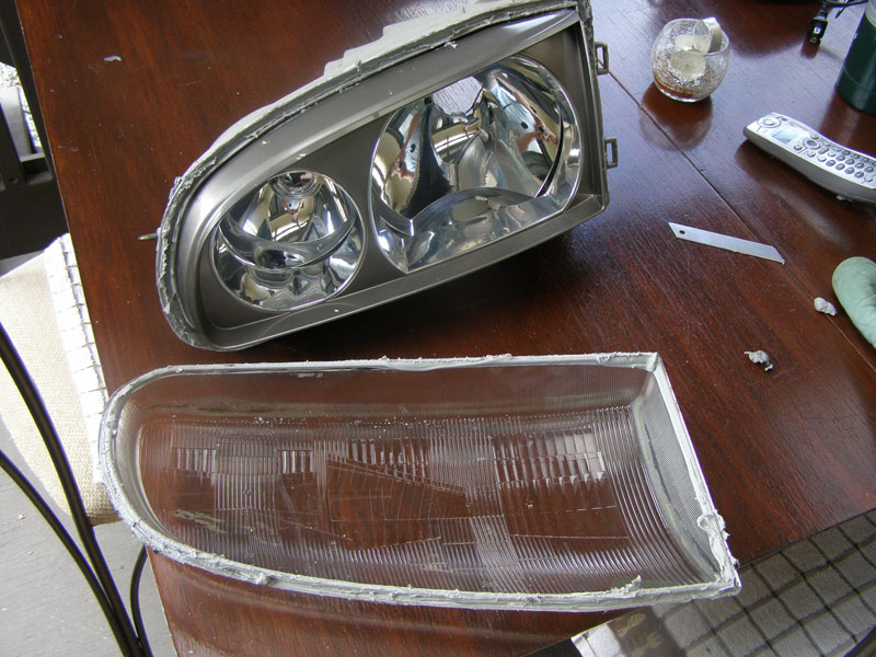

1)Remove Retaining Clips and Place Assembly in Barbecue with Lid open and Glass down for about 10 MIN on med heat**Wear Safety Glasses**
Note:Do not place on side place Glass down as plastic housing cant take the Heat..

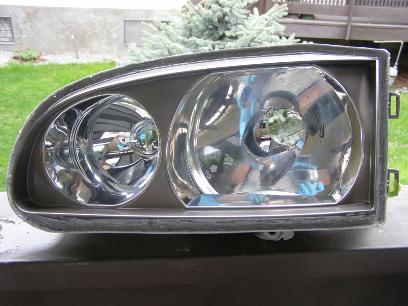

Remove Lens once the Existing Sealant becomes Gooey,I used a wood Chisel and Carefully pried it off by slightly twisting.
Now clean the Housing Channel a bit...Not necessary to get to crazy just get the big chunks out so the new lens fits down.
Note:This Sealant is Difficult to get off so try hard to not get it in interior of Housing.
Note:Caution..The Chrome looking Reflective Surface inside is a coating that can be Easily Damaged by rubbing or using harsh solvents.
clean channel.jpg (139.03 KiB) Viewed 6469 times

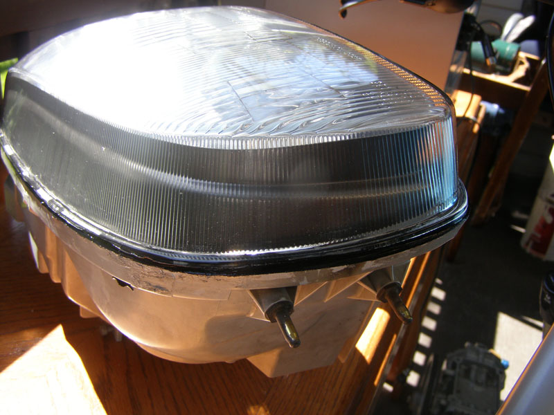

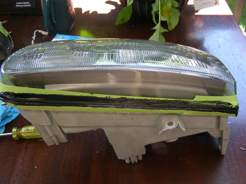

3)Fill Channel about half full with fresh Adhesive sealant,place new lens in and Carfully install retaining clips that hold the lens in place while curing,I put them on with a Dab of Goo so they would not fall off..
4)After Cured I Masked off the Bond line and fay sealed once more to fill any voids...
fay app.jpg (138.53 KiB) Viewed 6469 times
Peel off masking and Voila!!

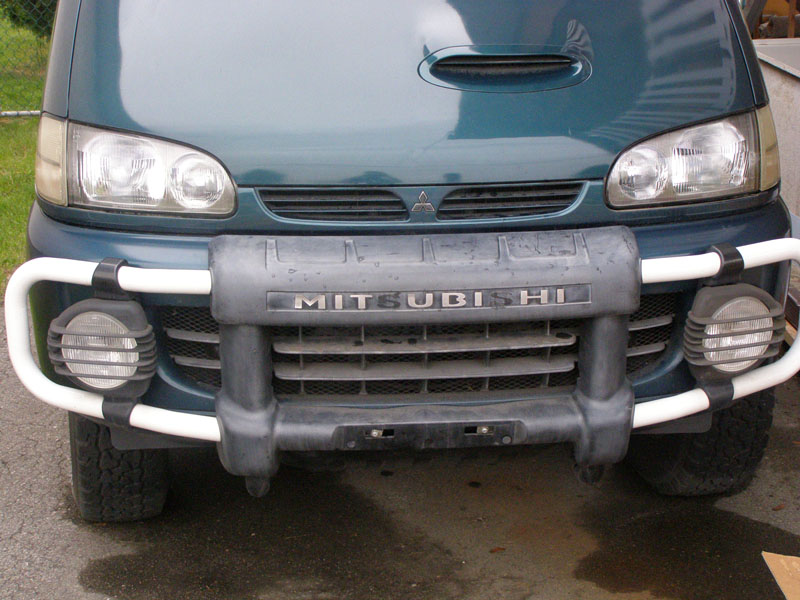

And Finally here is Buffalo Neils Finished install of New E coded Headlights :-D
attachment=1]buffolo neil.jpg[/attachment]
Now we have to take care of this faded plastic...

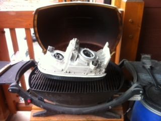

Here's my headlight on the BBQ:

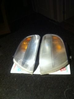

While I was at it I cleaned up the signal light lenses. I used the toothpaste method which I also learned from youtube.
Here's a photo with just one of them done for comparison:

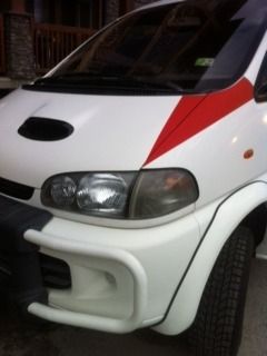

And the lights back on the van:
