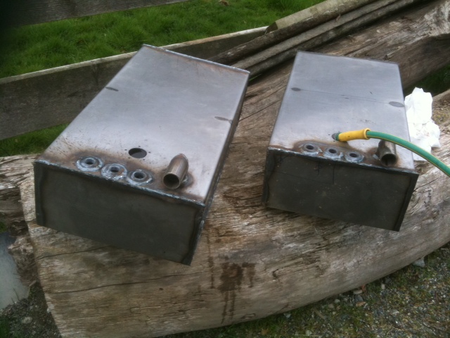

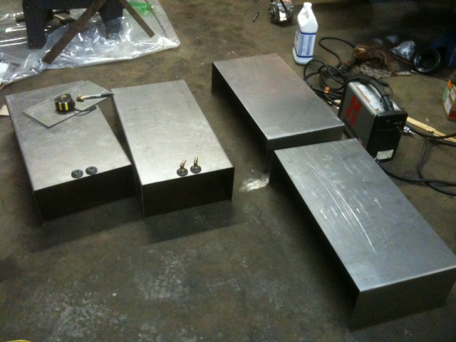

first crack I've had at it. Turned out really well.
Made a pair. One for me and one for David.

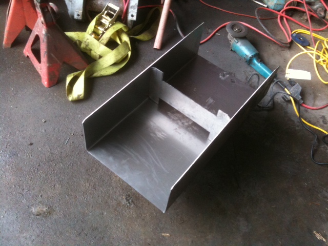

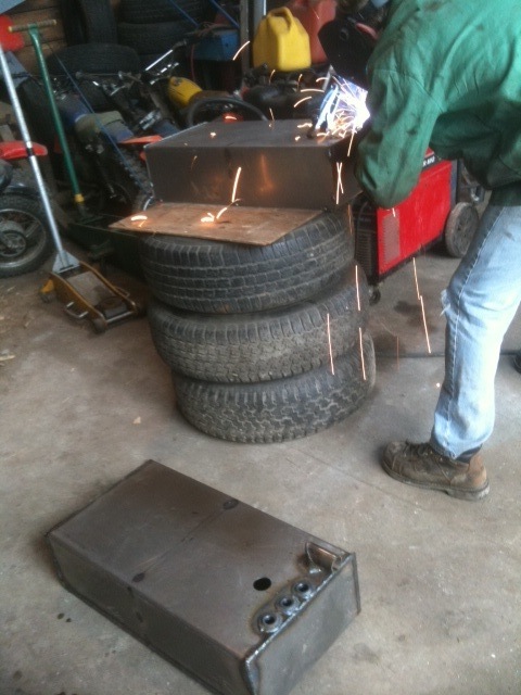

Did it smaller than norm to fit some more gear underneath. 45L It's 27" long , 14" wide, 7" high which tucks it up nicely so it doesn't stick out the bottom of the frame.
Used .120 sheet metal and two piece bent up welded together.
Cost :
$170 for metal/bending
$25 bungs
$85 fittings/pickup
$100 tank clean/lining
$80 sandblast/painting
$40 misc driving/welding,etc...
Total : $500 / $250 ea
We were going to spend at the very least that amount for an aluminum tank but it would have not fit as well.
Checked them for water/air leaks and now just have to wait to get them cleaned, lined and painted.

Re: building an auxiliary tank

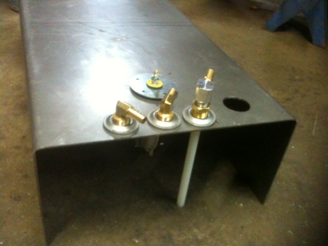

looks great! I'm jealous...
Don't use brass fittings though - they will react with veg. oil.
I'll need to find a place for non-brass fittings. Thnx for the head's up

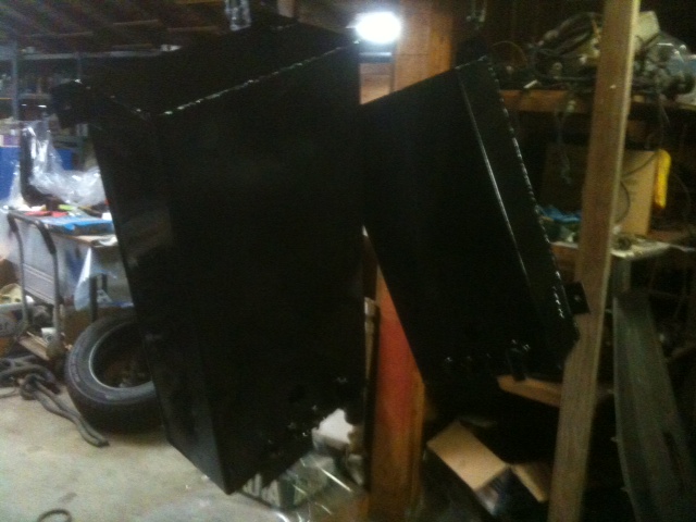

progress

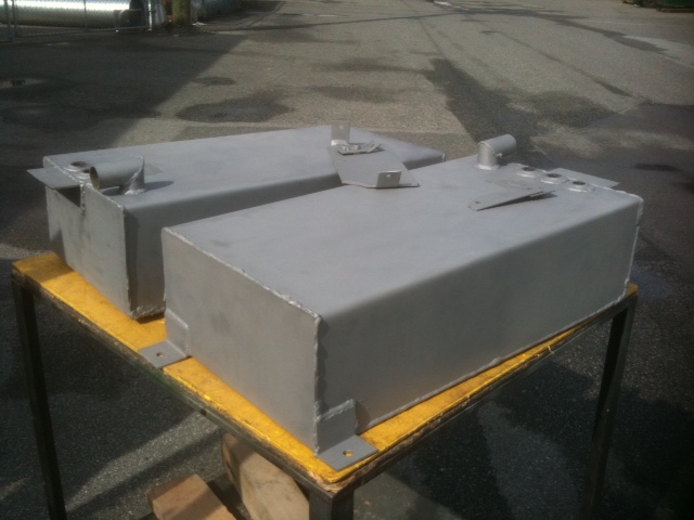

Sandblasted and then painted with Chassis Black POR15.
progress
How do you line them?
I bought a few stainless steel barb fittings at New Line in Burnaby for our tank.jfarsang wrote:I'll need to find a place for non-brass fittings.
Just checked the Western Marine catalogue. They have quite a few aluminum (from EVM) and stainless fittings too.
Another good place is http://www.fairviewfittings.com
This tank is for diesel so the brass fittings will do.
Getting lined by renew tanks in aldergrove on 264th
Nice work! Looks great.

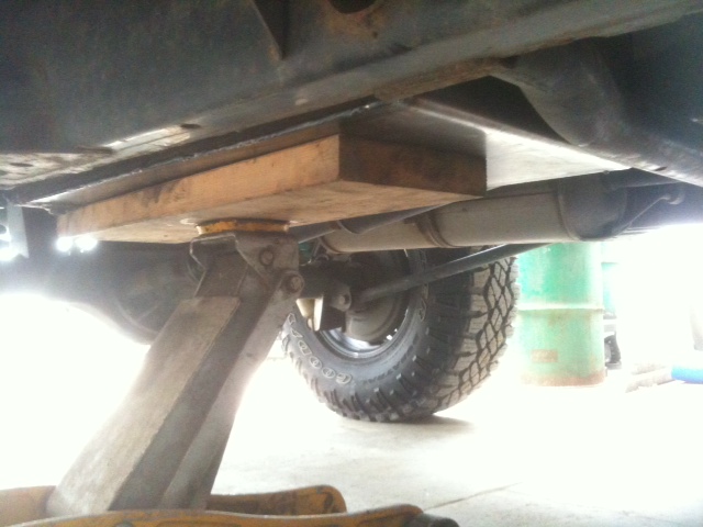

Only thing I would do is add a drain in the bottom corner on the side (so it does not get taken out off-road).

I'm pretty sure there's already a drain plug on the bottom rear corner as we spoke about it during initial design (check picture where tank is supported by jack. To protect we simply add a 1/4" steel ring around the plug...)
Then it looks perfect
Yes. Yes it does
What a great tank! Nice work, as always. It is a dang good idea to get it lined. Every steel tank I have ever seen used unlined with WVO started to form the 'skin' of oxidized oil that can be a PITA to get rid of...
Can you enlighten me on lining a tank? I gathered it's for oxidization. What would a liner consist of? Materials? Method? Sprayed application? Links?
nice work Jessie, are you going to put any sort of a skid plate on it to cut down long term wear and tear from rocks,gravel and things like that? small hole steel mesh would be ideal as rocks would beat it up over time rather than your tank , that could make the tank last longer than the vehicle and you can easily replace it also you can look from time to time to make sure a small rock or road debri does not wedge between the tank and the protective cover and slowly wear a hole in the wvo tank.
3/8" thick steel plate tank. I don't think it will get hurt
