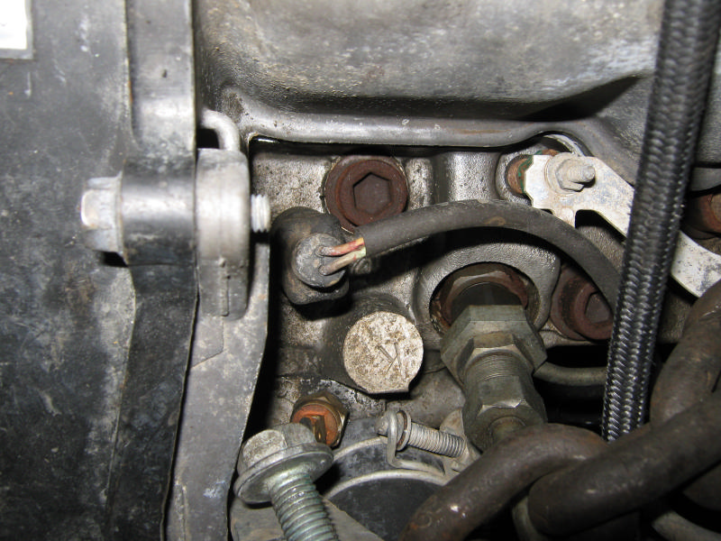

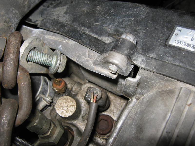

Anybody know where it the temperature gauge sender???

2 pin guage on the cylinder head.1 pin is a switch.

Thanks,they were both plugged in ,l will have to check if the gauge is the problem.

the sensor probably died.

Hi,it is the sensor.

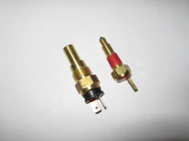

We have them in stock, all Hyundai original and fit L300, L400 and Pajeros.simonliew wrote:Hi,it is the sensor.
is the sensor commonly use on other mitsubishi in canada?
Simon
1. water temperature gauge unit ( 2 pins )_$55
2. water temperature switch assembly ( 1 pin )_$50
Steven
