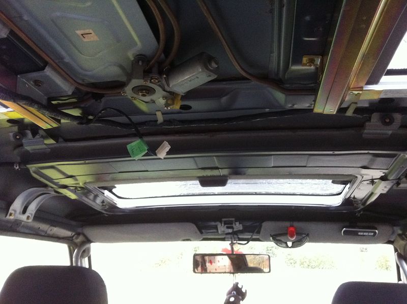

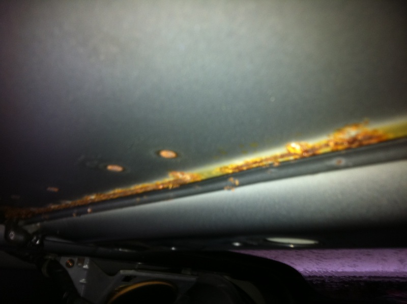

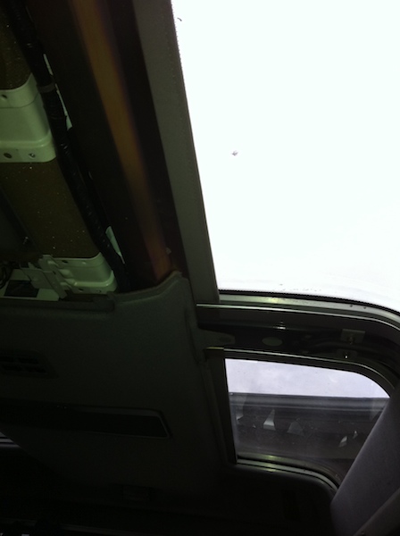

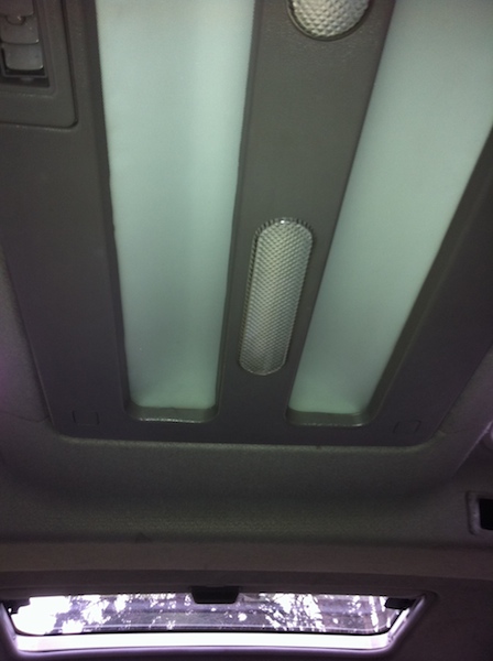

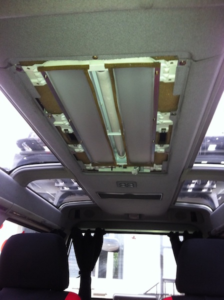

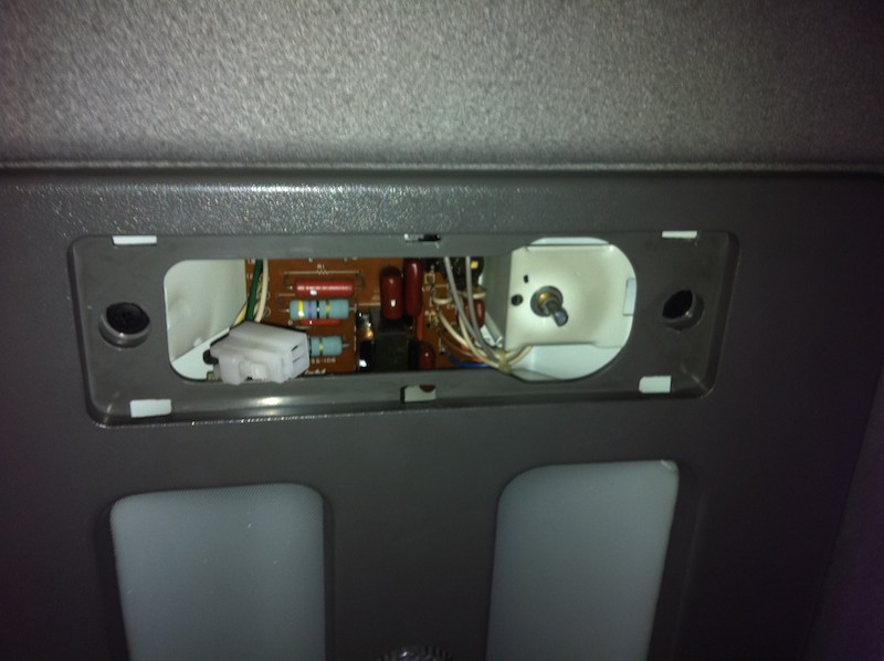

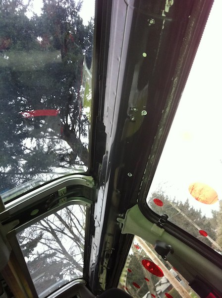

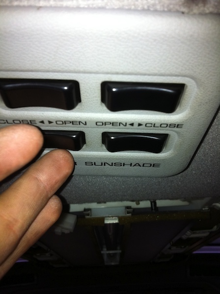

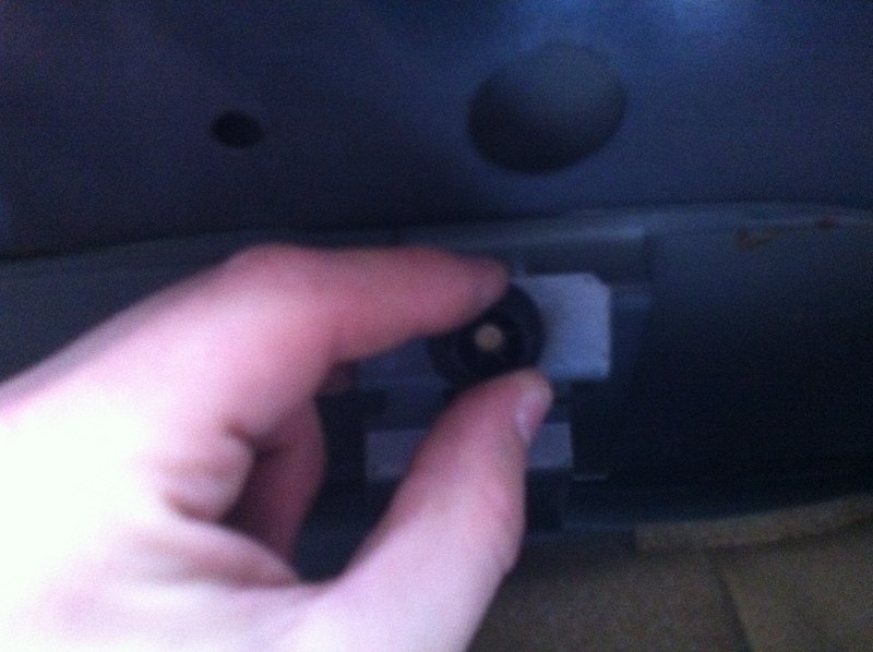

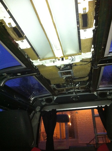

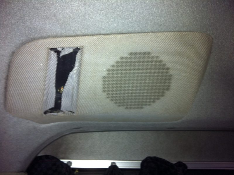

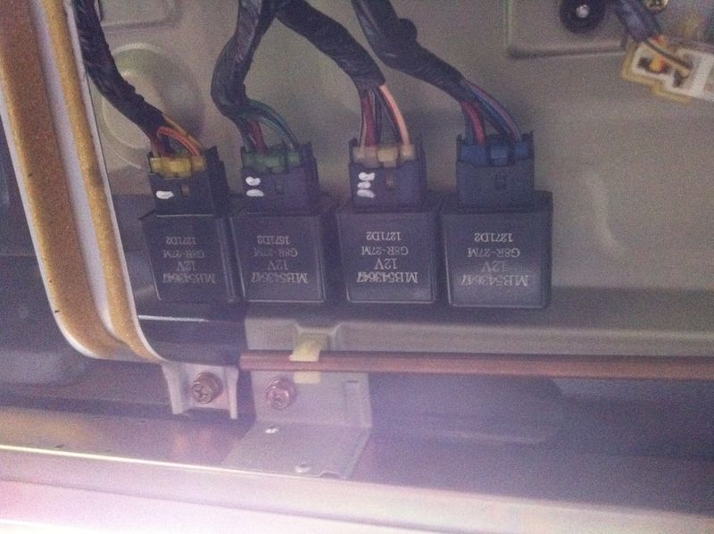

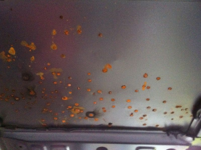

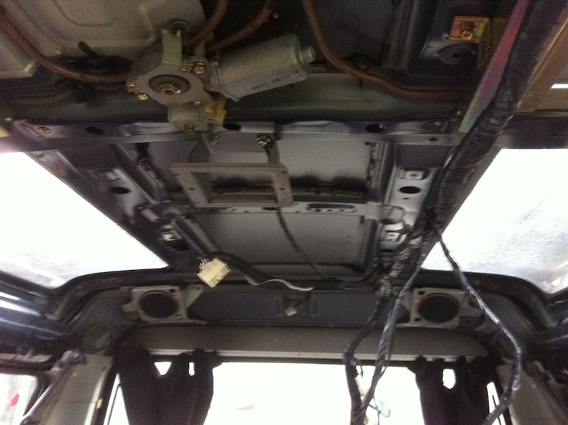

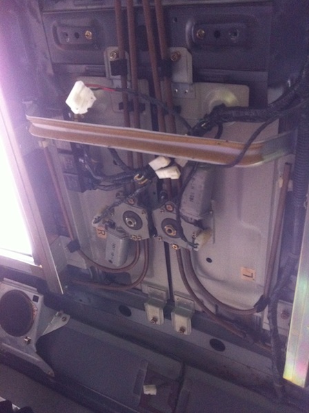

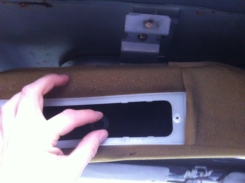

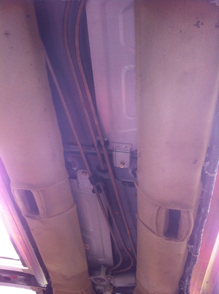

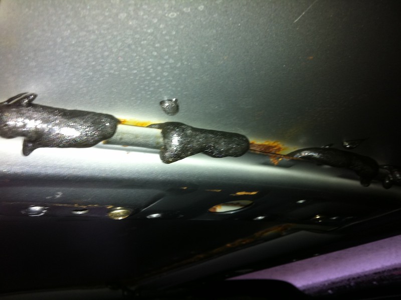

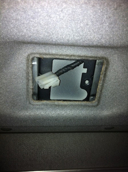

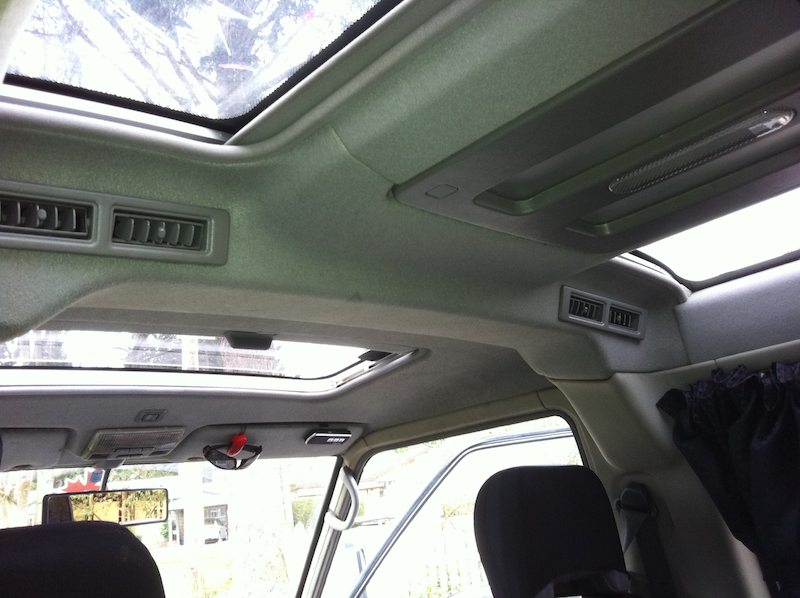

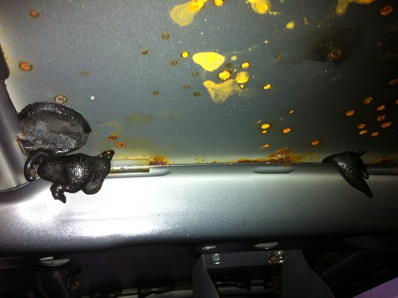

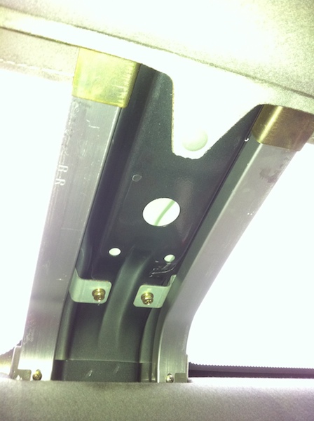

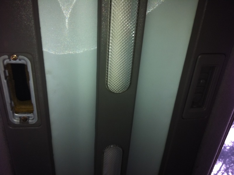

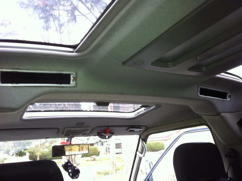

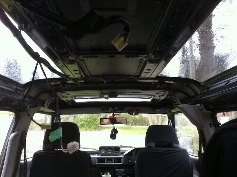

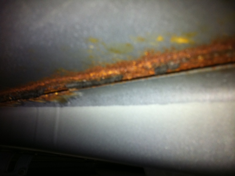

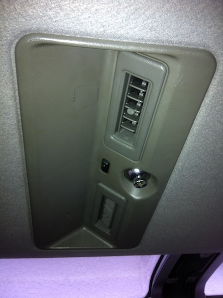

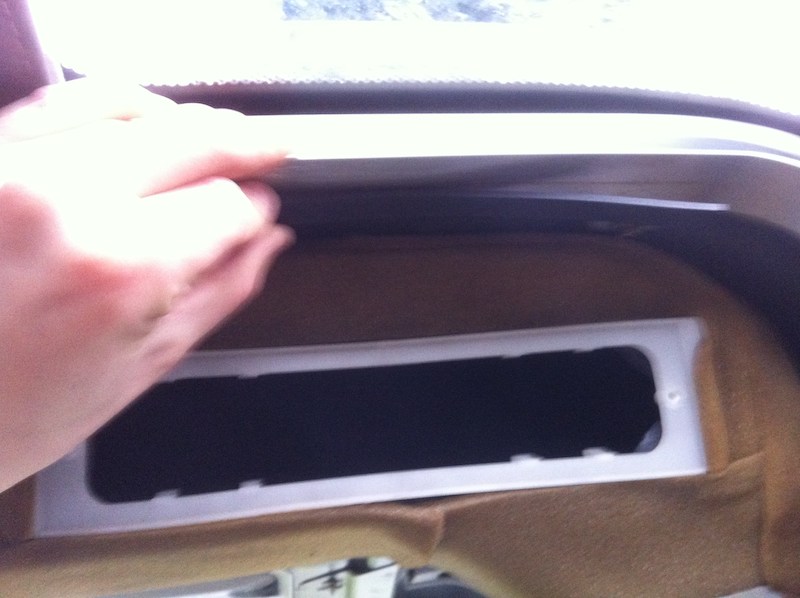

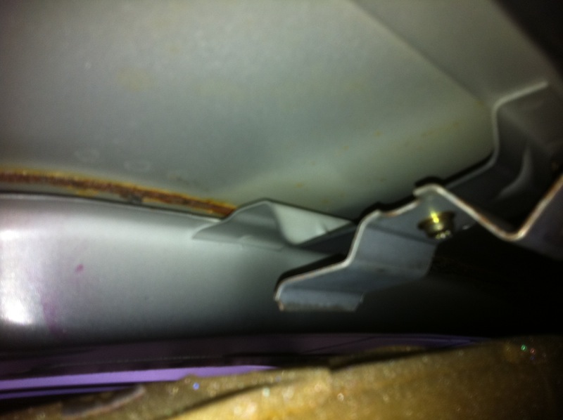

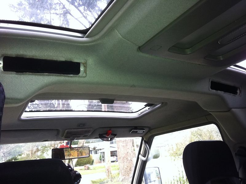

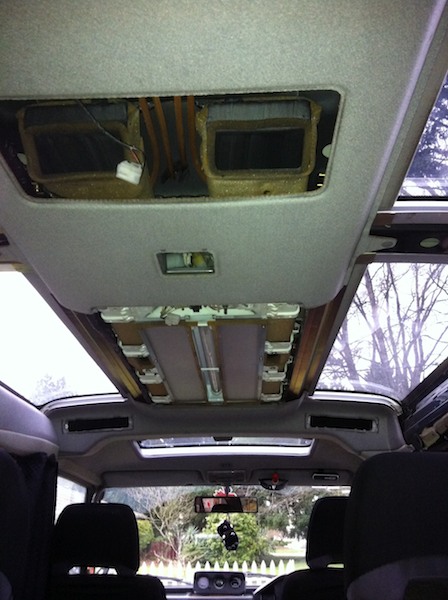

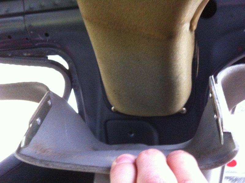

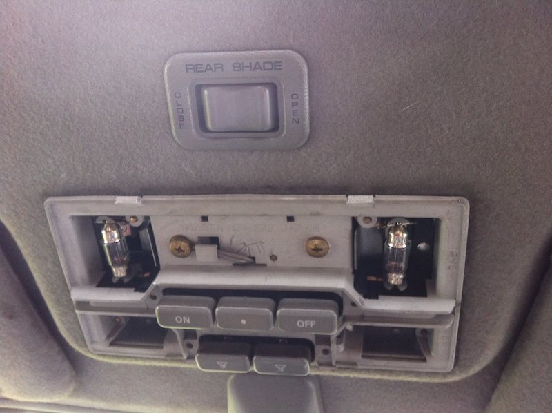

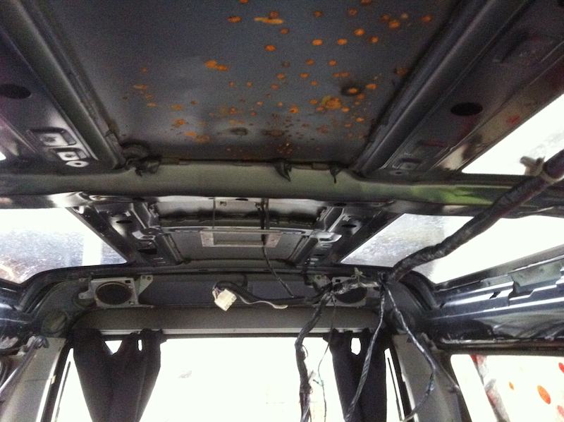

I'm in the process of trying to repair the rust damage done by the cl roof set-up. I've done the removal and here are the pictures I took...
Next step is to sand / remove rust from inside and out, rust proof paint the interior, bondo, prime and hippo line the exterior and then put the interior back on. I'm still wondering however if I am to miss a spot of rust and then cover it with rust proof paint will the rust continue to spread or should the paint take care of that?
- 1.jpg (76.89 KiB) Viewed 7184 times
- 2.jpg (73.85 KiB) Viewed 7184 times
- 3.jpg (72.37 KiB) Viewed 7184 times
- 4.jpg (71.5 KiB) Viewed 7184 times
- 5.jpg (74.43 KiB) Viewed 7184 times
- 6.jpg (75.05 KiB) Viewed 7184 times
- 7.jpg (77.45 KiB) Viewed 7184 times

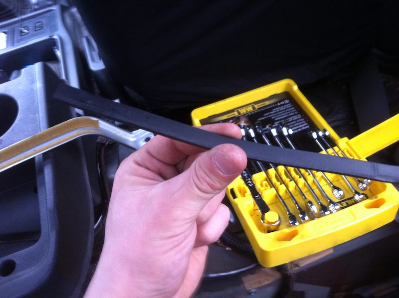

Tips:
- make sure you unplug everything and move things that could potentially get in your way.
- keep a cellphone close in case you get stuck with the main light assembly on your head and need someone to help you
- use a ratchet instead of a screwdriver when possible so you don't strip the screws
- watch out for falling particles of rust, bugs and other debris
- fix your roof before problems start to arise and things will go much more smoothly
- watch how you swing metal objects around with so much glass nearby
- pay close attention to what you're doing and label everything
- use logic an common sense
- don't force anything

Removal was quite fast and easy and I was inside the whole time listening to music. Took me about 3-4 hours to get it all removed but should be faster if you know what you're doing. I'm a little concerned about being able to sand down all the rust from the inside and am hoping that if I miss a tiny bit here and there it won't be detrimental in the future. I get the feeling the worst it still to come.
- Posts: 1671
- Vehicle: -
- Location: -
Re: Removal of interior to access crystal lite roof
Wow, there are quite a few spots...Do you actually see any rust spots from outside already or is it still all inside?
Glad I don't have a CL anymore
I do have some bubbles on the outside. I'm glad it's not as bad as most of the parts vehicles I've seen though. I still love the cl roof and I bought it knowing it had rust so I really shouldn't complain.
