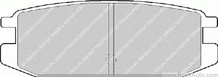

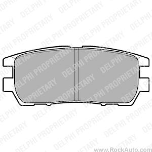

The parts i did order don't fit my 89. it will fit a 92 and up though. I am looking for the rear pads that look like this.Help i have about 20 000 ks left then out of co mish. But am i ??. I still can send my pads to Alberta brake and clutch in Edmonton to have new pads put on. Then i have to wait for the bus to go anywhere, until they come back from Edmonton . How long this takes i don't know. This is why i want a second set so i can send one and use one set. I need help very soon.

- this one is the set i need
- rear pads FERODO Part # FDB1010.jpg (11.85 KiB) Viewed 4833 times
- This is what i have in my hand and its no good will not fit
- this one is a no fit DELPHI Part # LP954.jpg (10.28 KiB) Viewed 4833 times

It turns out i have the older version of your newer rides so i cant use the 92 montero rear pads. the design changed in 90 11 yy mm. Sucks for me. Here is what i have found out for my rear pads .

- This is the one i need
- rear pads FERODO Part # FDB1010.jpg (11.85 KiB) Viewed 4769 times
- Does not fit Used for the 92 and newer
- this one is a no fit DELPHI Part # LP954.jpg (10.28 KiB) Viewed 4769 times
