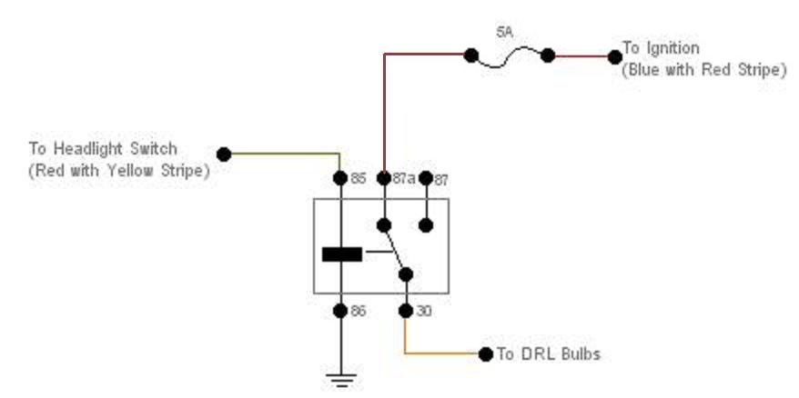

Green1 wrote:After installing this system an unexpected side-effect has arisen, the brake sensor wire is also activated if you have low brake fluid, meaning that if your brake fluid is low the DRLs also shut off... to solve this problem I recommend putting a diode in the original brake sensor wire so that the signal from the brake fluid sensor doesn't travel back along that wire and to the DRL relay. (or simply make sure your brake fluid is topped up!)
Let's say I wanted to do this mod but with out the e-brake part, is this the way it should look?

Yes, that looks right. I wired mine slightly different from Green1's, but same idea. One thing I added was to put a small LED light on the dash that comes on with the DRLs, so that I have a clear indication that they are on. Hopefully enough of a warning that I don't forget to turn the headlights on at night -- the dash light is almost annoyingly bright at night. But not so bright that if I'm driving in fog at night with only fog lights that I'm blinded by the DRL warning light.

good, I hope that re-wiring it fixes the issue I'm having with overly dim low beams.
ummm.. the diagram was from your vehicle not mine... remember, mine is completely messed up and complicated... :shock:
(they do exactly the same thing and behave identically, and in fact I designed the wiring for both of them, but I did it a completely different way each time....)

loki wrote: Let's say I wanted to do this mod but with out the e-brake part, is this the way it should look?
I assume you are using separate bulbs for the DRL? Otherwise I dont think a 5a fuse will cut it and if you are using the lowbeams, your truck will not shut off if your headlights are on. Also, if you turn your headlights on with no key in the ignition, the whole truck will be powered through your DRL relay.
