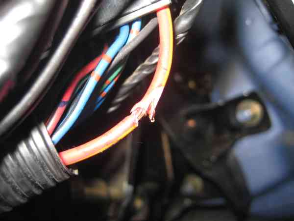

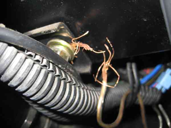

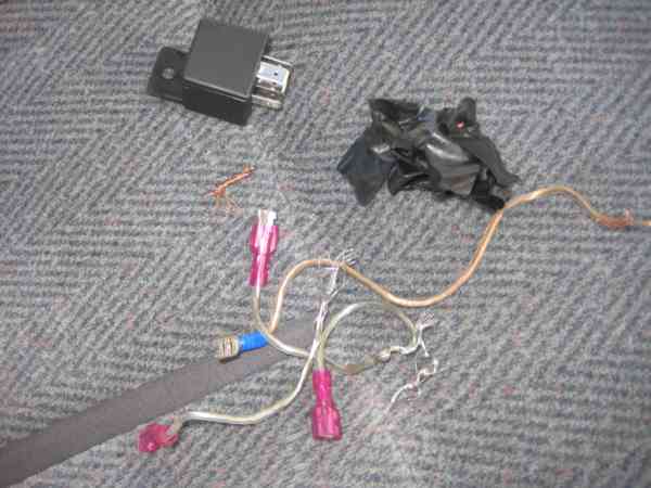

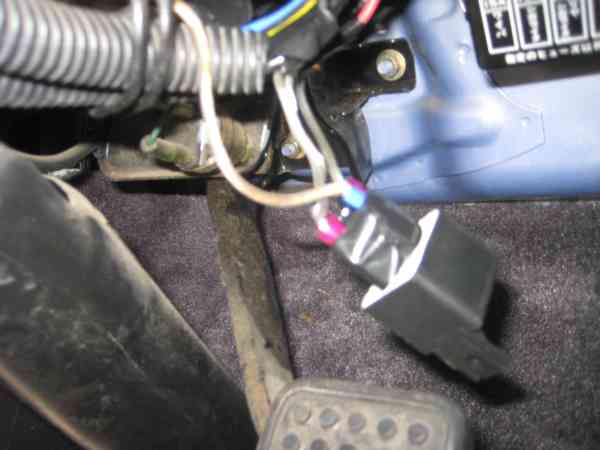

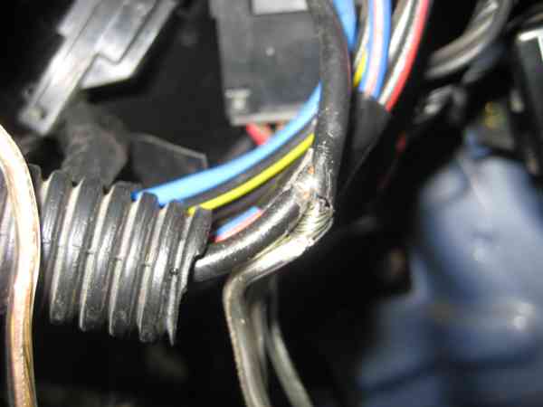

Just adding a few pics to show what I mean about the DRL install. Kinda added the pictures in the reverse order of what I had intended... whoops.
- This is what it looked like after I re-did the wiring.
- DRL 030a.jpg (27.06 KiB) Viewed 10713 times
- The "DRL MODULE" removed, yup that's paired speaker wire pulled apart to make individual strands. As an engineer and former vehicle designer this is scary. Other than car audio this type of wire is not to be used for running constant 12V loads. In fact, it's illegal under CMVSS to use anything but wire that conforms to SAE code J1128 specs. If your car did burn up or there was an accident and ICBC did an investigation (not likely unless someone dies) there could be a bit of heat over this.
- DRL 031a.jpg (30.57 KiB) Viewed 10713 times
- Here is a wire wrapped, notice what kind of wire it is by the way. Clear insulation??? Huh?
- DRL 003a.jpg (20.22 KiB) Viewed 10713 times
- This was how the original wire was spliced into. Notice that the insulation is torn, and that some of the strands of the wire are broken.
- DRL 017a.jpg (19.36 KiB) Viewed 10713 times
- The wire that had broken off.
- DRL 016a.jpg (21.75 KiB) Viewed 10713 times
- The relay as I saw it, dangling next to the gas pedal. It was not attached to anything, I'm assuming they tucked it in with some of the other wires and it eventually wiggled loose.
- DRL 002a.jpg (22.89 KiB) Viewed 10713 times

That is totally brutal!! Good thing it fell apart before you had a fire and a good thing for others to check to make sure it looks right.
speaker wire....really....I cant get over that one....
Joe
Joe
