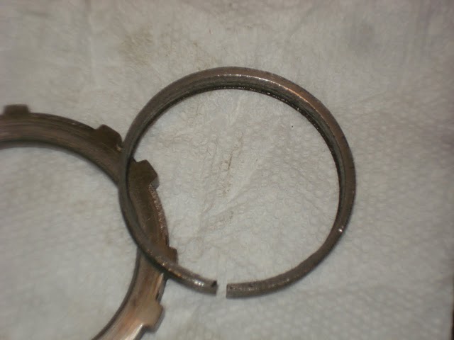

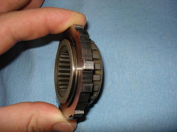

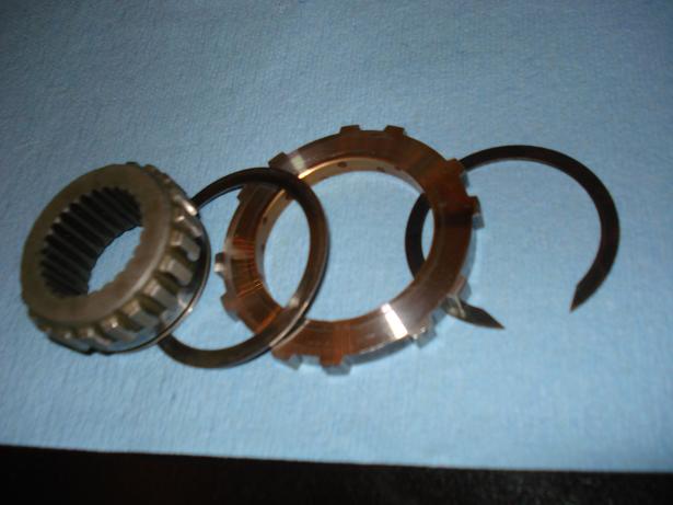

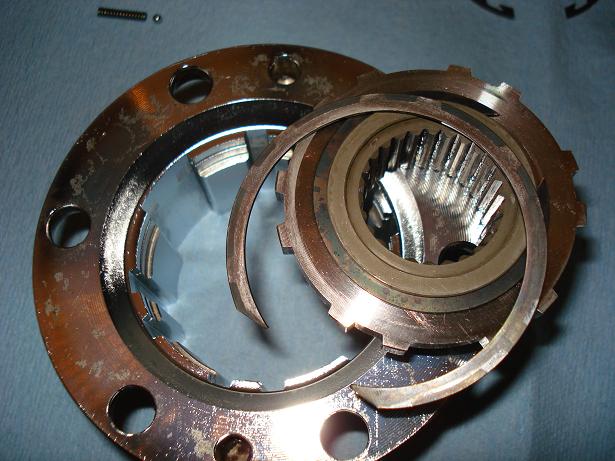

Here is the damage from driving with loose manual hubs:
note the missing teeth at 5 o'clock

Re: oh $hit my manual locking hubs nearly came off

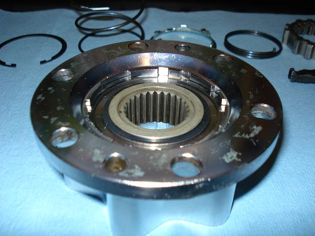

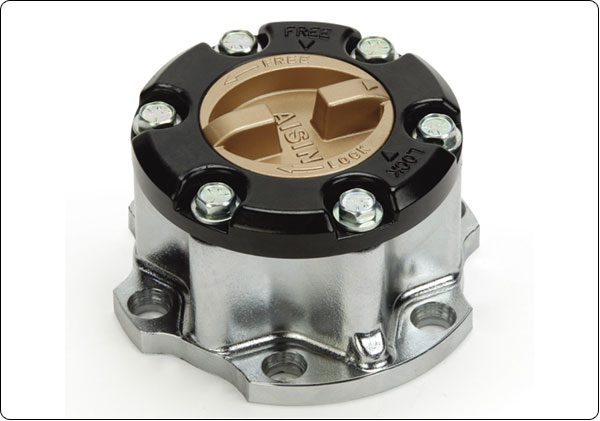

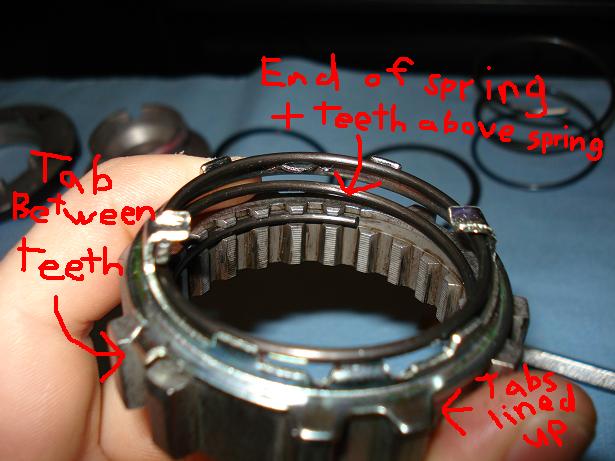

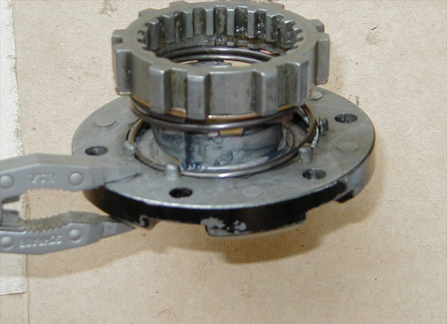

The Aisin's are literally bulletproof with the only wear internally being the collar sleeve and that's a big if.
I've never in my life seen Aisin's shear like that at a specific area (not the entire circumference) and cannot find a single person who has either hubs tight or loose.
There are chinese copies of Aisin's floating around and they may look identical to Aisin's but the metal/casing/sleeve's may not be up to Aisin's tolerances and you may get slop. If you get slop, then premature wear may be a reality down the road.
Not sure what your Aisin copies look like but these are what real Aisin's look like for a comparison and the last pic is the sleeve that tends to wear over time and be replaced.
Hub 01.jpeg (51.99 KiB) Viewed 4443 times
Hub 02.jpeg (43.23 KiB) Viewed 4443 times
Hub 03.jpeg (47.05 KiB) Viewed 4443 times
Hub 04.jpeg (69.59 KiB) Viewed 4443 times
Hub 05.jpeg (59.28 KiB) Viewed 4443 times

These are what real Aisin's look like for a comparison
X2.
We are selling Original Aisin with new bolts and washers.
There's nothing good with cheap price.
http://www.delica.ca/forum/manual-hub-a ... -9447.html

for the record, BOTH sides have sheared teeth. i thought id check it out. the other side was bolted down tight. i barely ever even locked these things.....
ouch. sorry to hear. if you have both sides sheared like that, then I'd bet my Safari that it's low grade metal cast.

Firesong
Posts: 1363
Location: Saskatoon
Post by Firesong »
Whoa guys!!!
Those teeth are missing on purpose.
That's where the inner spring threads into the groove.
Seriously!!!
The spring threads in and pulls the unit back etc using
the spring as the unit is locked and unlocked.
Mine are like that as well.
Post by fexlboi »
After Oil, as far as I can tell from the photo, there is nothing wrong with the gear. As Firesong already said these teeth are suppose to be missing for the spring to fit. They are missing on the gear of the Aisin hubs (photos) as well.
