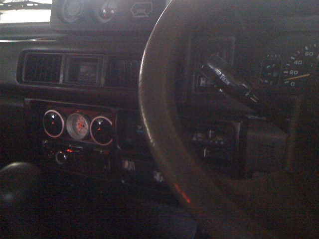

Hi
Nothing i'm ading a gage and for conection purpose.
just wondering what is the best spot..

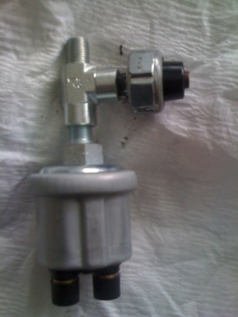

Here is a picture of the unit..
cheers
cheers

Re: Oil pressure sensor
That's the one except mine was black.
New line guys are helpful and like odd things like JDM's
Hi Farsang
Thanks again, yes the people at new line fittings are the best I was there les then 2 minutes.
All I can say what a difference all the gage's work.
And it looks very cool.
The part number is N5602-02-02
1/8 MNPT X 1/8 FNPT X 1/8 FNPT TEE
And is only 3.26
And is only 3.26
