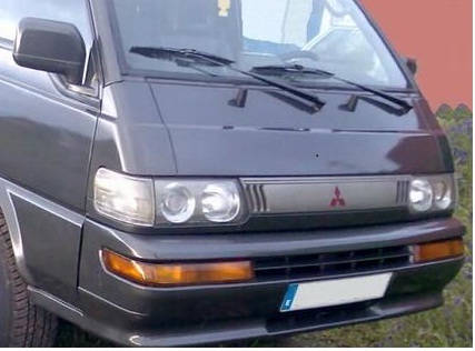

- Thiw is I want to do...!
- DEL.jpg (46.87 KiB) Viewed 4091 times

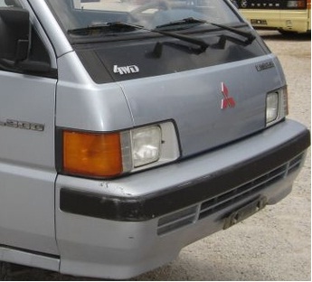

- This I have...!!!
- L300a.jpg (35.11 KiB) Viewed 4091 times

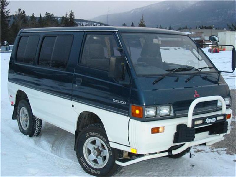

Have you thought about these?
cheaper and looking at the lines might fit with less
modification.
Right On!
They are in my opinion a lot better than the later style,cheaper and looking at the lines might fit with less
modification.

Re: L300 to Delica !!!
Not bad.... where can I find these and what about cost?
I like more the first one but I think that it will take more work and parts. hood, corners, headlights etc.
Do you know where can I find a parts list in pdf ?
The 4-lamp type headlights are the standard ones for USA-spec L300's. They can be ordered from USA dealers.
You may need to make some modifications to mount alternate headlight mounting hardware.
I can get the part numbers if you need them.

I think that there is not only the headlights but the hood, the cornrers, the headlights mounts inside, the plastic piece in the center etc. These are the parts I obviusly need but I dont Know if there is more. Maybe the parts list book solve the problem but I dont have it especialy in us specs.

Since you need everything; these are the "headlamp kit" part numbers. They seem to include everything except the actual lamp unit. The front trim for the headlamps is part of the clearance lamps.
KITS: MB527637 and MB527638
Trim/clearance lamps: MB527509 and MB527510
Front panel: MB506642
If you want pricing and availability let me know.

It appears that the front panel comes with the left and right body mounts for the headlamps. It also appears that the side corners that go above the lamps are the same for your model and the USA-spec L300, so you should be able to reuse your covers!
As to a catalog; ask your dealer if they can give you printouts of the screen shots of the areas that you are looking at. Most dealers are willing to do this.
