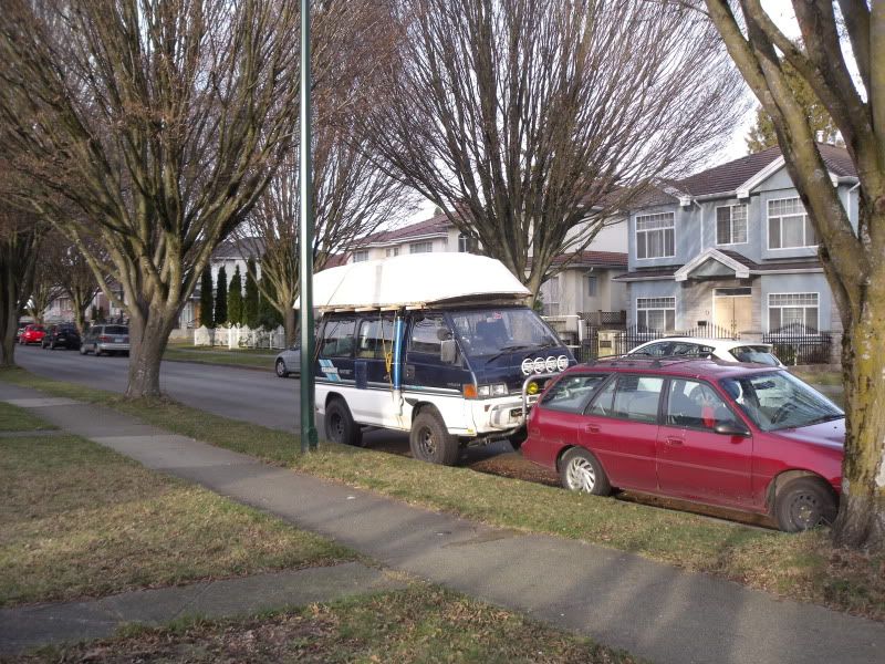

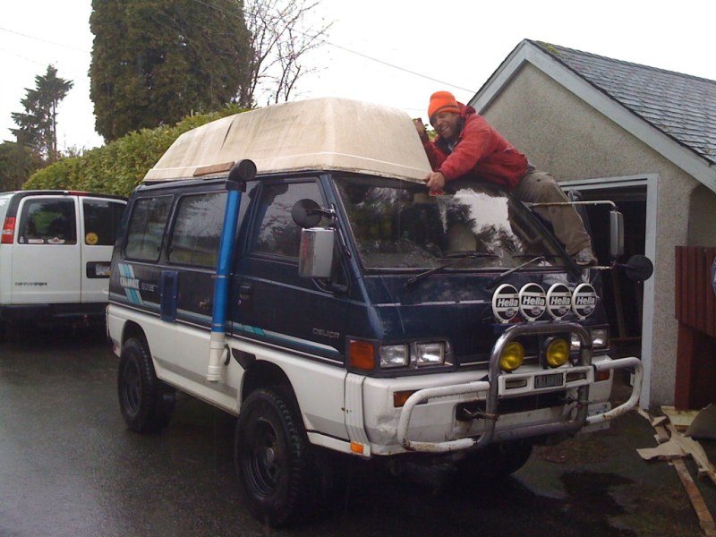

new roof is on....brought it home today (still few little things to do to make it fit)
Re: Vote for Hitop VS Poptop
It's a close fit :-D

I am going with this top because I feel it will be faster, cheaper, easier then building from scratch. Draw back is it in not tough as far as hitting objects.
Should be not to bad to fit....cut into quarters remove inches in each dimension, put a plywood strip on the inside of 2 joints hold it together with screws, test fit, adjust, glass back together on both sides (over the added plywood strips), paint. Cut van roof off (add two braces). Drop on top, screw on.
The roof weighs under 100lbs very light. It would be a great time to take a mold for producing these tops.

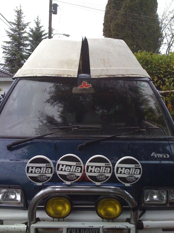

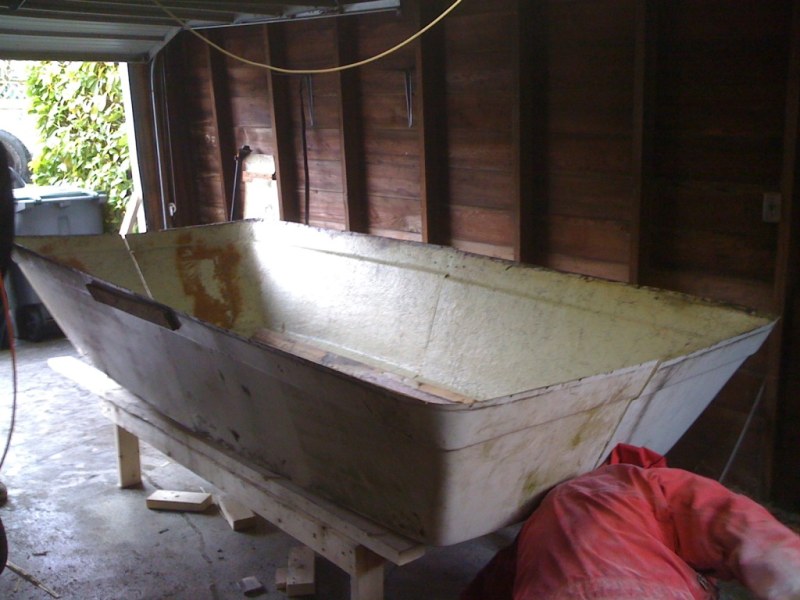

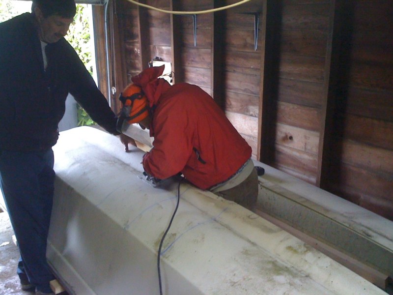

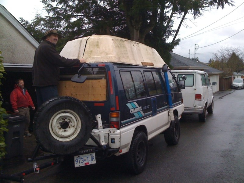

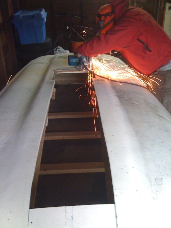

So thanks to Jay :-D and Sam :-D ...We managed to get a few hours on raising the roof.
We managed to take out 12" from the middle and shorten it 22.5". Cuts were measured form a middle line that was at times eye balled. Cuts made with a skill saw with a carbide blade (cut a few screws for fun).
Looks like we are close. Now moving onto some initial fibreglass and few official test fits.
More photos thanks to Sam and his iphone addiction: http://s902.photobucket.com/albums/ac22 ... ed%20roof/
Cutting:
Fitting:
Waiting for Glassing:
