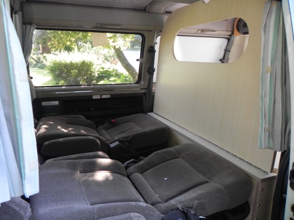

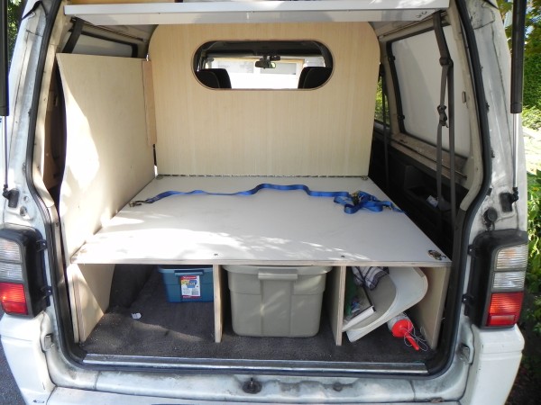

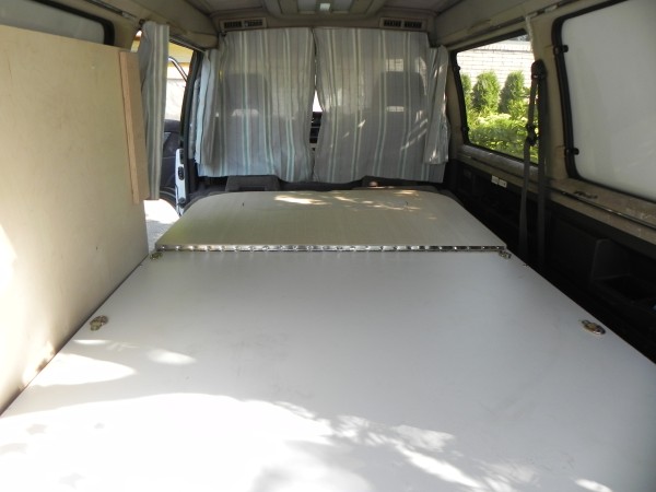

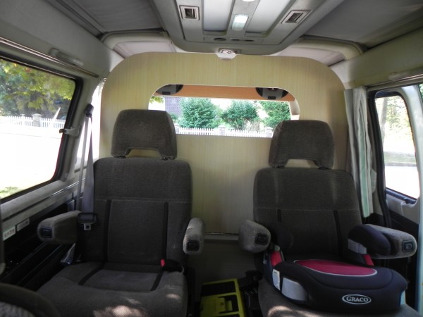

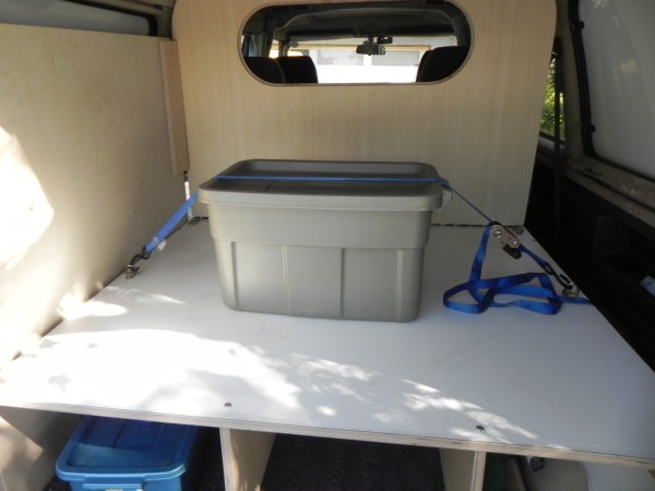

Ok, so I didn't do this today - I just finally got around to posting it. I have dubbed it the L300 Utility wagon. It is the ultimate road trip van. It still sits 4. Behind the bulkhead, there is storage underneath for 4 12" rubber made bins, plus smaller items in the third compartment. There are 6 tie downs to secure anything else above that. Fold the seats down, and the bulkhead lays flat over top of them to create a sleeping platform. And to top it all off, you can still slip a full sheet of plywood in when you need to.
I haven't finished the sides yet. My plan here is have a series of cubbies for storing soft goods in stuff sacks. I hope to finish this up over the next few months. And it's all finished in bamboo veneer over birchply. It was awesome on our Yellowstone roadtrip - everything had a place, and it made de-camping a snap.

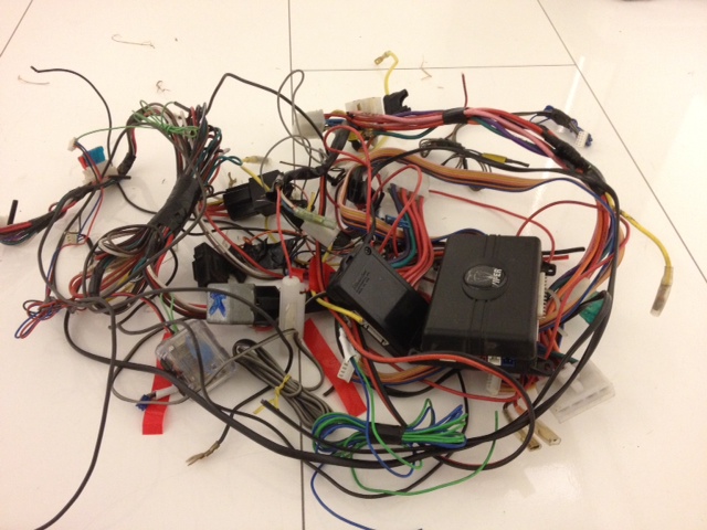

Removed some superfluous wiring from driver foot area. Yup, all of this came from behind the throttle pedal.
(Yes, I know most of it is an alarm, but it didnt work)
