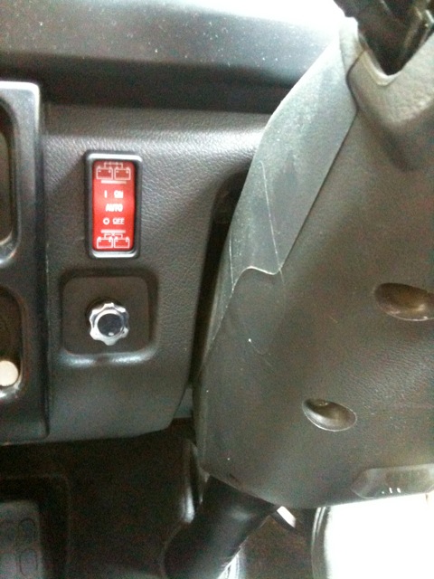

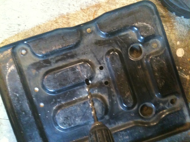

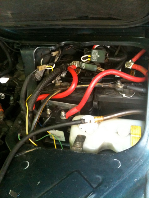

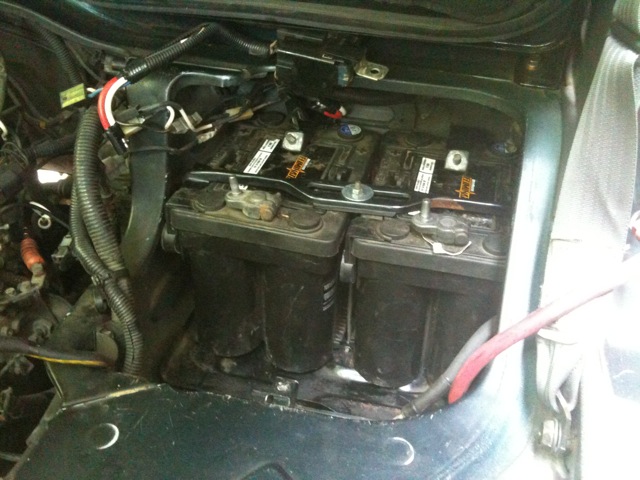

Finally some time to wire in the Automatic Charging Relay with Remote switch
Switches from auto-both batteries charge and starting battery battery is isolated from house battery loads
-both batteries together for when you need the extra juice to start in cold weather
-fully separate incase you totally drain the house battery and don't want to take starter battery with it when you next startup

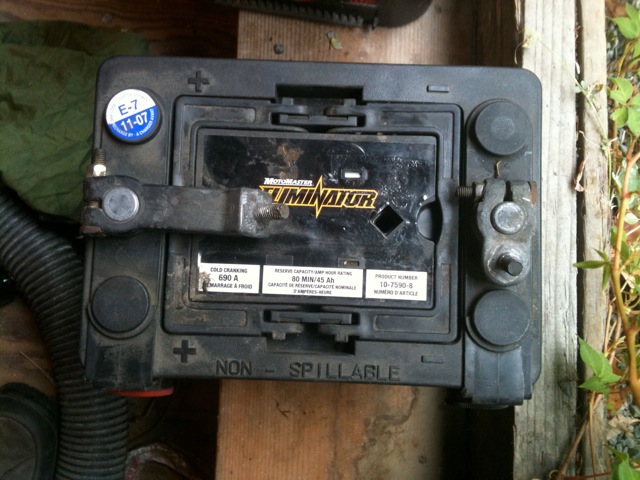

I have two crappy tire brand spiral cell AGM batteries 690 CCA
They are a bit smaller than stock so I was able to slide them back a bit and alter the hold down to get a bit of room
I also moved the coolant bottle over a bit and turned it's hold down sideways
The ACR is attached to piece of aluminum that is tagged to the battery tray and the cables basically hold it in place
I had a chunk of 1/0 cable so thats what I used, #2 would have been a bit easier to work with
The switch comes with LED's that I thought would be position indicators but they are just always on and bright so I disabled them

Very nice remote switch Rik. Cover those hot terminals!
After a few weeks with the flux capacitor in service I can attest it works as desired. I can leave the inverter on all night long without a worry. Truck starts well on a single battery.
