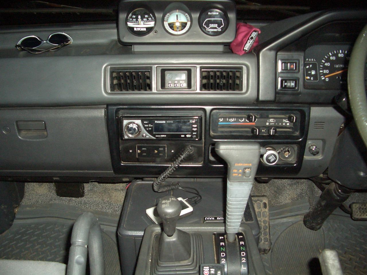

showing handy 110 volt dash outlet (inverter in glovebox)and compass in dash pod

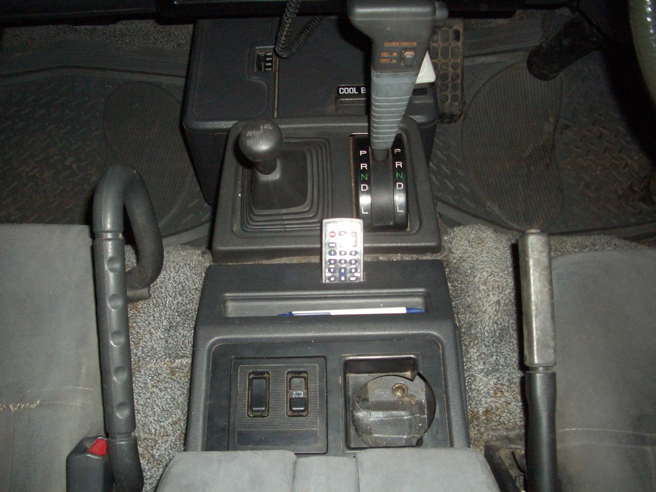

window switch moved and cointray drilled for drink holder, works great

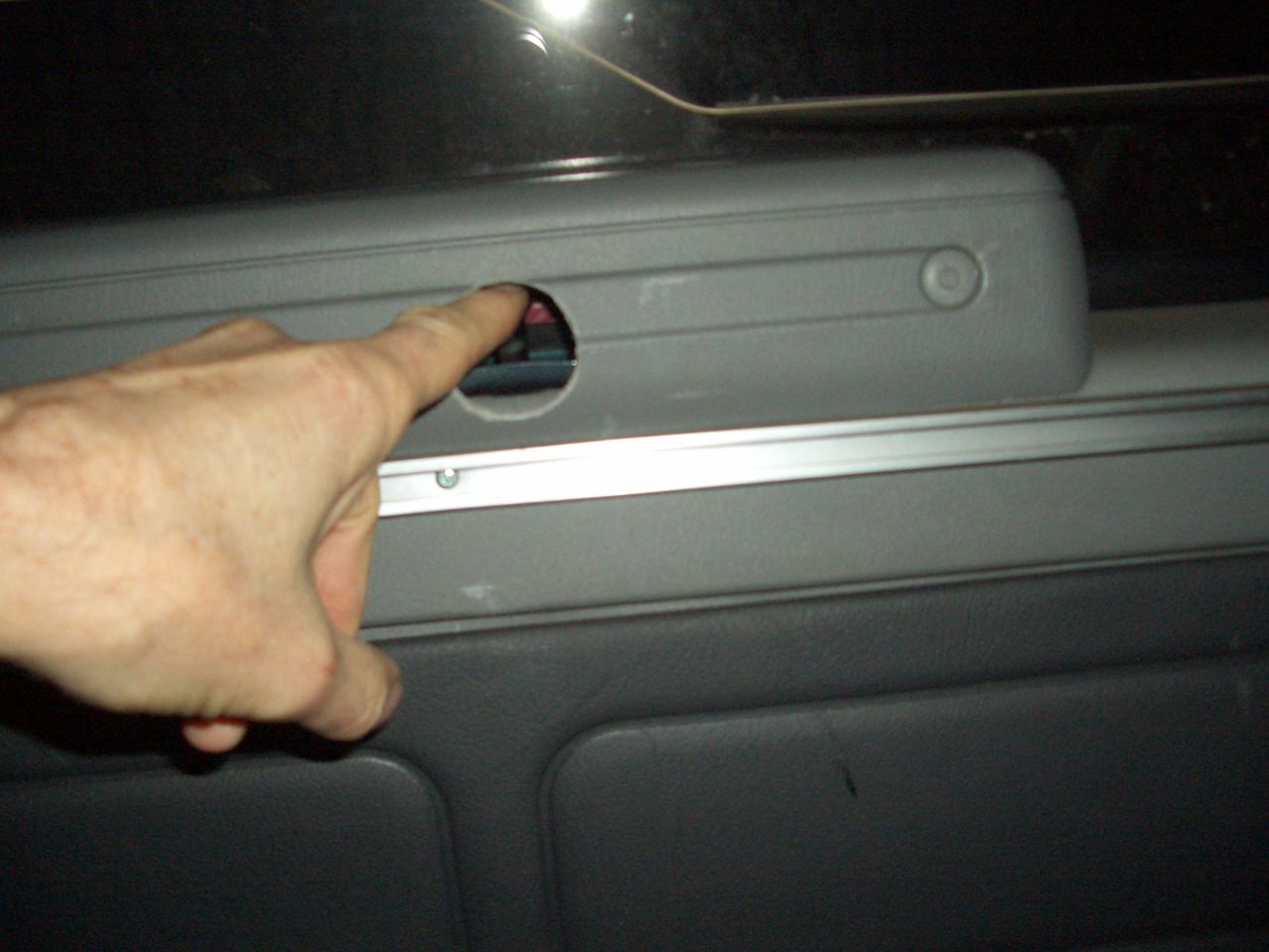

hole drilled in highmount brake light for lock access

Nice mods!
Would be even better if your pictures were a little larger to see the details... but like the idea!

What is the ampere rating for the inverter and where did you get it?Artacoma wrote:...handy 110 volt dash outlet (inverter in glovebox)...

and further to that, how well does it behave when you turn the ignition off? (I have worked with several inverters, and they all scream at me and turn off when the ignition isn't on)What is the ampere rating for the inverter and where did you get it?

Most 110V inverters WILL scream at you to turn on the engine again as a precaution against draining your battery. I've thought of putting another DC power outlet (cigarette lighter) in the rear quarter panel (like SUVs of today) for a battery pack from Canadian Tire (like this one: http://www.canadiantire.ca/browse/produ ... earch=true). Although solar, it's always good to give it a nice long charge while driving.

I don't want it to scream at me to turn the engine back on, I want the inverter to work when the engine is OFF. I shouldn't have to run the vehicle to use power, especially if I'm using it from an auxiliary battery, it's not my fault that the inverter doesn't know the difference!
Re: Noob Question
Most of them work off the charging voltage of the vehicle, which is generally over 13-14VDC. The inverter doesn't know if you're running it off an auxiliary battery or the main battery, and it doesn't care because the only thing it knows is the input voltage is less than 12VDC - thus it 'screams' at you to turn on the engine again.

which is insane, it shouldn't scream until it gets down to about 10volts... inverters power things that you usually wouldn't use while driving, so why burn fuel just so the thing doesn't scream?the only thing it knows is the input voltage is less than 12VDC - thus it 'screams' at you to turn on the engine again.

I had the same inverter problem - screamed when off and even at idle. Asked Glen to check alternator output when it was in for service. His invoice shows a rebuilt alternator installed. Never saw the van intact again ("bummer" thread), so don't know if this solved the inverter problem. The same inverter worked fine at idle and with engine off in my wife's Subaru with no screaming.
