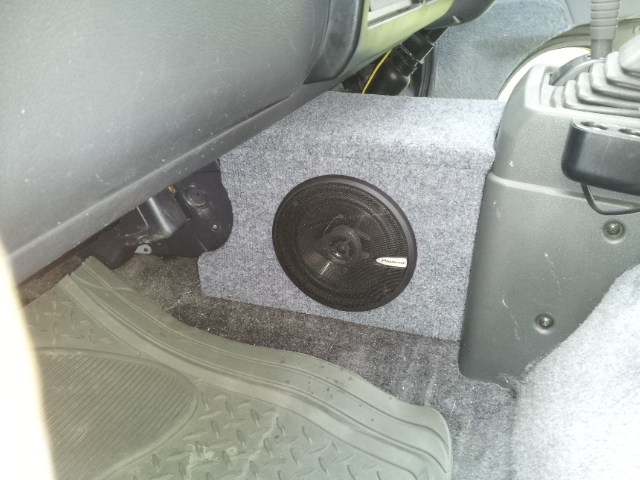

Ok so I had some left over wood and carpet plus some 5.5 " speakers so I built this
The box gives them some bass and I think keeps up with my clean theme. Not bad the platform/bed and speaker box for $100

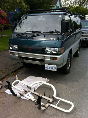

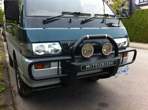

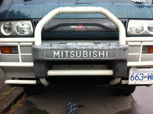

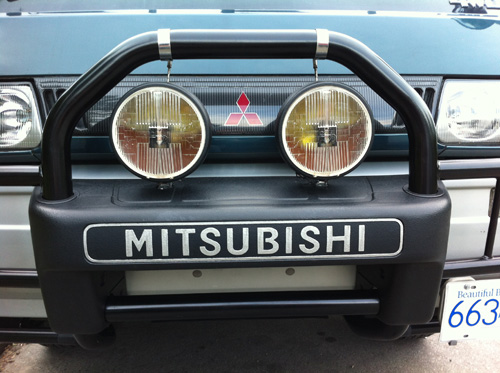

I finished powder coating my bull bars! and painted the plastic bits with Rocker Guard.
Okay, so I didn't do all this today; I've been picking away at it for a few weeks. But I re-installed the fog lamps today.

Major improvement, well done. How much did he powder coating cost?

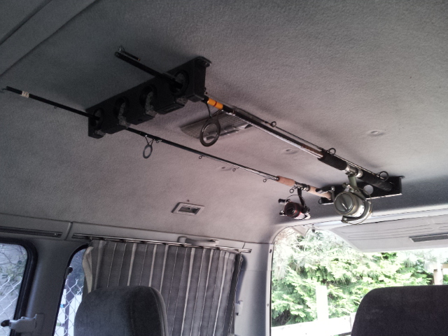

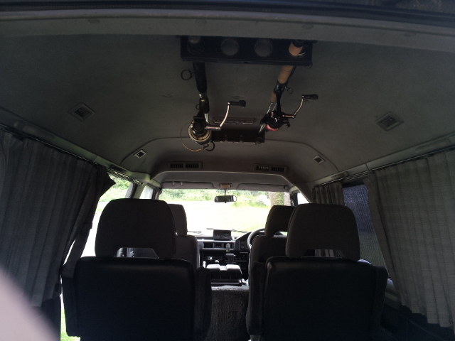

New fishing rod holder installed, not bad for $10

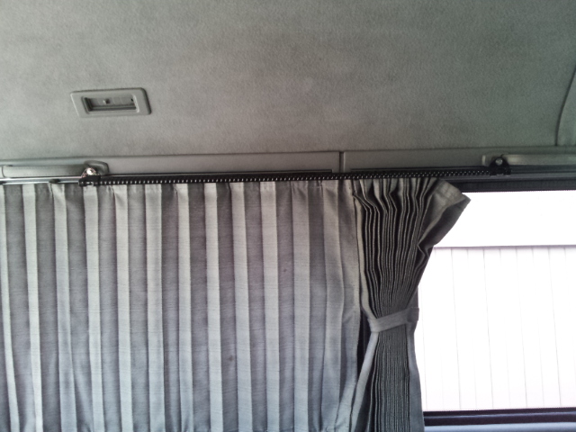

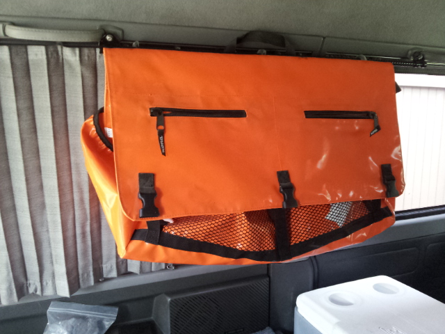

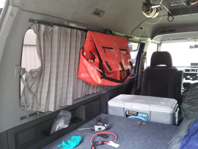

Added a storage rod for hanging my large saddle bag
Rod is made of rebar and the brackets are custom from some flat bar
The bag is for toilet paper, soap, firstaid kit, etc all lighter stuff

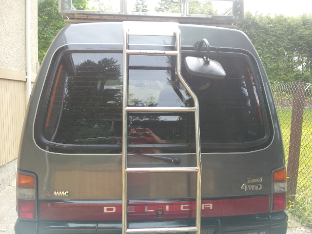

Well finally got tired of looking at the rust spots at the bottom of the rear window. So I pulled the glass and cut out the bad spots welded in a couple small pieces( I am not a body man). Then cause I did not want to paint the entire rear door I painted a 2" strip around the window and then finished it with some vinyl pin stripe looks way better than before.
What do you think
Dustin
What do you think
Dustin

That turned out really good Dustin! Looks legit.
Craig
Craig

that looks too legit to quit. Nice work.

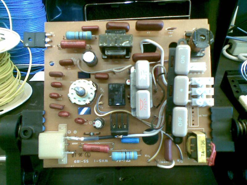

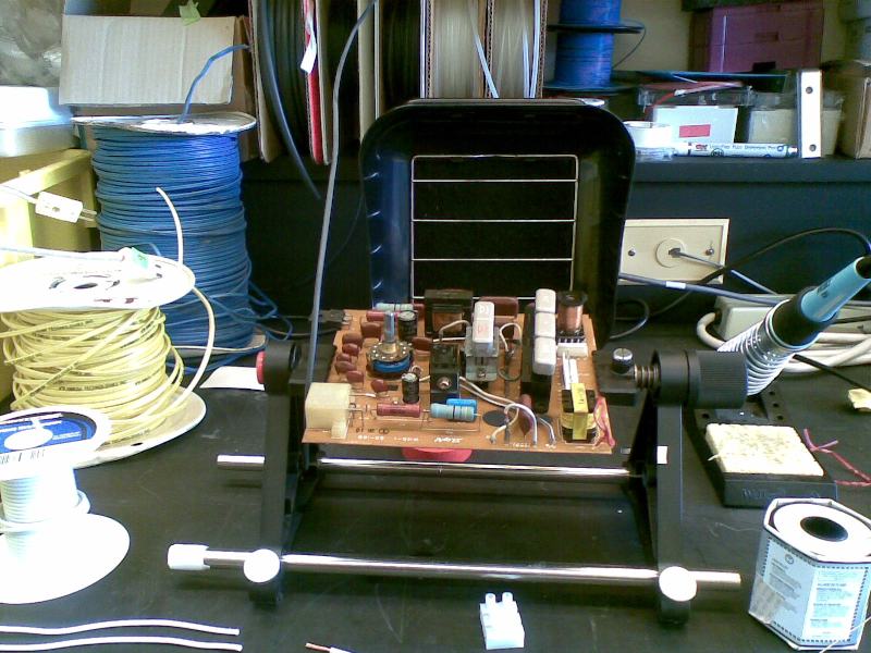

Rewired the rear L400 RED/WHITE flourescent controller to use LED strips instead of the gimpy flourescent tubes. Credit for the idea goes to Diver from his post on the UK Delica site.
The operation was simply remove a couple of the original connector strips to make room for a terminal strip. Cut + power from board and wire direct to terminal strip. Then run a - wire from each of the - terminals from the switch to the terminal strip to do the switching from sexytime red or business white. Check out Divers post on the UK site for more pictures of where to do what. I used 4 strips of white LEDs and 2 strips of red LEDs
You could be more creative and rewire to use the dimmer switch etc but I just wanted simple ON or OFF of either the white or red LEDs. Plus I only had 15minutes on my coffee break to git'r'dun.
Here are a couple pics of the mods to teh board. Pics in the vehicle to follow sometime...
