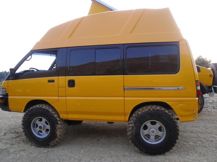

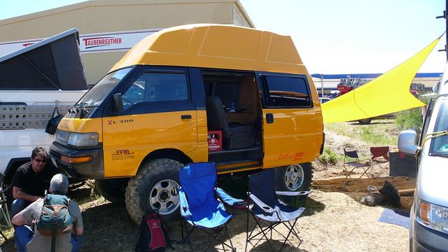

The photos are from a German 4x4 forum. I'll ask the owner if he has any photos of the cut-out roof.
No, the yellow Delica is from someone else.

There was a company in Germany, which made hightops for l300s. As the they closed their doors, ebay was full of these fibreglass tops. For less than $100..... but that was a few years ago 8-)

i've always been in awe over this yellow bus. wish i could find more about it and what the owner has done to it.

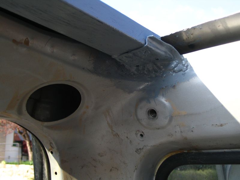

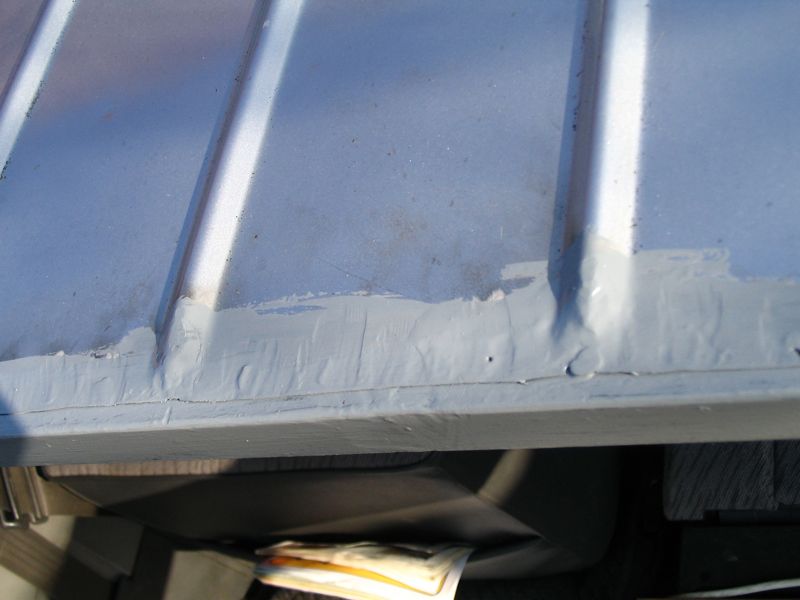

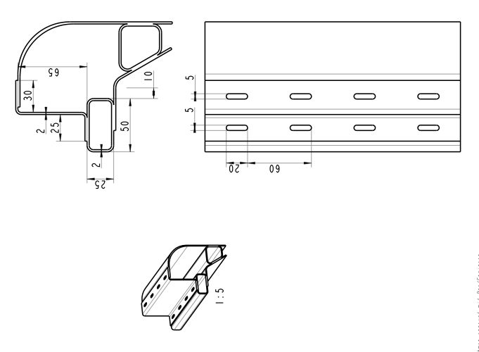

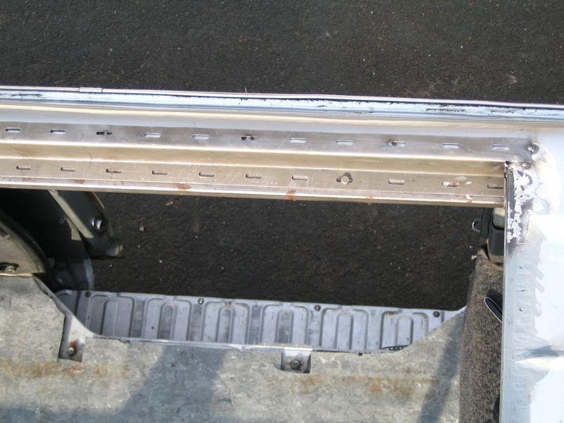

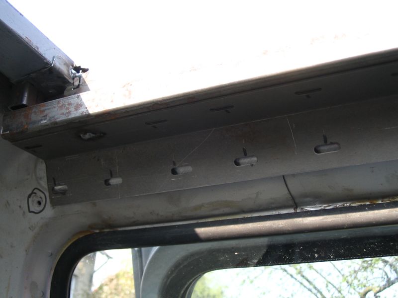

Re: Vote for Hitop VS Poptop
Post by fexlboi »

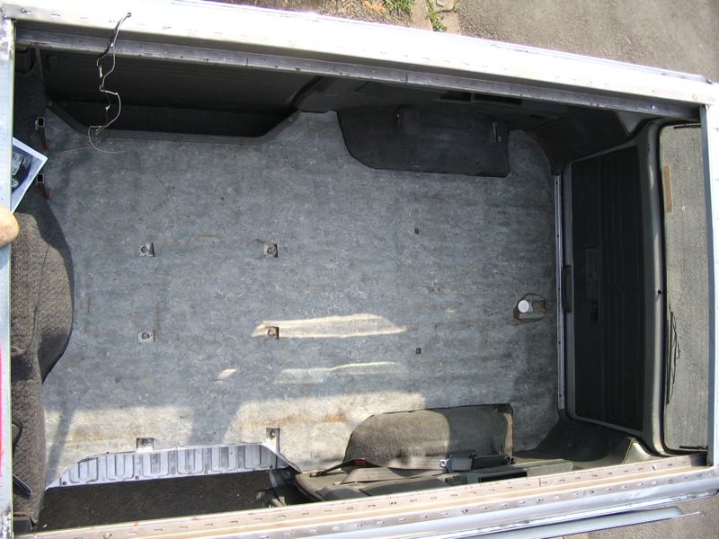

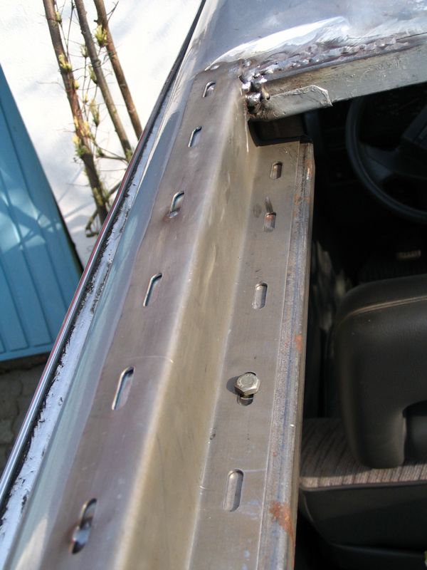

Here you go, hope this helps with your project...
Screen shot 2011-01-10 at 21.49.02.jpg (34.28 KiB) Viewed 5120 times

That is Awesome, Thanks!!!

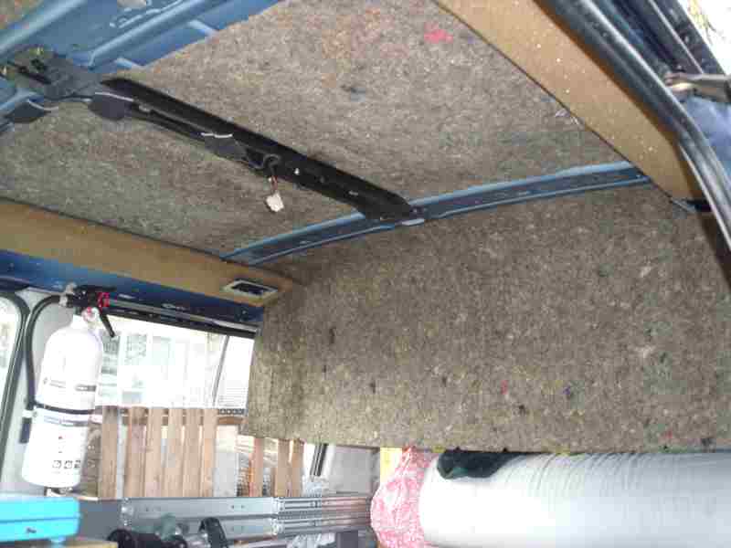

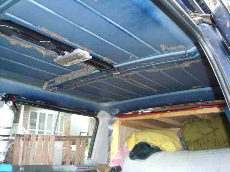

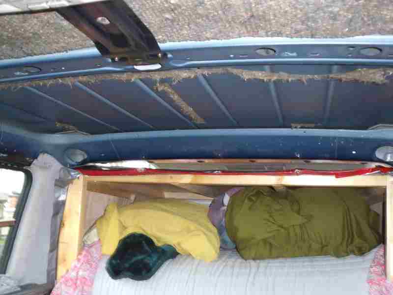

Post by thedjjack »

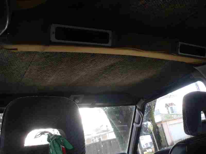

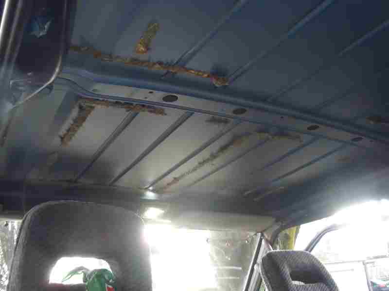

Pulled the Headliner today.....The official start!
