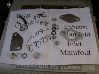

This is a kit I picked up on a group buy from Delitan
I am pretty sure both plates are 1/8 stainless steel.
I can measure the plates and the bolts tomorrow.
I can source the gasket from Lordco I am sure
and post the part#
