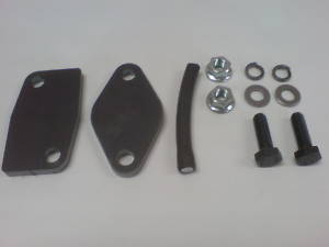

The kit illustrated above includes an EGR valve blocking plate, an exhaust blocking plate. It is 1/4" (6mm) thick. It defeats the EGR (implying removal) in the 2.4 L300 and 2.8 L400, Pajero engines. It is thick enough to support a pyro probe mount.delicat wrote:Not sure if you're aware but you don't need different design for the 300 or 400. The 300 style fits both perfectly. [...] You could also consider the option of doing the exhaust blocking plate which would need to be around a 1/4" thick.
I have submitted the drawings to CNC machinists around the lower mainland, as well as in the US. I'm looking for more machinists, and I've PM'd everyone who has mentioned that they can do or know someone who can do the job. I welcome any leads you have on machinists who might beat the quotes I've got right now.delicat wrote:And $40 is a bit steep, it might be worth checking with other machinist... I've used one for my lift kit that was very decent and I'm sure Jesse could direct you as well.

The kit is the SAME for the L300 2.5 4d56 engine and the L400 2.8 4M4O engine.Are the specs above for L400 blanking kit?
THE SAME! ok?
6mm IS close to 1/4 inch (0.2362204724409449 inches)
Around 40bux is what I paid too.

K, this is the kit I mentioned above. Sourced through Google ---> Ebay ---> moderator over on Delica friends (http://www.delicaownersclub.co.uk).
contents: Removal kit consists of:
X2 6mm Laser profiled high grade steel blanking plates
X1 Rubber vacuum blanking pipe
X2 High tensile M8 bolts
X2 BZP M8 flanged locking nuts
X2 M8 spring washers
X2 M8 flat washers
Full step by step fitting instructions with colour guide
Here are the numbers offered:
Qty 20 £150 inc shipping with DHL,Total of £7.50 each shipped ($12.08 can) or
Qty 1 £13.87 inc shipping ($22.34 can)
Seems to be a hard offer to beat.
I am looking for someone in Vancouver (assuming most interest by volume) to carry this through as I live on the island and would add to the shipping cost. If interested, someone PM please and I will get you in touch with Mark.
