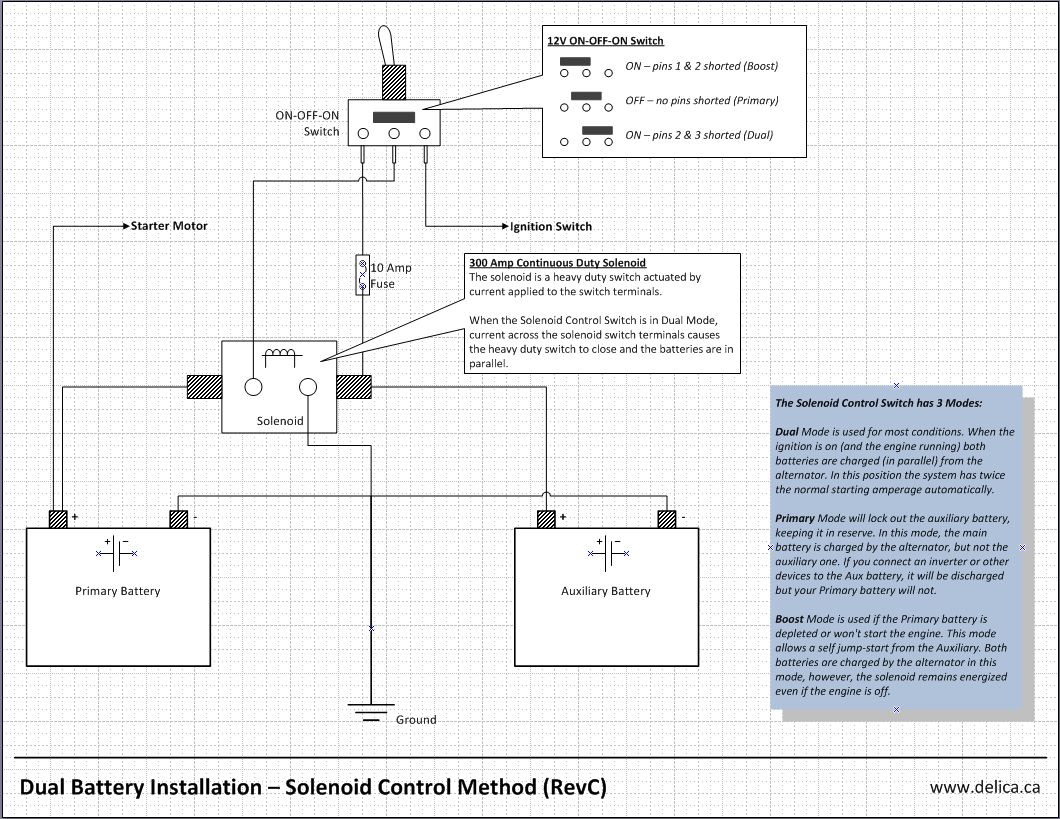

can you post a simple schematic ? Does the solinoid just go between the batteries on the positive side?
http://www.powerstream.com/z/iso-inst.png
Found this schematic online , it seems to make sense
If using a solinoid would it replace the isolator shown? and does it also come with a bypass switch or is that a seperate function wired in with additional stuff?

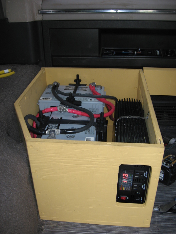

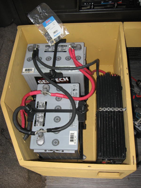

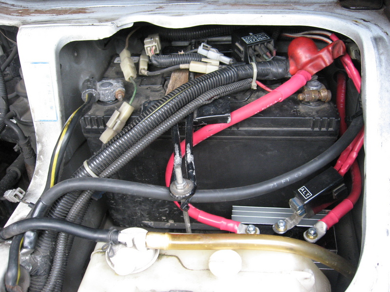

just finished wiring in two batteries and a cheapo cantire 1000w sine wave inverter.
made custom wires, #1 wire from the alternator and #2 to the inverter.
also see the 300 amp fuse I plan to bolt onto battery + terminal to inverter.
ok going back out to wire in the fridge and bed lights....

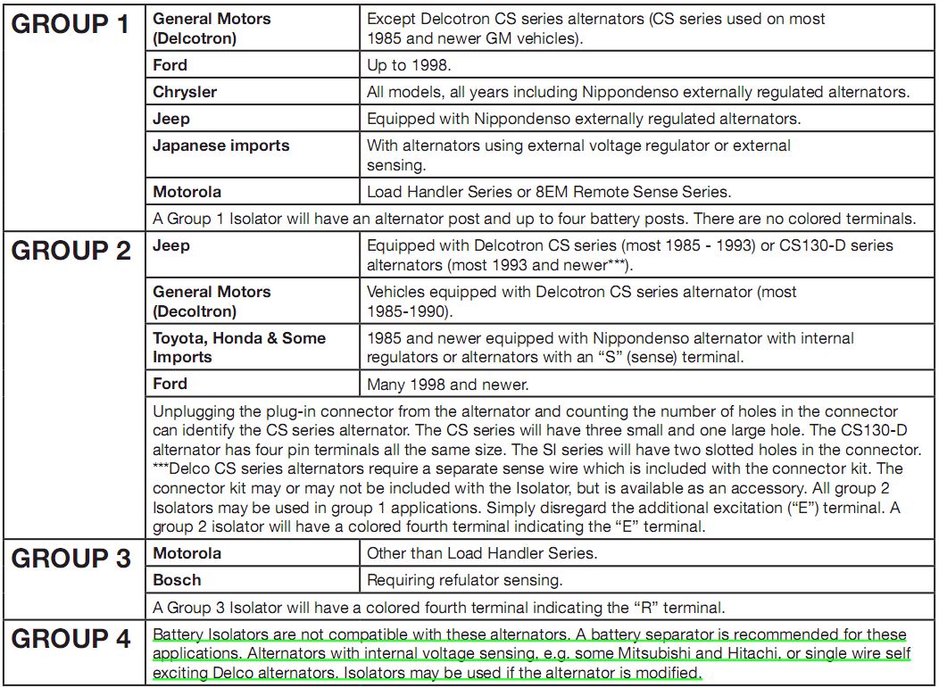

Reading the manual for the isolator:
Note the warning about "some Mitsubishi alternators" with "internal voltage sensing".

Based on Jay's sketch, I made a digital diagram with annotations (edit: updated per Jay's comments):
Dual Battery - Solenoid Style

Rich has done a beauitful job on cleaning up my drawing. But the solenoid should be at least 275 Amps for starting (not 100A as in the above diagram). Cheers, Jay TardisDeli.
Hmm yes I sized the solenoid based on the charge circuit (85A) but you are correct that when cranking the starter from both batteries in Dual we'd typically have half of the cranking load across the solenoid, and potentially all of it in Boost mode. So a 300A would be ideal.
Note: Updated drawing above.

Thanks Rich and Tardis
I think I can source the parts here in Vic , I'll probably have a question or two once I get it all together.
Great drawing Rich that belongs in the wiki archive

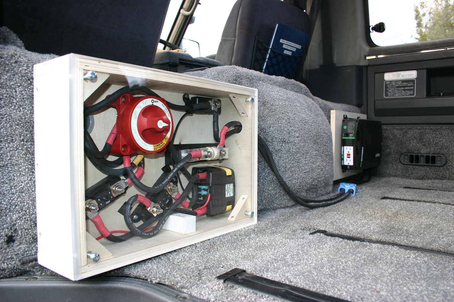

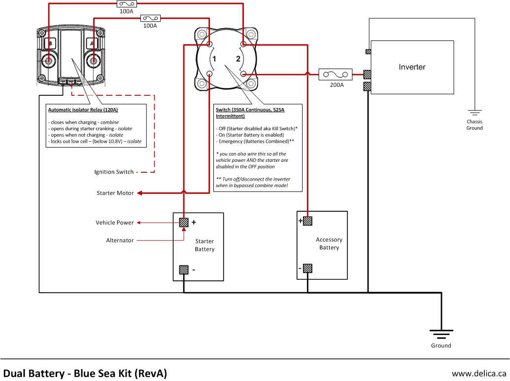

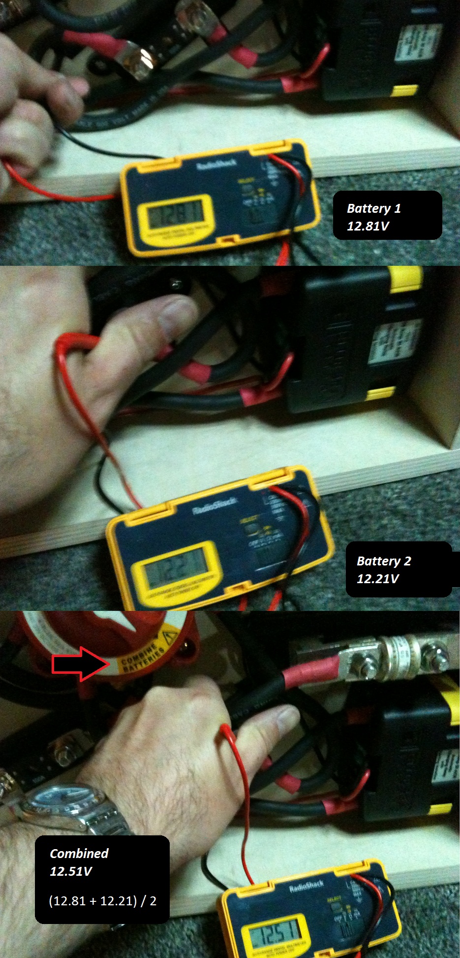

Okay so I have been working on this in the past two weeks and here is where I'm at:
* Automatic Isolator Relay/Charge Controller
- Automatic combine when charging
- starter isolation so you don't blow your inverter (triggered by ignition switch)
* Main Power Switch (Manual Override for emergency starts)tart
* dedicated cabinet behind the battery compartment
Blue Sea Add A Battery Kit
Dual Battery - Blue Sea Kit.jpg (173.76 KiB) Viewed 5205 times
First test of the automatic isolator:
- start the truck, voltage goes up to 13V (alternator is spinning). Not quite high enough to trigger the relay.
- turned up throttle to 2K RPM, voltage increases to 14V (alternator is spinning FASTER). 30 seconds later, the relay actuates and the Combined light goes on. Both batteries are charging.
- turned off engine. 30 seconds later, the relay opens and the batteries are isolated again.
Flux Capacitor is online
I like this photo set because its sort of like proof that your primary school math teacher didn't lie. (Note: this was taken with the engine off. The automatic isolator is open.) When you manually combine the batteries, you end up with the average of the two cell's voltage.
