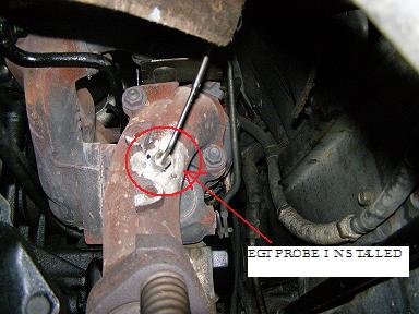

Thanks for the reply,
My EGT is probe is mounted as shown below.Thanks for all the input.I think that the numbers I am seeing are most likely fine, Hitting 1200F going up a Aprox 10% grade at 85K with 5 passangers and a full tank uf fuel now seems with everyones input "Normal".I thing to be safe any time it hits 1200F I will ease off the accelerator and let the temp drop.I will now watch the temp when I shut down as well,t allow the turbo to cool (Great Idea).It going to be interesting to see how the Exhaust mod makes a difference.
Thanks again and...
HAPPY NEW YEAR!!
