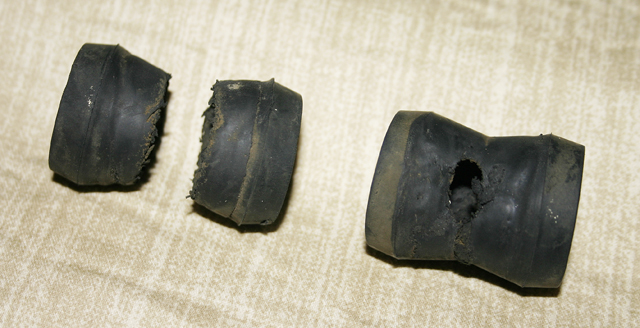

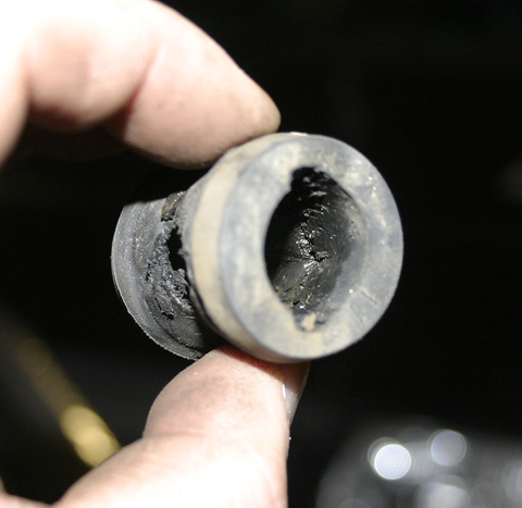

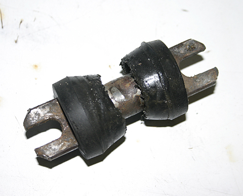

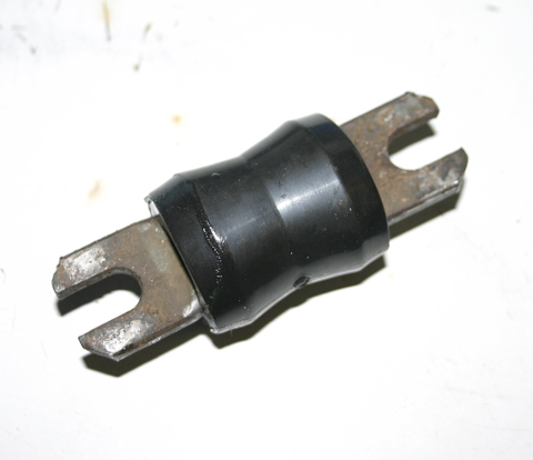

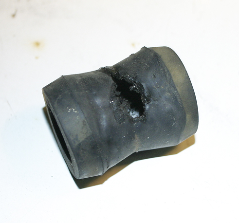

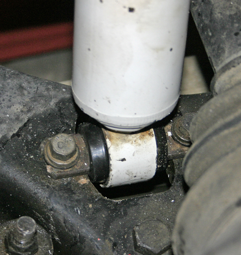

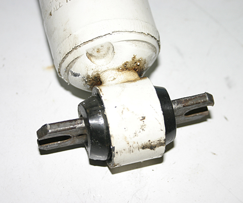

I do not argue with the fact itself but with the terms. In my case the original bushing in ProComp 9000 lasted for about 3.5 month. This is unacceptable.Everything is subject to wear and tear.
I was not given this option and I never heard about a 'known' issue.That is why you have the option to buy poly bushings. Most retailers recommend poly's over the rubber because of this 'known' issue.
Anyway, thanks to Mardy who gave me poly bushing I am ready for offroading again. Below are some pictures to give you an idea of what happened to the original bushing within a few month and how the replacement looks like.
The bottom line. If you are buying ProComp shocks you must buy polyurethane bushing or you will enjoy wasting your valuable time reinstalling the shocks a few month later again with new bushing.

Re: Warning! ProComp shocks problem
Great photos Sergiy and tks.
Agree that the mfgr should never have used a product that wouldn't last for even a few months.
