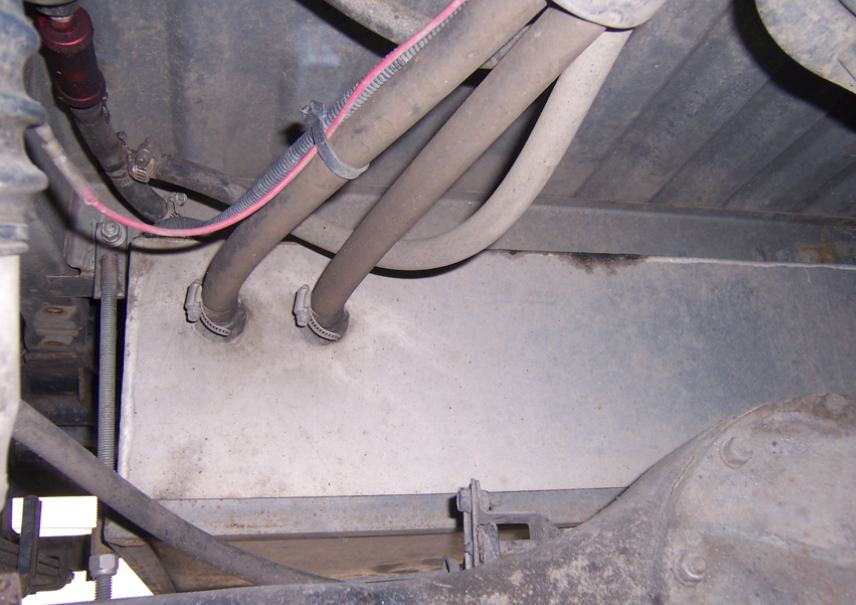

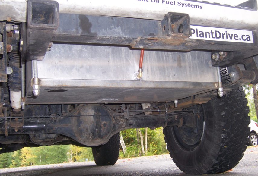

Guess I should update this post seeing I've changed my initial tank system for a single aluminum tank.
Reason were that the breating/venting for the dual tanks wasn't that great and that the tanks started leaking (bad welds). It wasn't also the best system to refill on the road unless I ended up buying a 12V pump...
I've posted about this new tank in another post but seems appropriate to put it here as well.
So got Andrew to weld me a tank and also got him to modify the sight tube (handy when filling), the coolant entry/exit location for the heated tank, added a drain plug and the fuel pickup so that nothing was hanging low and also avoid having crap making it's way into my fuel lines.
After close to 20 000km using this system it's been working amazingly well and would recommend it to anyone.

glad to see its working well for you delicat.
and thanks for 'the tour' of your vegoil facility! :-D :M

hi there would u have the measurement of the big single tank in the back? im trying to collect bits for my conversion and i wonder how big a tank i can fit in there, sorry being lazy its all windy, wet and muddy outside at the moment :-D
