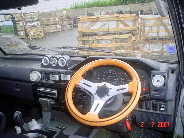

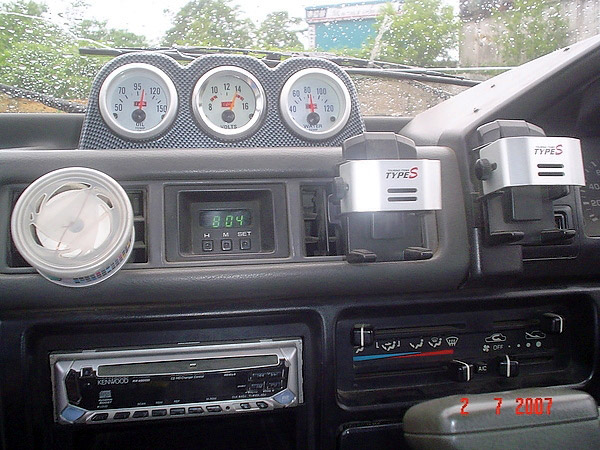

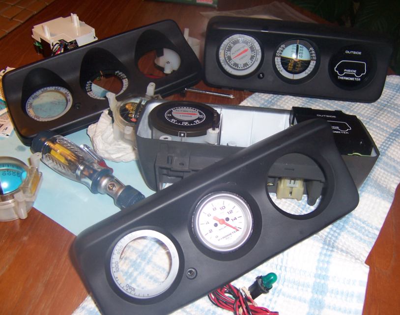

I'm going with Garyo's style. I was going to put it below the stereo but din't like to have it hidden down there. I prefer to have it "in my face". And that inclinator kept leaking on me so good excuse to replace it. I'm keeping the altimeter 'cause I probably use it more to tell what's coming weather wise than my altitude. The in/out temperature gauge is staying for now but might get replaced with a boost gauge, not sure yet. I've properly set my boost now (from 7psi up to 12) so I'm happy for now.
The gauge is a Autometer model 4344 (2 1/16"), you need to trim a little of the faceplate to make it fit in that whole but fairly easy.

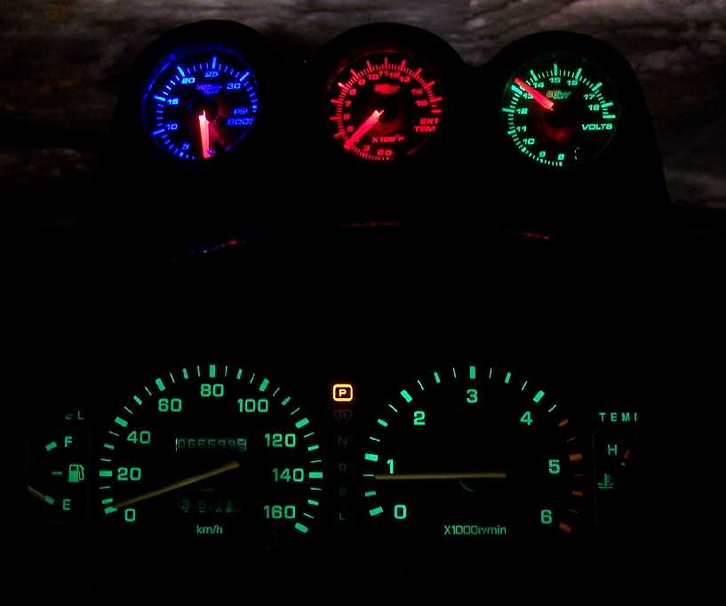

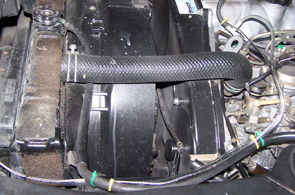

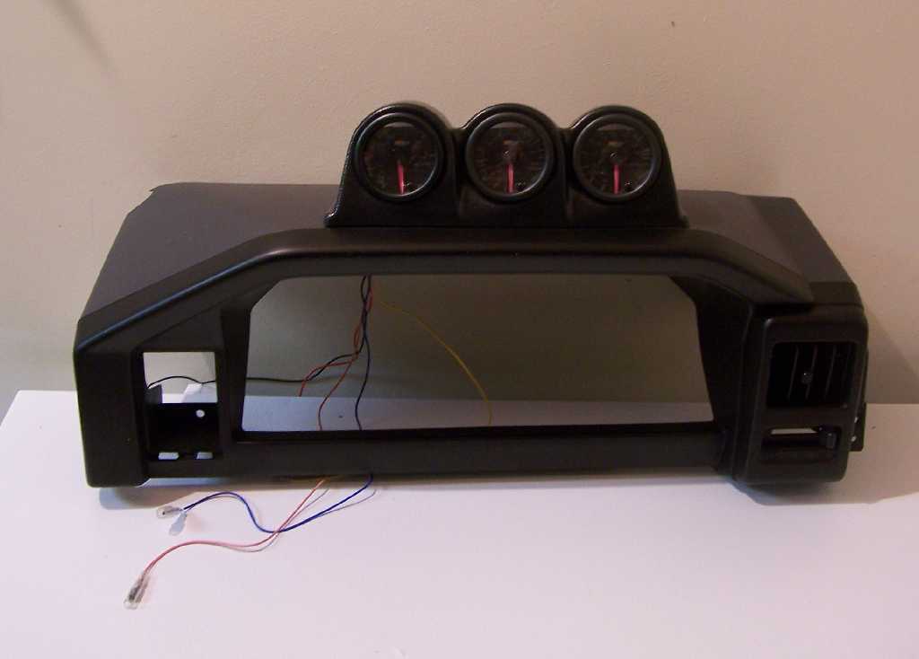

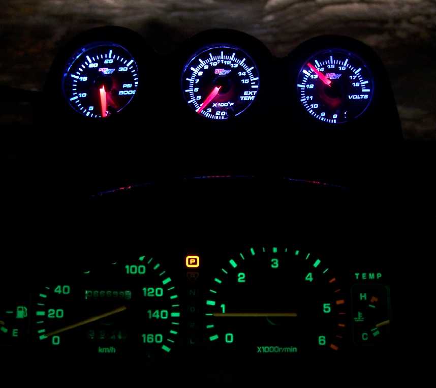

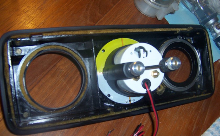

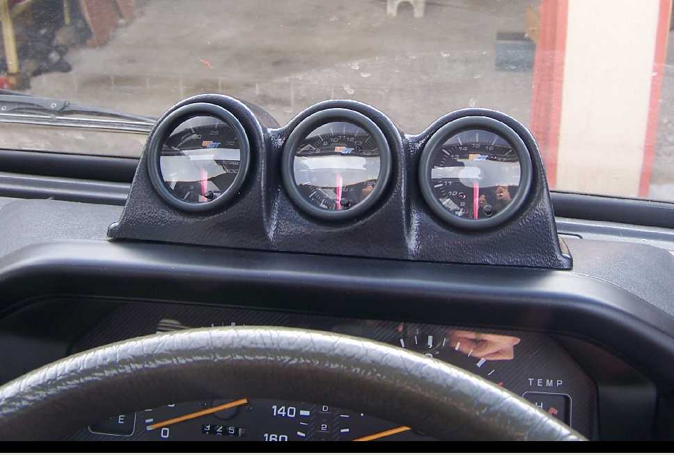

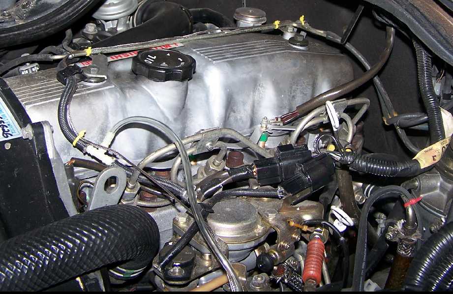

After 2 months of research and install options I finally completed my gauge install. The most time consuming part was gauges and gauge location. The gauges I chose were Glow Shift with a black face. I chose the black face to get the Pyro with a 1600 degree span. I installed a volt meter, boost gauge and pyrometer. The gauge options I reviewed included Autometer and DiPricol. The DiPricol is likely the best as it offers LED illumination c/w a dimming wire to the instrument panel as well as a built in Potentiometer to set the illumination comparable to the remainder of your gauges. Autometer has an LED option in their catalogues but they are difficult to get. The Glow Shift were basically purchased on price as I could get all the gauges for little more than the Pyro from the others. ( You get 10% off by using the Coupon Code: 08Shipping.) In addition, they can be changed to 7 different colors @ any time using a button on the front. The gauges seem to be reasonable quality but DO NOT HAVE A DIMMING lead. In the case of the Delica this doesn't matter as the dash lights don't dim. I think by choosing the right night color this won't matter much.
The gauge Pod looked like a great idea on the web page but when it came the gauges were pointed a little to the left, as would be nice if you had a LHD vehicle. I used it anyway but did the install with 2 sided tape and velcro to keep my options open if I find the angle bothers me. I do like the location as it is very easy to see movements and I was surprised how fast the pyro moves and how the boost is almost always on at highway speeds. The voltmeter is great to watch glow plug operation.
The install was fairly straight forward. The location chosen for the pyro install was based on ease of access and I know that it will read low compared to closer to the turbo. This is easy to compensate for. The boost just Tee-ed into the boost hose on top of the engine. The voltmeter and lighting was picked up from the radio connection as it was the easiest access point.

Great looking install and pics, lrp374. Do you find that the gauges block much of your view being mounted on top of the dash like that? Where did you purchase the guage pod from?

The Pod and gauges come from www.glowshift.com as Jessie indicated. The gauge location doesn't bother vision ,unless your very short, you only look out the top half of the windshield.
