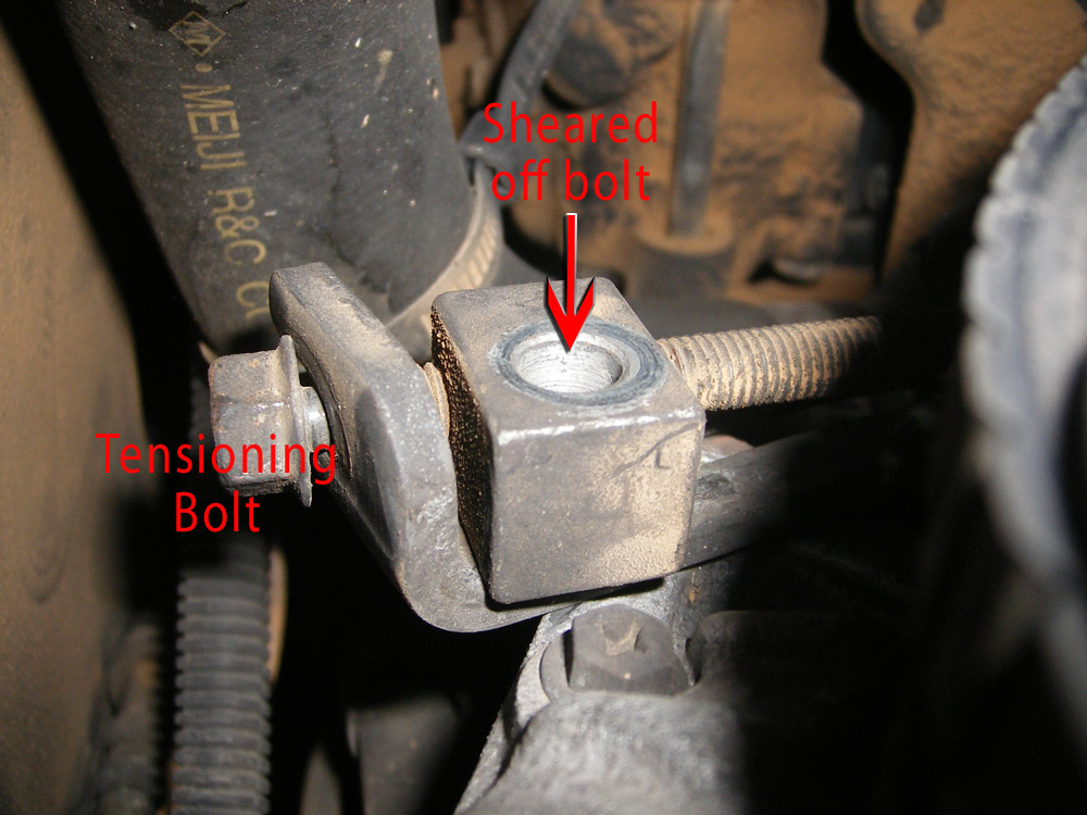

Thanks for the offer Kevin :-) It'd be great to have some in person technical assistance, but lacking that the forum suggestions are really helping. It looks like the tension is out on the alternator belts, and I found a sheared off bolt when I removed my skid plate, check it out:

Well I think I found out where the sheared off bolt is supposed to go. It looks like it is supposed to secure the alternator to the tension bolt slider (btw I'm just making up these terms as I go). Here's a shot of what it looks like:

OK, just got off the phone with Kevin and he had the same problem. He told me I can drop the alternator from underneath by removing the pivot bolt and disconnecting the wires. Then I can dig out the other 1/2 of the bolt from the alternator. Here goes....

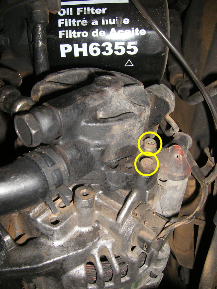

So, do you think I need to unscrew what looks like and oil pump from the alternator before I can pull it out? Otherwise it looks like I need to disconnect some oil hoses which could be messy. Here's a shot of the screws I think I need to remove to separate the black oil pump (??) from the alternator. Any suggestions?

Oh yeah, there's more then those two 10mm bolts holding it on. You can drop it with the alternator, plugging and undoing the oil lines. I just unbolted it and pulled it straight out carefully, wrapping it in a clean rag to protect it. The shaft for the oil pump goes into the alternator, and surprisingly not much oil drained out with it.
Forgot to mention that.

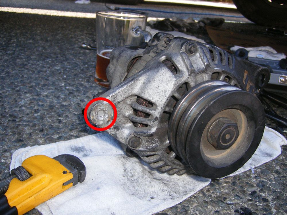

Fixed it. Thanks for everyones help, especially Kevin for having the same problem previously and knowing how to fix it :-) I finally disconnected all the oil hoses going to the pump and pulled the alternator out to remove the sheared off bolt. Here's what it looked like:

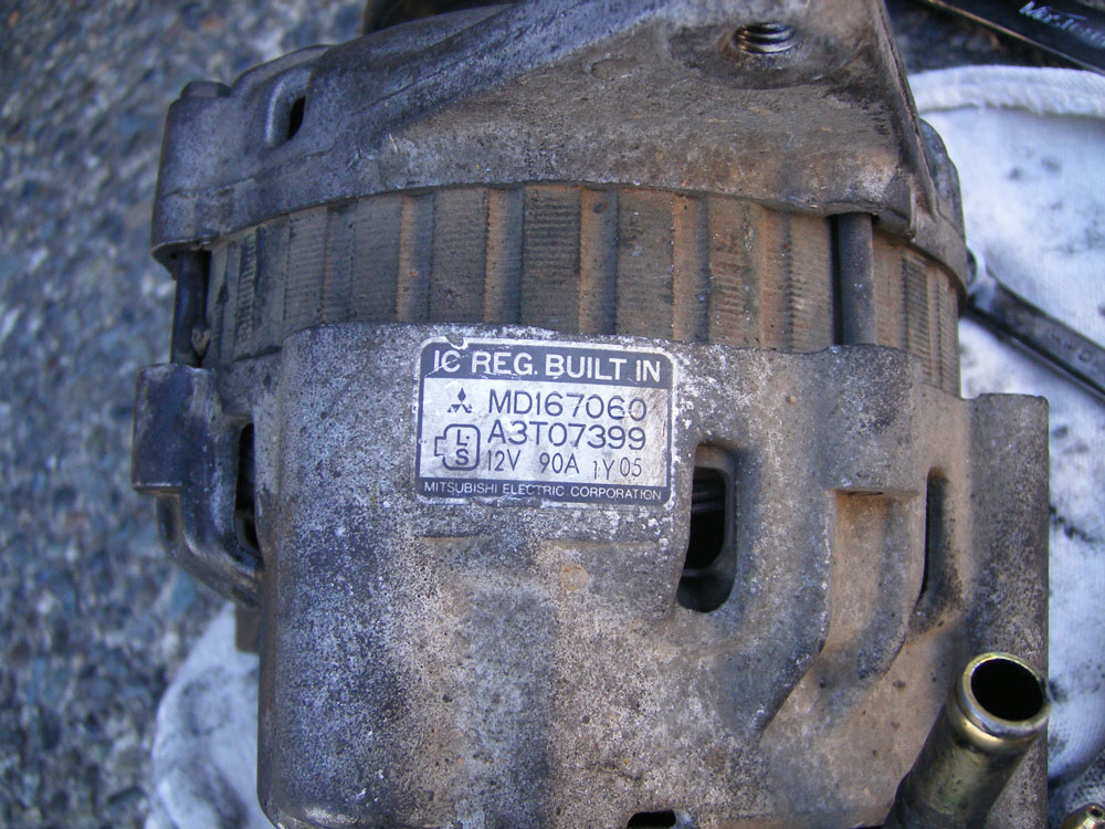

Finally I have validation that I bought the correct version of the VegTherm.
The Mega, which I bought, requires 90A, but at the time I made the purchase there was a debate as to whether the Super Exceed had a 75A or a 90A alternator. I guess I made the right choice (thankfully).

Great news!! (Love the mug of beer in the background :-D) Well played Adam, Kev, and the others who offered help. The Delica Canada web forum chalks up yet another victory!! :M :-D
