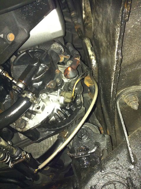

Hmmm... just found this.
- Altwire.jpg (76.01 KiB) Viewed 6467 times
It appears to be a disconnected ground wire coming from a cluster that hooks to the alternator. It's actually black or dark grey.
Can anyone confirm where this is supposed to be connected?
Thanks,
Shane.
Re: very wierd electrical problem
Posted: Sat Nov 19, 2011 3:14 pm
by RichD
The alternator is grounded (-) to the chassis, there is a 4 gauge hot terminal (+) and a connector terminal (2 pins IIRC) that goes to the regulator. You can see these are both connected in your photo.
Posted: Sat Nov 19, 2011 3:21 pm
by nishby
Thanks. I'll re-attach that ground and see if any of my mystery is resolved.
Posted: Sat Nov 19, 2011 7:11 pm
by nishby
Problem solved! The trailer wiring converter shorted out and sent a chain reaction through the system. DRL is fine. Everything is functional again except my fried inverter.
