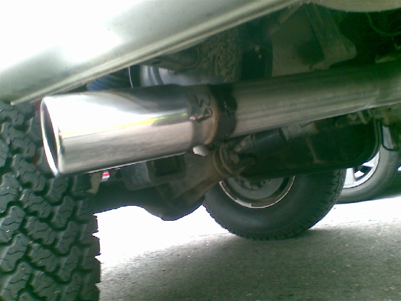

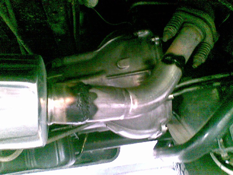

I just got mine done at the same place, Quiet Muffler on Kingsway.
Mine came out to $369 tax in.
$70 MORE than David's for exactly the same thing.
He said David's was an 'experiment' and that they charged less labour on his then what it should have been.
I needed it done (muffler was coming apart) otherwise I would have shopped around.
Anyways, the welds are 'o-kay'. Sloppy in my opinion.
I'm going to install a pyro probe up in there and will clean up the weld from the downpipe and eliminate the 2 - 2.5" diameter bottleneck at the flange when I have some more time.
Jesse

Funny how they never told me mine was experimental... I'm curious how much they'll charge me when I go for my 2nd van!
If I had been in your shoes Jesse I would have been tempted to just walk away so they don't get away with charging more. But now you have a nice exhaust and life is good, just poorer!
Enjoy!
David

Yeah. I needed it done as driving around with a Delica sounding like a tank would have attracted the fuzz.
Time and place was convenient so I bit the bullet.
With that said though, I would definitely recommend to take your van to another shop or two to compare.
I've seen much better pipe welding than this at common muffler shops.
It's quieter and smoother on acceleration which is what I was shooting for.
Highway will be nice.
