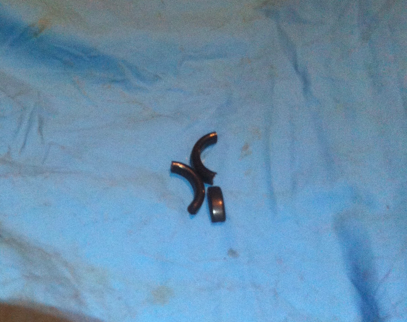

Fingers crossed the re-seal will make an improvement. this is what the bottom pressure regulator o-ring soon looked like:
Very brittle and loose, although still intact, after pulling the regulator. I replaced all the rubbers in cluded in the kit. And am reassembling with cam seal, belts, tensioners. At negative 20C. Bleck.
