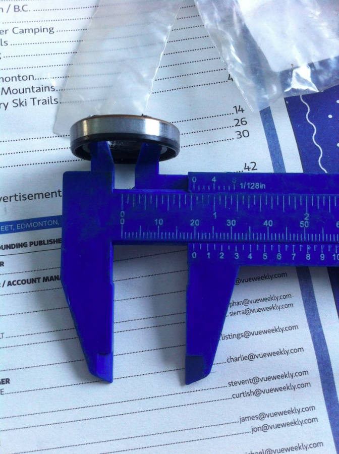

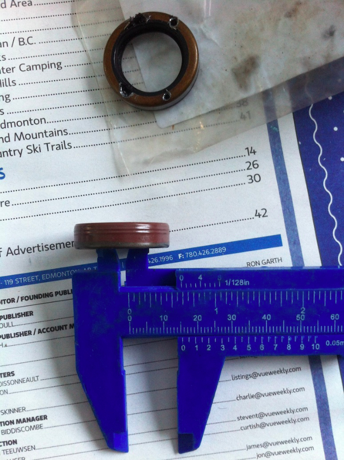

Bosch 2 460 283 001 is sitting nicely in the seal bore, but is for a bigger shaft according to http://www.hansautoparts.com/TDIFRontSeal.aspx
no surprise it leaks just as bad if not worse then before. So neither of the seals I acquired were correct; the 17mm did not fit the bore (and seemed to me rather tight on the shaft which is why the "better"' fitting 2 460 283 001 lead me to think I had the right thing. It's supposed to be really tight fitting over the shaft, I gather.

I think more importantly what lead me to think I had the right seal was that the Bosch 20mm seal matched the old seal I'd pulled from the pump. What I was told was a 17mm ve seal required a determined effort to fit over the shaft. Perhaps this was a correct shaft fit and what had been in the pump was in an incorrect seal, as it did not look particularly worn. or may be what I"m pretty sure is a drive shaft leak is due to wear in a bushing the seal cannot accommodate? Says MD171459 on pump which according to your contribution elsewhere, Growlerbearnz, this is a standard pump (if the number being off by one unit is o.k.).

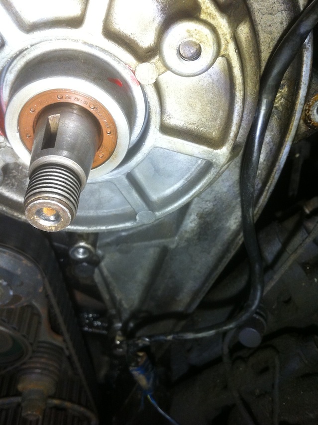

Can see in the image the diesel drip path where wash lines are left even after my cleaning of the area. This is the bosch seal installed 1500k prior.

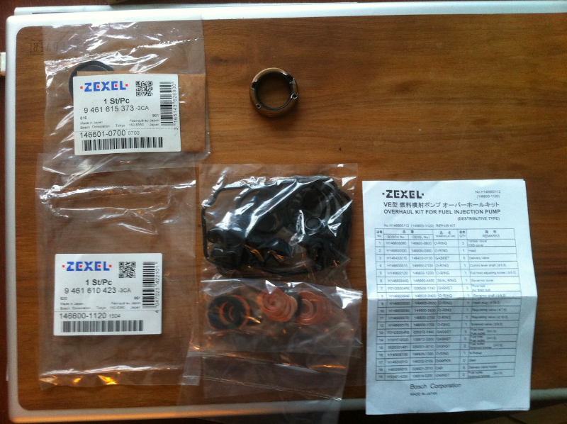

The zexel seal does not have the rubber coating. See the old seal in the picture and my butcher job while removing. I may very well have done damage to the seal bore during its removal and I am interested to know what can be done to get the best seal at this point. A special sealant? Since I'm taking the pump off and attempting the re-seal myself, I'd like to know what is an allowable movement in the driveshaft. I see on web some VW discussion about .2mm

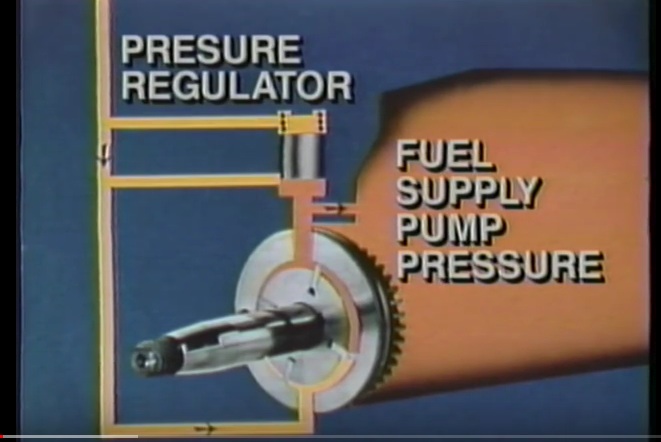

If the bottom o-ring on the pump's regulator valve were hardened to the point of failing to seal pump body fuel pressures (up to 100psi?), or if the regulator were stuck in an open position, would you see pressure build up on the low pressures side, which might perhaps contribute to leakage at a front seal?
I took out the valve and had the 0-ring split in two. Hardened seals a plenty around the pump. First time going deep in the IP. Wish me luck!

That's an interesting idea, and you might be on to something there. The shaft seal's just a regular rotary seal, it can't cope with too much pressure. If for some reason pump body pressure could make its way to the inlet side of the pump I would expect it to leak.
