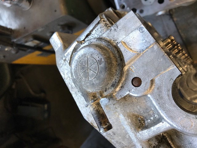

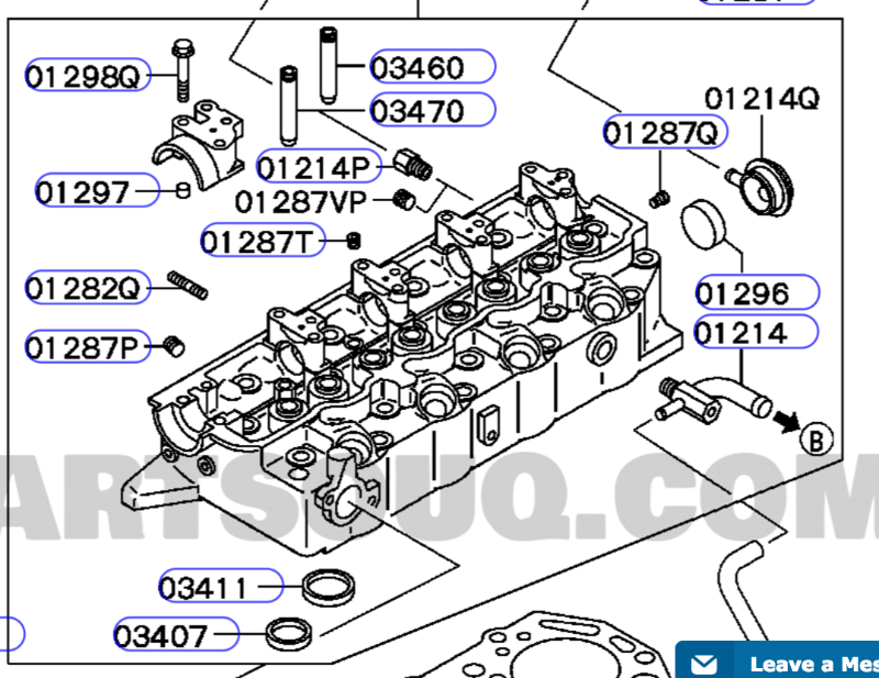

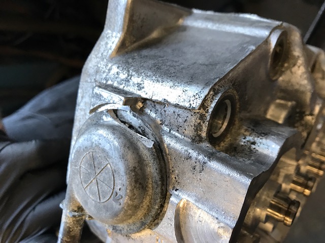

2. My new head is missing this piece (just a plug), which the mechanic broke, but I have an additional one on the engine in the van waiting to come out, I cannot order it, any tips on how to remove the old one, or what it might even be called?

- PartSouq screengrab, the piece is not able to be ordered...
- Screen Shot 2017-07-19 at 9.50.35 AM.png (250.22 KiB) Viewed 6451 times
- mechanic broke this piece, but I have another on my old engine.
- IMG_3236.JPG (98.66 KiB) Viewed 6451 times
- coolant pump?
- IMG_3235.JPG (98.79 KiB) Viewed 6451 times

In '93 they also added a water-cooled turbo. That's the water-cooled turbo cooling port. MD199222 (Amayama claim to have it, but they might be lying). Pre-'93 engines just had a freeze plug in place of this port (01296 in your diagram). Whether you replace it with a new inlet or a freeze plug depends on if you're using the new engine's turbo, or your old one.murdermitten wrote: 2. My new head is missing this piece (just a plug), which the mechanic broke, but I have an additional one on the engine in the van waiting to come out, I cannot order it, any tips on how to remove the old one, or what it might even be called?
No idea how to remove it without damage, I suspect it might be pressed or heat shrunk in. As a last resort you could fit a freeze plug in its place, and plumb the turbo into the heater outlet instead. it's just around the corner on the side of the head. (which would require brazing an extra stub onto the heater outlet).

Apparently I can get that head gasket water outlet piece, and installing one into the new head is simple, but to be honest I'd rather just go with the non water-cooled one just for simplicity...I've already given myself and my engine rebuilder enough challenges on this one!

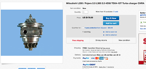

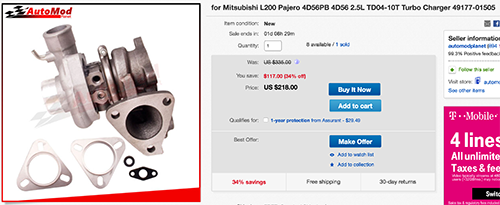

So, I found my turbo, very similar to your number, but ending in "05" rather than "00."
I can find the compressor wheel alone, or a full turbo + gaskets online. Wondering what you think the pros and cons would be between the two?
I'm inclined to just get the full turbo + gaskets, seems more foolproof rather than taking it for a rebuild, but if quality is the key issue I'd be willing to get it rebuilt over just slapping an inferior aftermarket part on there.

I don't really have much experience with non-genuine turbos. If it were me, I'd buy the complete unit because it's only slightly more expensive than the CHRA alone, and the quality's unlikely to be any different. And if it blows up, you still have your complete old turbo(s) to rebuild.

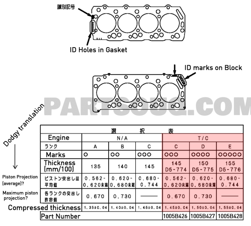

Hopefully this is one of the last questions related to the rebuild, the block was milled slightly to get a perfectly flat surface and the rebuilder and I noticed that there are different engine gaskets listed in the shop manual.
Thinking that this is related to piston protrusion, is there a specific measurement listed for this? If so would there be a gasket height that I could order to make this height the ideal measurement?

You're right, the gaskets were matched to each engine in the factory to keep the compression ratio within spec. Since your engine's block is now shorter, ideally you need a thicker gasket to compensate.
Look at what gasket the engine had originally (a row of marks on the back of the block, or on holes the front of the old gasket), figure out how much you've skimmed off the block, and then choose a thicker gasket to make up the difference. Gaskets come in 1.45, 1.50, and 1.55 mm thick. Don't panic if the original gasket was the thickest one already, a bit more compression won't hurt, it will just limit how much you can advance your injection timing.
