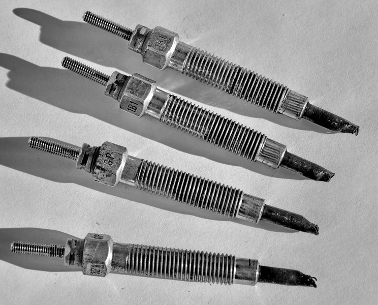

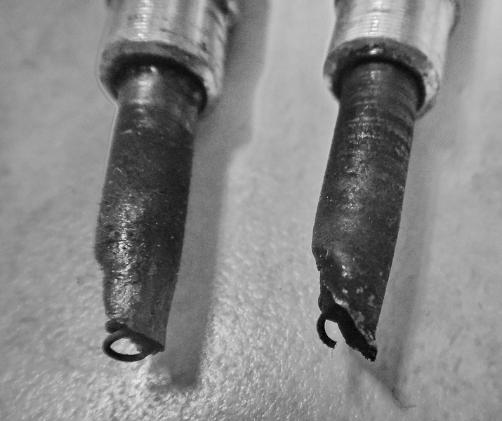

I have the same experience with Hyundai glow plugs as everyone else in this thread. I got them installed at CVI in October 2011 and as the mornings are getting cooler this fall I realized that it was time to replace them again. I went with NGK CY55's for the same price as Hyundai ones this time.
- DSC_7835_BW_resize.JPG (170.31 KiB) Viewed 12504 times
- DSC02434_BW_resize.JPG (125.46 KiB) Viewed 12504 times

Profister wrote:I have the same experience with Hyundai glow plugs as everyone else in this thread. I got them installed at CVI in October 2011 and as the mornings are getting cooler this fall I realized that it was time to replace them again. I went with NGK CY55's for the same price as crappy Hyundai ones this time.
OUCH!
I hope your heads are ok!

You have run your delica under abnormal glow plug relay system for a long time as power continuously went into glow plug.Profister wrote:I have the same experience with Hyundai glow plugs as everyone else in this thread. I got them installed at CVI in October 2011 and as the mornings are getting cooler this fall I realized that it was time to replace them again. I went with NGK CY55's for the same price as crappy Hyundai ones this time.
This one could happen to all kind of glow plugs when your glow plug relay has failed , but you tried to start the van in certain period without fixing.

I only replace with NGK plugs. Butch at CVI worked on my L400 last week and two of my plugs needed to be replaced (note: this cured rough starts, which makes sense). Butch specifically called me to confirm that I was okay paying extra for the NGK, which he recommended.

For all 4 to be burnt off like that, definitely something wrong with the system. Once in a while, a tip may burn off, but for all 4, I suspect your relay stuck on at one point, or the ecu is starting to malfunction causing them to stay on too long. If one tip was burnt off, and a couple others burnt out, I would say could be because of cheap plugs. All 4 burnt off= system problem. Or you had some wickedly hot burning fuel.

Relays don't get "stuck on." There needs to be power to a relay to move the armature and close the circuit. Without power the armature will spring back.

Relay's do stick on, when they get older, and the contacts get dirtier, when they are activated by the signal voltage, arcing can occur between the main contacts, essentially welding them together, keeping the voltage flowing. If your lucky, when it gets hot enough, the contacts will let go. If your not so lucky, the relay eventually gets so hot it catches fire. Either way, relays can and do stick on. If you are changing your glowplug relay, make sure you replace it with one that can handle the amperage draw of the glow plugs. Minimum of 60amps. 80amps would be better.

What? Where did you get this from? It looks like you are talking about someone else; I have never had any problems like that.Rising Sun Auto Import wrote:You have run your delica under abnormal glow plug relay system for a long time as power continuously went into glow plug.
Steven
The reason for my post was to confirm what the OP and other drivers were telling about Hyundai glow plugs floating around. That's it. Somehow I am the only one to blame on doing something wrong.

I checked my system by Installing a light so I know when they are on and when they turn off and everything seems good and never had any other glow plug tips burn off before..... I just had the one tip burn off but the others were not far off.
my suggestion would be to check them out to see any signs of wear if you have these plugs just to be safe

WOW! Interesting observation. You really hate me! I wonder why? My post has nothing to do with you personally or your business; I just don't care.1. Profister has been well known for anti RSI and Hyundai part for a long time in this forum.
These 2 threads were dedicated to sharing experience with using different kinds of glow plugs and I posted mine. Then you claimed that my vehicle had some kind of malfunction which caused the glow plugs failure. This is how it started. Your claim along with other accusations has no ground and leads to unnecessary tension on the forum.
I do not need to explain this but here you go. The only reason why I stopped by CVI on that October morning (I can provide the date if you want) because I was going out of town and I needed to replace the valve cover gasket. I was short on time, otherwise I would do it myself. When Butch was replacing the the valve cover I asked him to replace glow plugs; I experienced rough starts as the mornings were getting colder. I just thought it was a good time to replace glow plugs to have a safe trip. I did not ask for installing Hyundai parts. If you want to know why I got them you have to ask Butch. This is all irrelevant to the subject.
Now, as for a fellow diesel mechanic saying that all 4 pieces cannot go bad if the control system is in a good working condition. Does this mean that 4 glow plugs cannot be of poor quality or just inappropriate for this application? Sorry I don't understand this logic.
I am too old to play games like yours and make fake claims. I have learned my life lessons when you were a kid; you are still learning. I provide facts and share my experience which is always positive if you are willing to learn from it.2. Check your engine by opening the cylinder head for damages.
I do not believe your L400 is in top notch status as your engine has eaten up numerous debris since 2011.
If you claim no damage at all after inspection, this will be a strong evidence you has fabricated all claims here.
If this case is a fake , pls stop and get out of here.
Remember lots of delica owners here have Hyundai glow plugs installed ( over 300 ), and they are very stressed from your claim.
The glow plugs on the picture did not brake down at once; they were slowly burning over time. Don't you get it? What damage do you expect to see because of that?

Do you remember if you were using the same Hyundai part number on your vehicle? The pictures of those four tips all being severely and quite uniformly degraded looks to me like a systemic problem i.e. bad batch of plugs, incorrect voltage rating, excessive on-time, ...?
