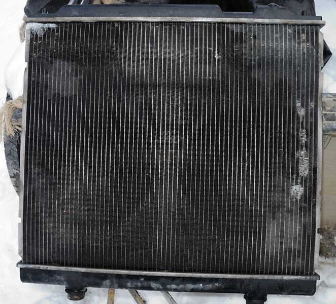

jfarsang wrote:L400 4M40 is a pressurized closed looped system (no rad cap)
Coolant in the closed loop system is designed to absorb engine heat and transfer it to the radiator so that through convection and thermodynamics heat transfer may occur.
If you pour in foreign material into the expansion bottle, it goes into the engine and can clog the thermostat. Please do not put anything into the cooling system except for water, coolant and additive (Red Line WaterWetter).
Your radiator doesn't look good. In hindsight, it's a shame the dealer didn't replace it. If you trace the leak to the radiator, your cheapest/best option is to order a new radiator, have it shipped to you and install it.
changing the rad is easy
2 rad hoses
2 small transmission coolant hoses (bottom - use pliers on the hose clamps)
1 return line to the expansion bottle (brittle. be careful with it)
you'll loose most of the coolant from the engine. buy 2 jugs of coolant and mix them 50/50 with water
I'm heading up to whistler this weekend. If you need me to grab a radiator from you, I can pick one up from Mardy and leave it in whistler for you to pick up at my sister's place in Cheakamus or get a courier to take it up to you.
If you need more help Claude, just let me know. Cheers

Update to the leak.
I got some help with one neighbor across the lake We raise the van a got it running for while. Remove the skid plate, crawl underneath checked all the hoses.. They seem to be fine . There was a drip off coolant coming from the bottom off the rad mainly on the passanger side. but we could not figure out exactly where the leak is. Due to a heavy snowstorm it was hard to keep everything dry (60cm of white stuff :( Had to snowplow the driveway twice)

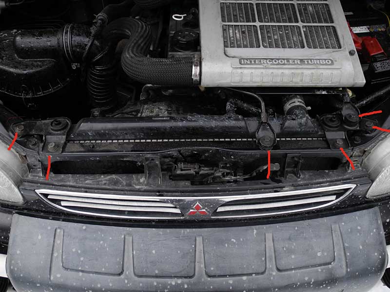

I want to make sure before I start to work on the van that is the bolts I have to take off beside the hoses in order to lift the radiator out.
Claude
Leo Tolstoy
Re: Loosing coolant
Yes
You have the transmission cooler lines at the bottom/back of the radiator as well. If you can find a pair of clean bolts to put into the rubber transmission hoses so the fluid doesn't leak out it will help.

also you need to remove the fan shroud....
Since you have drained the coolant I would replace all the hoses with new.....
Not a fan of these new aluminum and plastic radiators we get these days...
Good luck with it

Update:

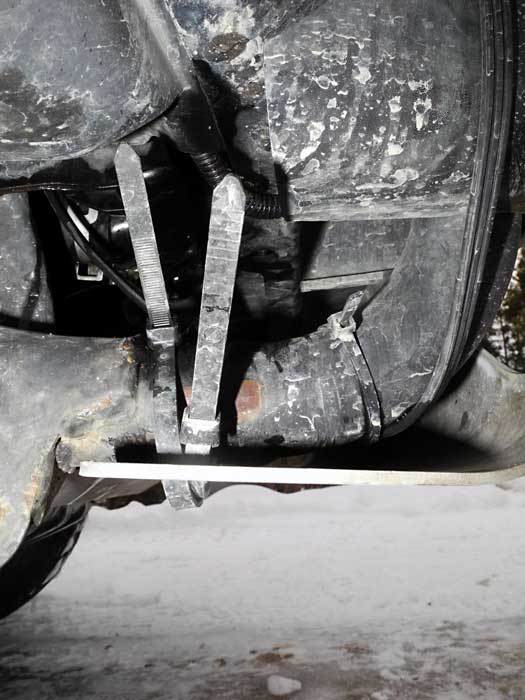

Just got the new radiator at the post office this afternoon and started working on removing the leaking one. As Rising Sun advertised to me the way they look after they vehicle before selling to their customer
"Here are lists we check/replace for our stock delicas.
1. Engine componenets
** valve adjustment, timing chain tension/loose adjustment, make sure no oil leaks( in case of L300, new timing belt/balancer belt/tensioners, 4 front oil seals replaced )
2. Transmission/4WD fuction
** If anything wrong, we replace sensor/switch, etc
3. steering/suspension/axle
** repack hub, and replace bearing if worn, all bushings/ball joints/CV boots/rack & pinion boot /links replaced if needed, wheel alignment, etc.
4. brake system
** flushing fluids, rotor machined or replaced, replace brake pads under 60% depth, all caliper checked
5. cooling system
** new radiator, new water pump, new thermostat, new hoses, new expansion bottle if needed.
** new temp guage/switch if needed
6. starting
** new battery if needed, new Hyundai glow plugs ( best in Canada ), check glow plug relay/wiring, alternator/starter checked, make sure initial idle good.
7. interior
** make sure no broken parts, all power groups are working
8. exterior
** We focus on importing clean/good shape cars, no worry.
9. all fluids replaced ( engine oil, coolant, transmission oil, transfer case oil, front/rear differential oil ), new air filter/new fuel filter,all new V-belt, a/c checked and refilled.
10. compliance
** new tires Yokohama Geolandar A/T-S ( upgrade available with extra cost ), new e-coded headlight, DRL, marker/reflectors
11. canadian version CD player/stereo
** it is not included in our listing price.
12. block heater, trailer hitch
** installation extra
They must have done no much of those checks on my Delica and on top they went cheap on the skid plate by using cable ties to hold it on the driver side. Good work Guys!!!.
Well, I install new rad and finely we can use our Delica again. :-D
