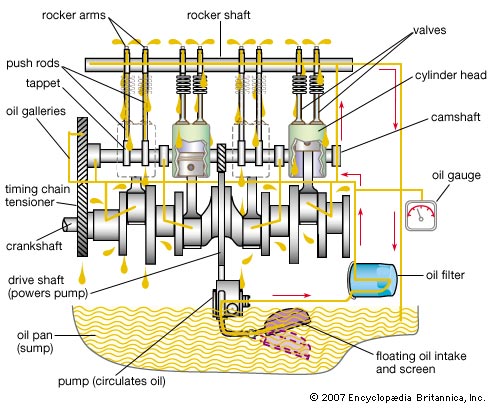

Correct. I hope this simple picture helps but I assume that everybody has this basic knowledge.

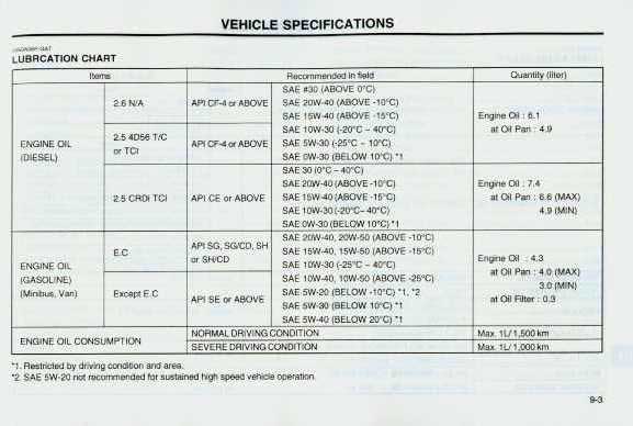

700ml of oil for 3500km is perfectly normal.
Oil consumption can be as high as 1L/1000km max. under severe driving condition and 1L/1500km max. under normal driving condition, following the specification
from the lubrication chart coming from Mitsubishi shop manual.And 5w-30 is not the best oil for 4d56.
Here is a copy of that.
- 4d56xa8.jpg (29.4 KiB) Viewed 10290 times
