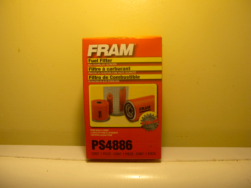

$54 at Lordco

mycale2 wrote:NEVERMIND, I called Lordco (Burnside, Victoria) and much to my surprise they have the part #'s and parts on hand for many JDM vehicles. I guess I shoulda just called them first!
mycale2 wrote:$54 at Lordco

wow, that is pricy, especially for fram. you should be able to pick up a donaldson from napa or a baldwin for half that price for a better filter.

I picked up a Fram PH3976A filter for my bypass unit (will not fit a Delica without modification) and it was $13 from Lordco. Considering the one I have is larger and is constructed in the same way I find it silly that your would be $54. I suppose it all comes down to supply and demand rather than cost to create.
