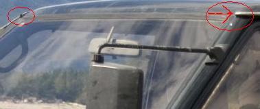

I went for a long drive in the monsoon today and my footwells are bone dry! hooray, and I didn't even have to try fixing that panel seam business.
A while back I tried cleaning up the door seals which didn't help, and finally got around on the weekend to re-sealing the ends of the rain gutters in the front. As Christine pointed out at the last meet there are supposed to be plastic caps on the ends of the rain gutters, which I did not have. A look at the welds/seals up there revealed a bit of cracking so I cleaned the area up nice with alcohol and applied a decent amount of "goop" automotive sealant, some very serious looking epoxy type stuff. All in this only took about 10 minutes and seems to have done the trick :-)
Take a climb up on your van, up the brush bars or better yet just stand next to the front seats and check the condition of the front end of your gutters. Mine were missing the caps and just had old bits of glue up there and also when I looked really closely inside the gutters I found the cracks, cleaned and covered that all up with sealant. Dry carpets 8-)

nice work I think that is my prob as well thanks to your pic I 'm going to look right now
cheers

I can take a proper closeup pic that shows the cracking and whatnot (the sealant I used is transparent) if anyone needs clarification or anything, that one is just a crop of another picture I had so is crap quality :?

Don't want to complicate this simple fix, but did you just put a thin coating down over the cracks or glob some near the open ends of the gutters? What's the thinking here; that the water seeped through the cracked gutters and entered the van via the door seal?
--todd
coaxial
Re: my feet are dry! found the leak
Post by coaxial »
Somewhere in between I think. I squirted a decent size glob of sealant up there, about the size of a grape, and spread it out to cover the end of the gutter where there should be a plastic cap glued on, and also spread it out over the cracks.
I have no idea by my guess is it game in through the crack in the weld/seal there and ran down the inside of the body panel/corner beam and stopped when it got to the floor.
For the record I only had a leak on the left passenger foot area but sealed both sides just to be sure. The difference was instant so it definitely was the gutter end/crack and not a windshield or body panel seam in my case. Like I said it took a total of maybe 10 minutes to fix :-)
