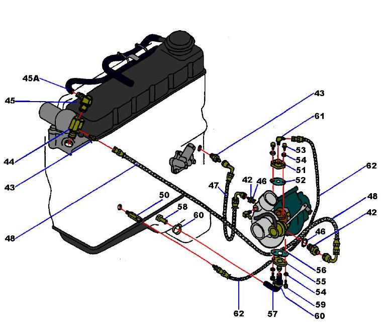

You can always tee off from the heater line like many diesels with aftermarket water-cooled turbo's.
Example. On the Nissan TD42, to turbo it with a water-cooled turbo, a Tee is fitted (#44) in the picture for the inlet and the outlet is piped down to an existing coolant plug (#50) on the block.
You can route a fresh water-cooled turbo in this fashion. Someone on the delica.ru site did it this way.
Which ever way you end up doing the routing, make sure the inlet/outlet on the turbo itself is bang on 90 degrees facing top to bottom. Oil or water, this is the best flow for the fluid.

Would be beneficial if you can look at a post-93 4D56T with the water cooled turbo and see where the return line is routed to. On your block, there should be a plug there.
For the feed line, tap into the feed heater line just like in the image above.
