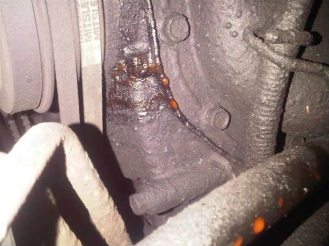

Okay, this is for pajero, but same engine.. So I had a minor water leak from some autometer fittings for a water temp guage. I fixed that, all seemed okay that was it, then overnight she pukes half a liter of coolant! Radiator is still full, but expansion bottle pretty much empty. It seems fine, hoses are fine, hose to the alternator/water pump (?) seemed fine, lower rad hose fine. Also after shutting down the motor from hot, I can hear some bubbling in the system, not sure from where can't tell, so air is getting in there.. Also it drips quicker when I squeeze the top or bottom rad hose. From the top of the block all looks dry and cleanish. I included a photo of where the drip is running to under the truck. Maybe someone has seen the same drip before?
The drip is following the left side of the block down to the lower pulley as you can see. (this is sticking the head under the rad from front of truck) Where could this come from? I removed the intercooler and can't seem to find where it originates without taking a bunch of crap (everything) out.

I think that the leak is probably coming from or around the water pump. When was it last changed? Also if you want to check for oil contamination (visually only) drain the used motor oil into a glass container and leave it to sit and inspect it to see if you get a layer of water. Typically, enough water to do any damage would be pretty easy to spot (foamy white oil if you look under the oil fill cap with a flash light while shes running)

x3 looks like a rusty water pump

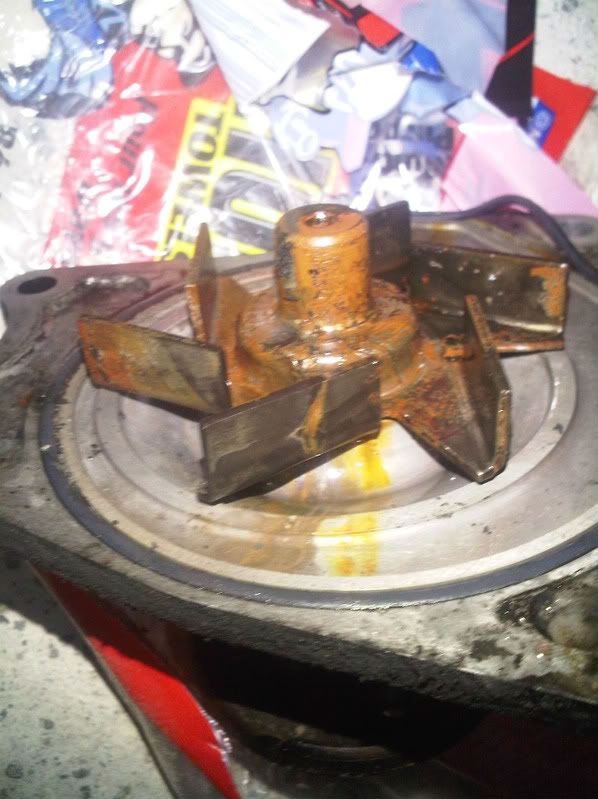

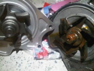

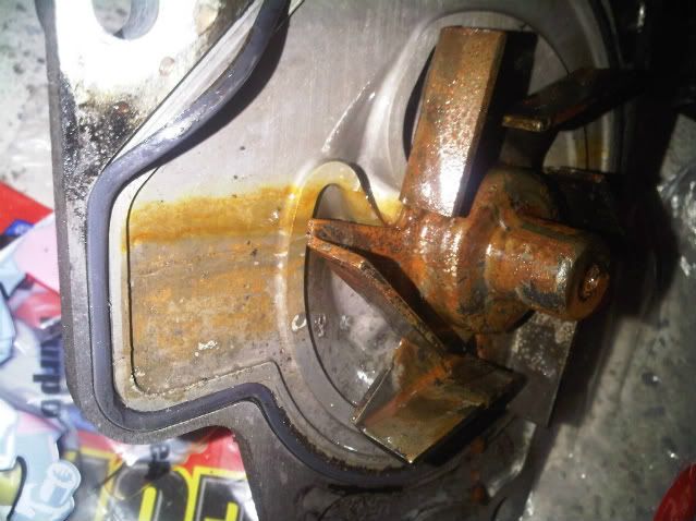

Thanks for all the help guys. I changed the pump last Monday and other than a couple scraped knuckles all went well. Heres what I found. A 'new' water pump that has done 55000kms apparently looks like this..
I'm assuming its the original pump? Surely it can't rust out and have a water line like that on a newer 55000km pump?

Rust can build up in 1/2 that time if there was corrosion/calcium buildup in the cooling system prior.
Did you get a good flush done?
