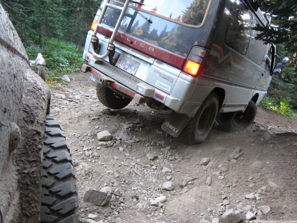

Love the individual touch on those ones. What was the total damage all said and done?
Your inching down causes your van to want to endo :) I Wish I had captured some of the better examples from that day, there were a few good ones riding the brakes.The way I off-road is that if something is steep like a ditch, I will inch into it, if I hear a scraping sound I stop

Very true, the inching was to save the radiator guards of which I did sheer off one (it's back in place now though). There was absoloutely no damage to the skid plate thankfully.
I suppose whipsaw was more like inch-inch-inch-clench and let go of the brakes.

too true. Very entertaining
