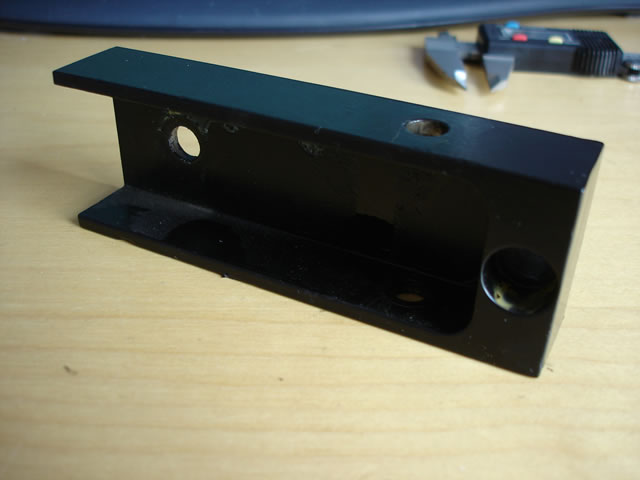

Looking for door extension hinges or blue prints to make can any one help me out

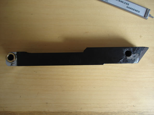

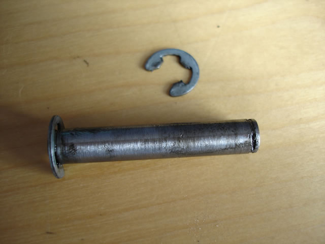

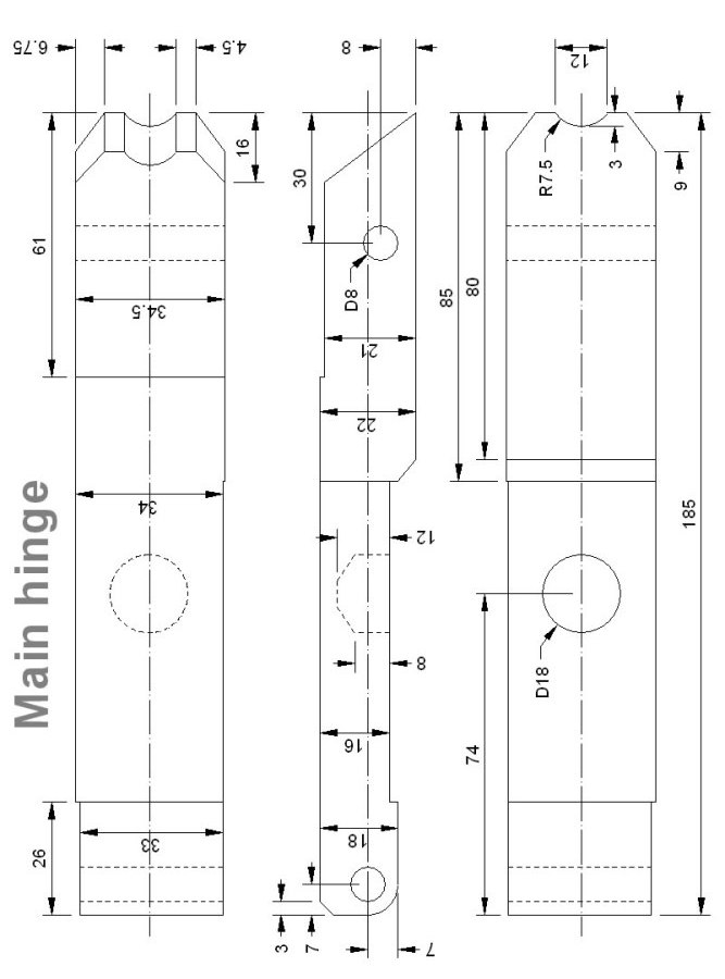

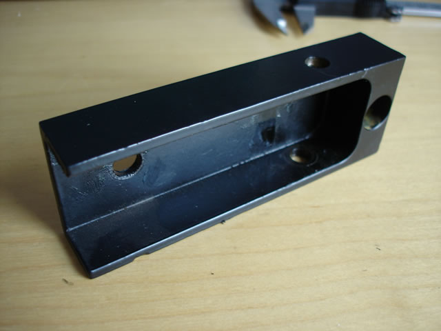

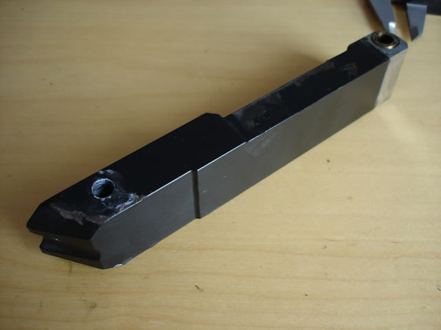

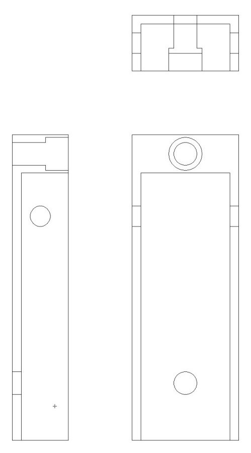

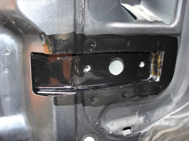

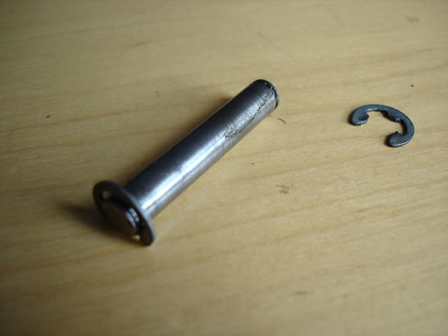

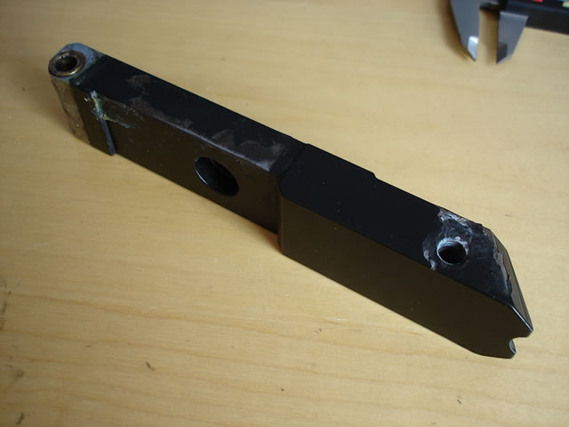

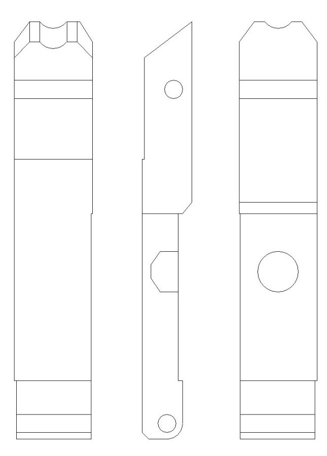

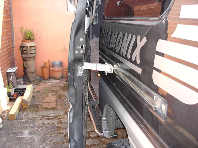

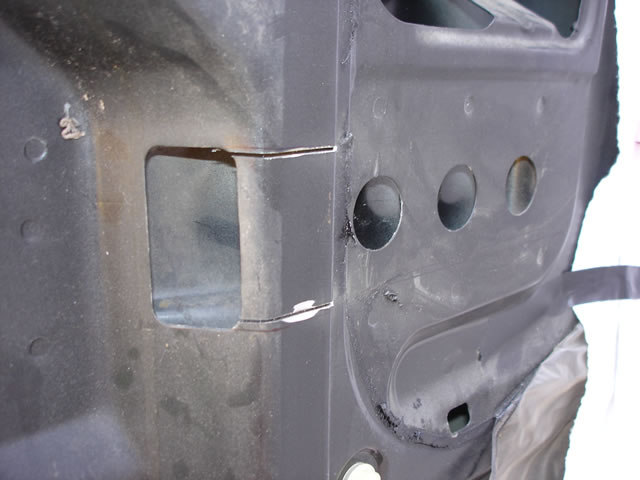

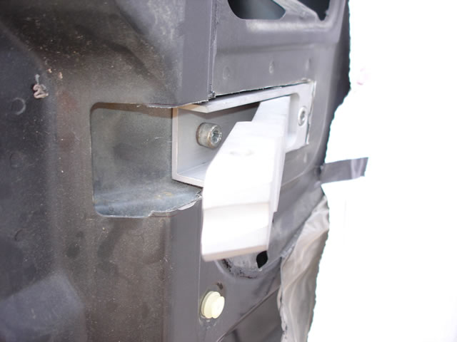

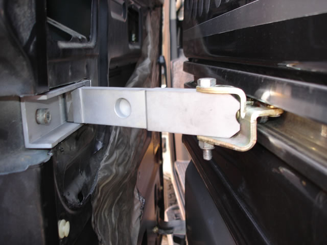

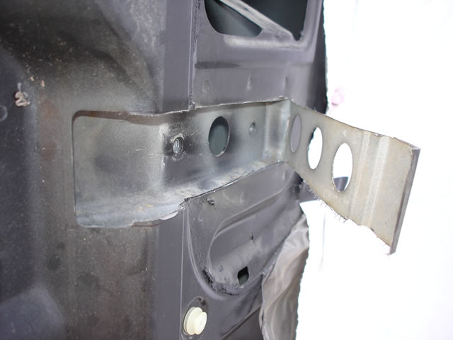

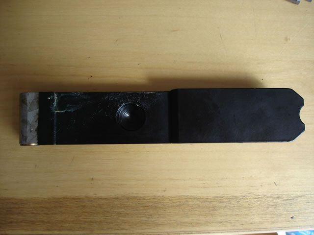

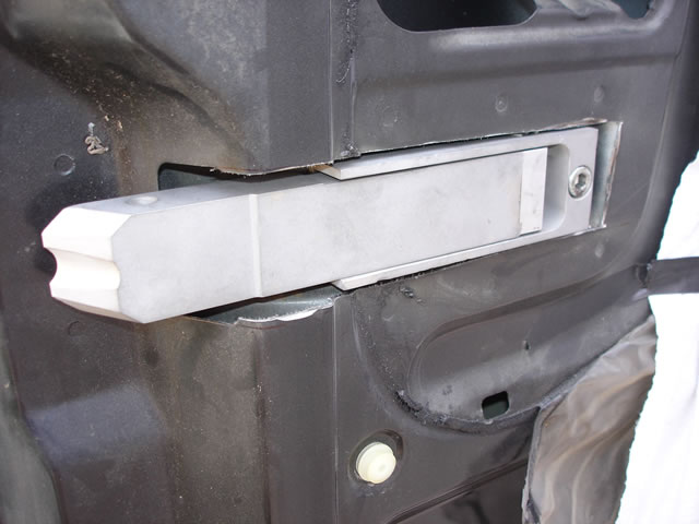

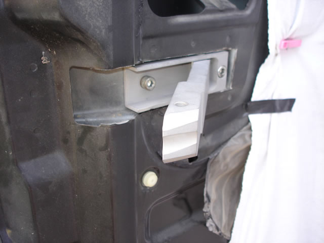

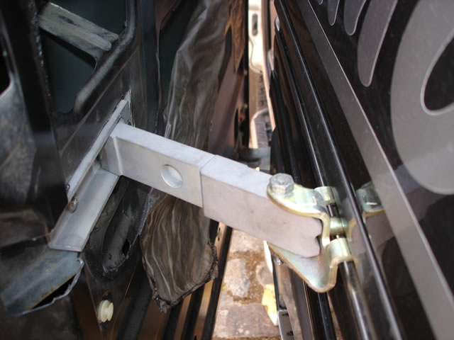

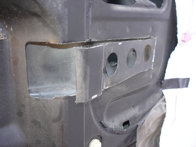

Re: Wanted slide door extension hinges

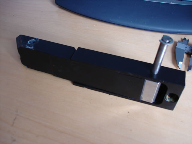

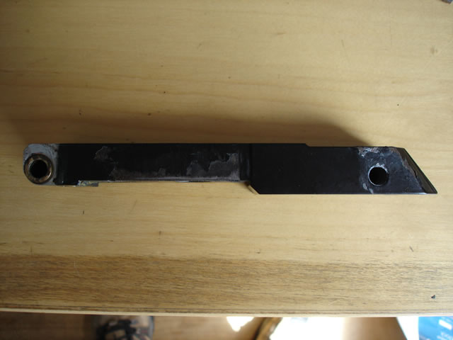

Here you go. This is everything I have from Bruce and Noel.
Hinge 001.jpg (47.41 KiB) Viewed 6519 times
Hinge 002.jpg (58.02 KiB) Viewed 6519 times
Hinge 003.jpg (40.51 KiB) Viewed 6519 times
Hinge 004.jpg (42.96 KiB) Viewed 6519 times
Hinge 005.jpg (40.66 KiB) Viewed 6519 times
Hinge 006.jpg (37.36 KiB) Viewed 6519 times
Hinge 007.jpg (32.25 KiB) Viewed 6519 times

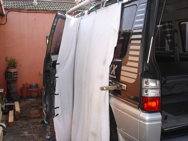

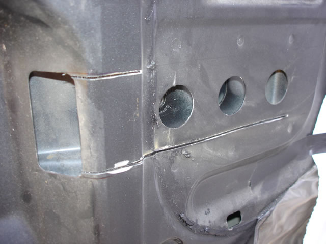

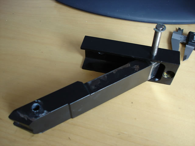

cont..
Hinge 008.jpg (32.53 KiB) Viewed 6518 times
Hinge 009.jpg (41.99 KiB) Viewed 6518 times
Hinge 010.jpg (41.76 KiB) Viewed 6518 times
Hinge 011.jpg (49.04 KiB) Viewed 6518 times
Hinge 012.jpg (74.09 KiB) Viewed 6518 times
Hinge 013.jpg (51.41 KiB) Viewed 6518 times
Hinge 014.jpg (54.18 KiB) Viewed 6518 times

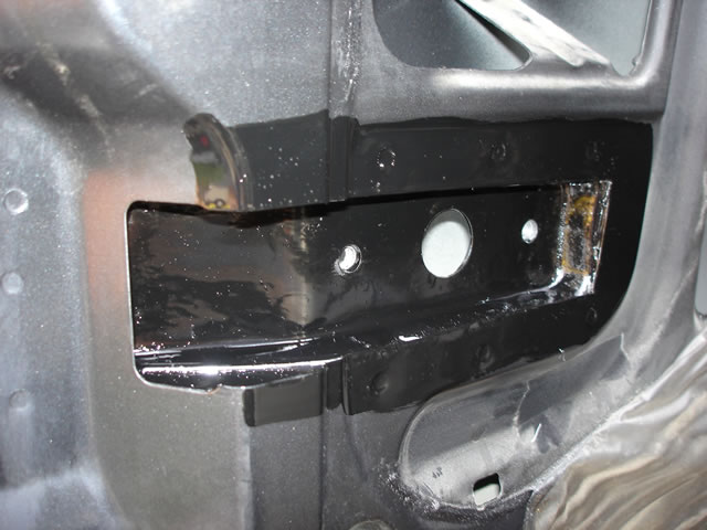

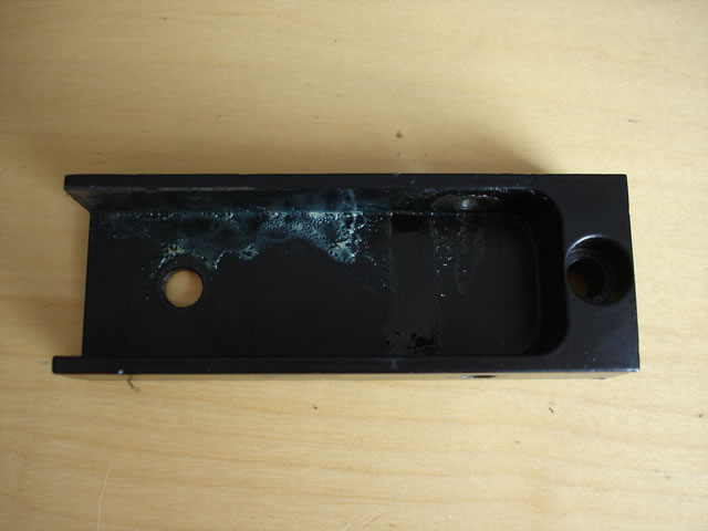

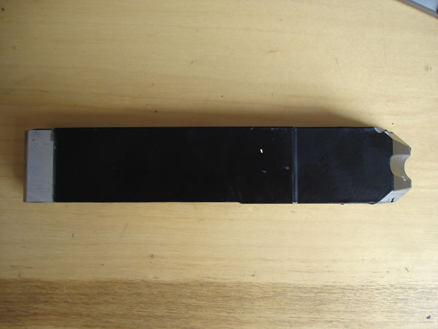

cont..
Hinge a001.jpg (32.37 KiB) Viewed 6518 times
Hinge a002.jpg (28.6 KiB) Viewed 6518 times
Hinge a003.jpg (32.19 KiB) Viewed 6518 times
Hinge a004.jpg (29.39 KiB) Viewed 6518 times
Hinge a005.jpg (28.38 KiB) Viewed 6518 times
Hinge a006.jpg (26.42 KiB) Viewed 6518 times
Hinge a007.jpg (27.66 KiB) Viewed 6518 times

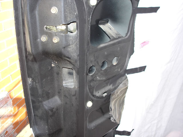

cont..
Hinge a008.jpg (32.99 KiB) Viewed 6518 times
Hinge a009.jpg (27.92 KiB) Viewed 6518 times
Hinge a010.jpg (26.78 KiB) Viewed 6518 times
Hinge a011.jpg (29.24 KiB) Viewed 6518 times
Hinge a012.jpg (29.17 KiB) Viewed 6518 times
Hinge a013.jpg (26.36 KiB) Viewed 6518 times

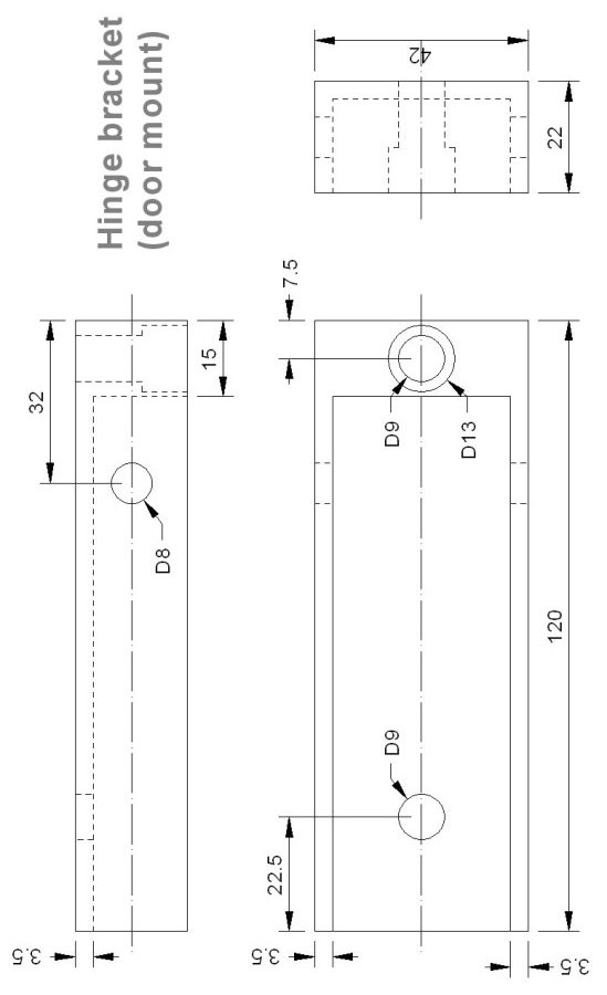

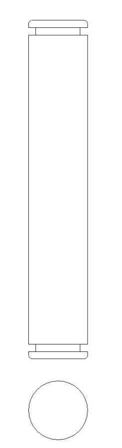

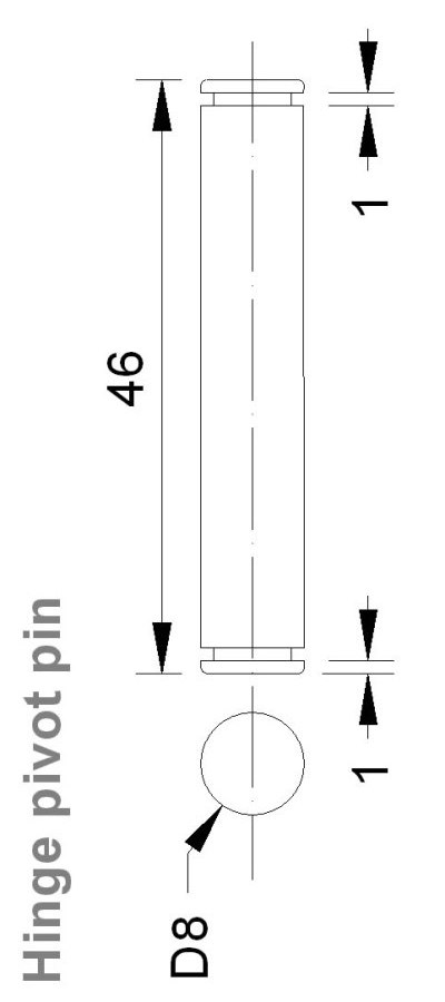

cont..
Hinge Dim1.jpg (46.75 KiB) Viewed 6512 times
Hinge Dim2.jpg (68.38 KiB) Viewed 6512 times
Hinge Dim3.jpg (25.05 KiB) Viewed 6512 times
Hinge Pt1.jpg (26.9 KiB) Viewed 6512 times
Hinge Pt2.jpg (33.32 KiB) Viewed 6512 times
Hinge Pt3.jpg (12 KiB) Viewed 6512 times
Shogopaintball1
Posts: 10
Joined: Sat Feb 11, 2012 2:13 pm
Vehicle: L300
Location: Edmonton
Post by Shogopaintball1 »
Shogopaintball1
Posts: 10
Vehicle: L300
Location: Edmonton
Thanks I will start milling them up tomorrow
quite a few people ask for them often. if you are on the lathe/mill and make up more than one set, there's demand out there
Shogopaintball1
Posts: 10
Vehicle: L300
Location: Edmonton
Yes I an an mill up a few more if I can get the specks for the spacer I'll Make them also.
Also might make spacer for the body lift too.
So if any one wants them just let me know and I'll price them out. Thank you
