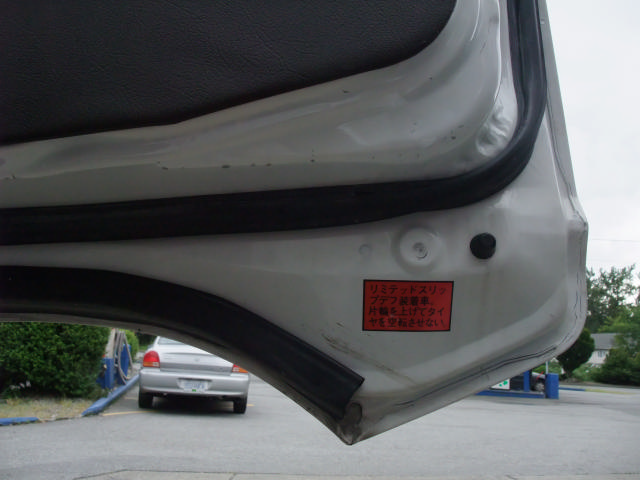

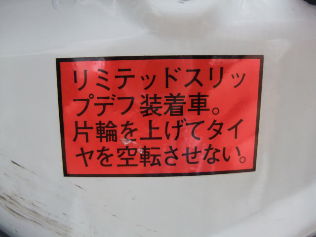

- Rising Sun Auto Import
- Posts: 1366
Re: Differential Oil / Transfer Case / Grease
You can tell LSD from the sticker on the driver side door as well.
Steven
Steven
- L300_LSD mark.JPG (102.83 KiB) Viewed 9865 times
- L300_LSD.JPG (86.43 KiB) Viewed 9865 times
so the sticker means what??
- username
- Posts: 100
- Joined: Thu Dec 28, 2006 12:11 am
- Vehicle: 1991 super exceed
- Location: clearwater
sticker=lsd no sticker=no lsd??
Exactly, unless it's fallen off or someone is trying to up-sell their van.username wrote:sticker=lsd no sticker=no lsd??
Do NOT rely on that sticker. If the sticker is present but the vehicle has an open diff and you put in friction additive, you can have premature wear on the crown/pinion/gears. If the sticker is missing but the vehicle has a limited slip differential, you run the risk of not adding/using the correct LSD friction modifier and hurting the gears.Rising Sun Auto Import wrote:You can tell LSD from the sticker on the driver side door as well.
Steven
Like Nick said, you'll see a number of vehicles coming from Japan without the sticker (fell off or someone took it off) or with the LSD sticker on the door jam but no real LSD. Upselling comes to mind.
Surefire way to know if you have an LSD or open differential
sigurross wrote:Jack the back of your van up and spin one of the wheels. The contrary wheel will spin in the same direction if it is lsd and opposite direction if conventional.
- Posts: 1366
Telling just common sense.jfarsang wrote:Do NOT rely on that sticker. If the sticker is present but the vehicle has an open diff and you put in friction additive, you can have premature wear on the crown/pinion/gears. If the sticker is missing but the vehicle has a limited slip differential, you run the risk of not adding/using the correct LSD friction modifier and hurting the gears.Rising Sun Auto Import wrote:You can tell LSD from the sticker on the driver side door as well.
Steven
Surefire way to know if you have an LSD or open differentialsigurross wrote:Jack the back of your van up and spin one of the wheels. The contrary wheel will spin in the same direction if it is lsd and opposite direction if conventional.
Steven
