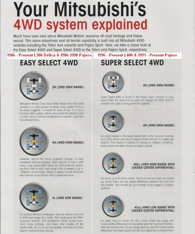

L300 = part time 4wd
When in 4wd mode (high or low), the front and rear differentials are connected via driveshafts which are connected to a center mounted transfer case. This transfercase (or some people call them center differentials) locks the front/rear driveshaft to create true 4wd mode.
If driven on a non-slippery surface while turning, the driveline/transfercase/driveshafts, etc.. will bind possibly causing severe damage to the driveline components.
L400 = selectable part time 4wd AND full time 4wd (all wheel drive)
All of the above (L300) applies when the 4wd selector is in 4HLc or 4Llc modes on the L400 which is true part time 4wd mode.
The L400 has an additional in-line viscous coupler inside the transfer case (center differential) which acts as a torque bias between the front and the rear driveshafts/axles. This mode (4H on L400) is called full time 4 wheel drive or all wheel drive.
This viscous coupler is a round donut looking contraption with silicone fluid and plates that, when working together, sense the torsion between the front and rear driveshafts and compensates so that binding/damage does not happen.
The full time 4wd or all wheel drive mode on the L400 is not the best, nor is it up there with the best (Subaru LSD/awd, Audi quattro) but it is good and works very well with the wheelbase and weight of the L400 in icy/snow/rain/slick conditions where 4wd (part time) is not necessary/will not work but added traction helps.
There are no factory front/rear differential lockers in the L300 and L400 delica's. Either open differential or limited slip differentials are available in the rear and all front differentials are open.
Aftermarket lockers with modifications are available.

L300, L400 and Pajero visual representation
source: http://pajerosport.motionforum.net/t7-s ... select-4wd
- scan0010[1].jpg (85.1 KiB) Viewed 3953 times
